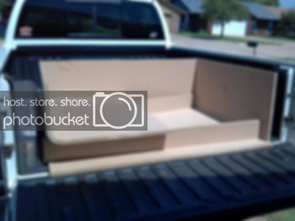

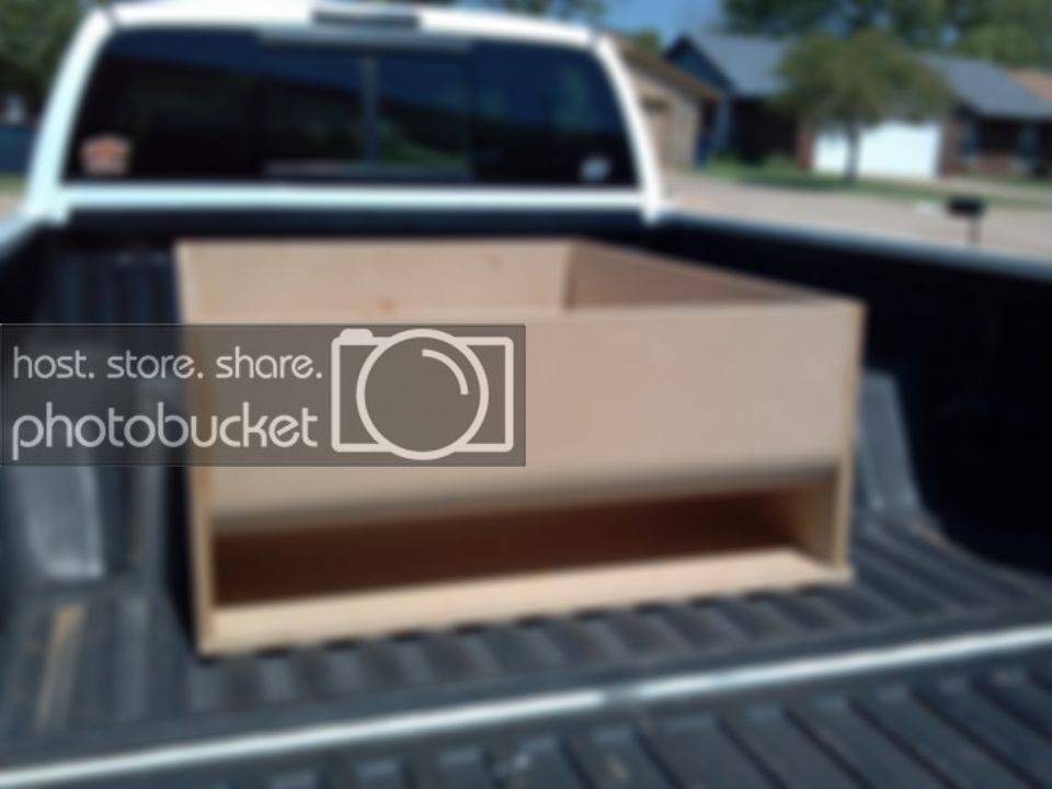

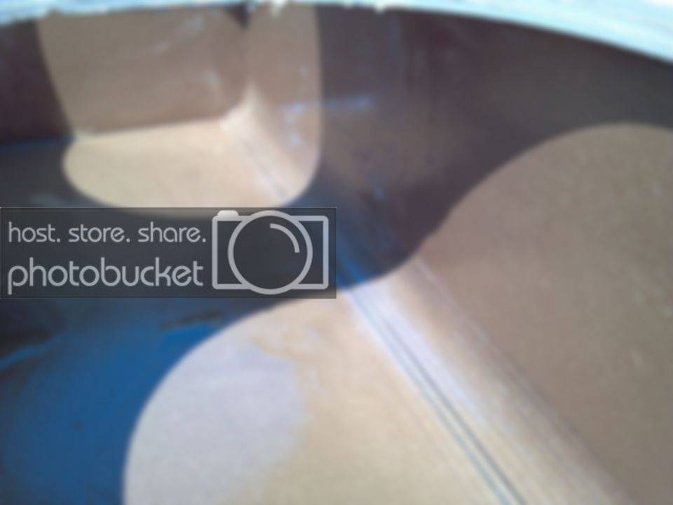

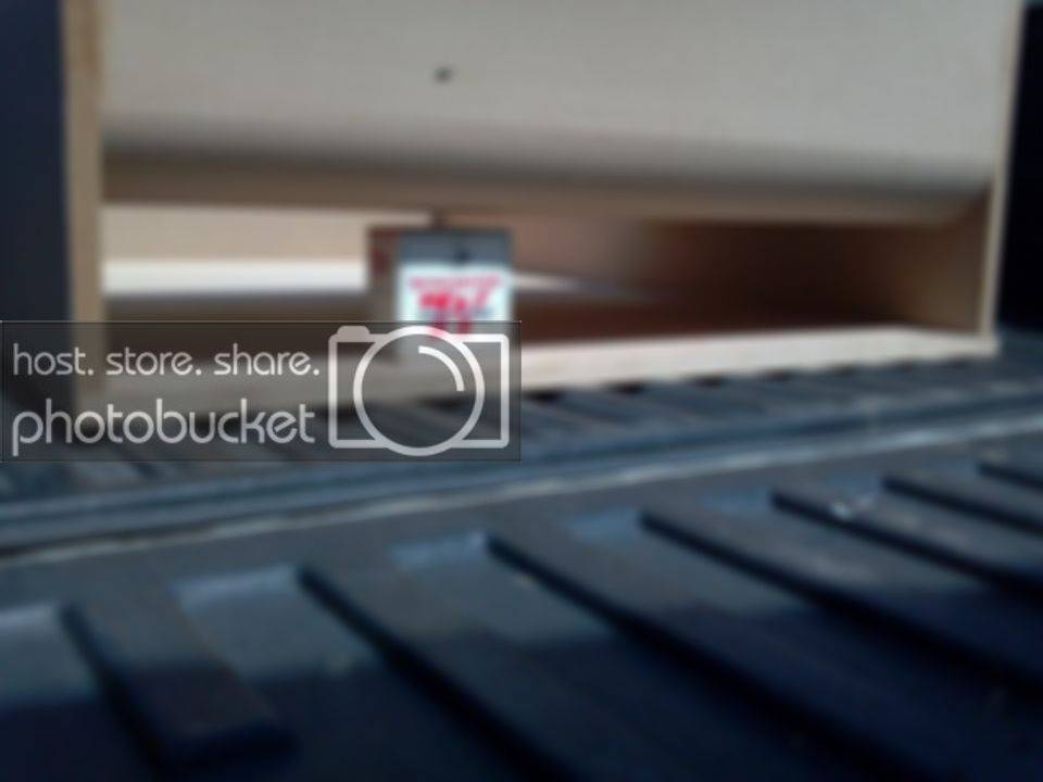

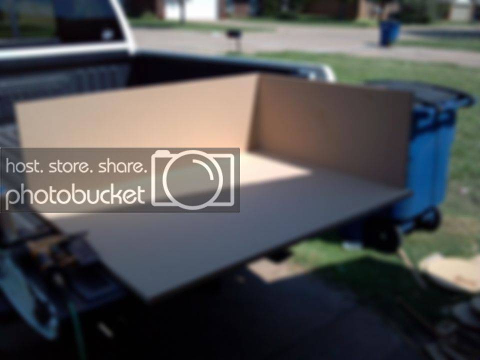

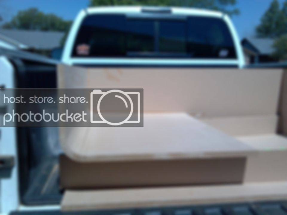

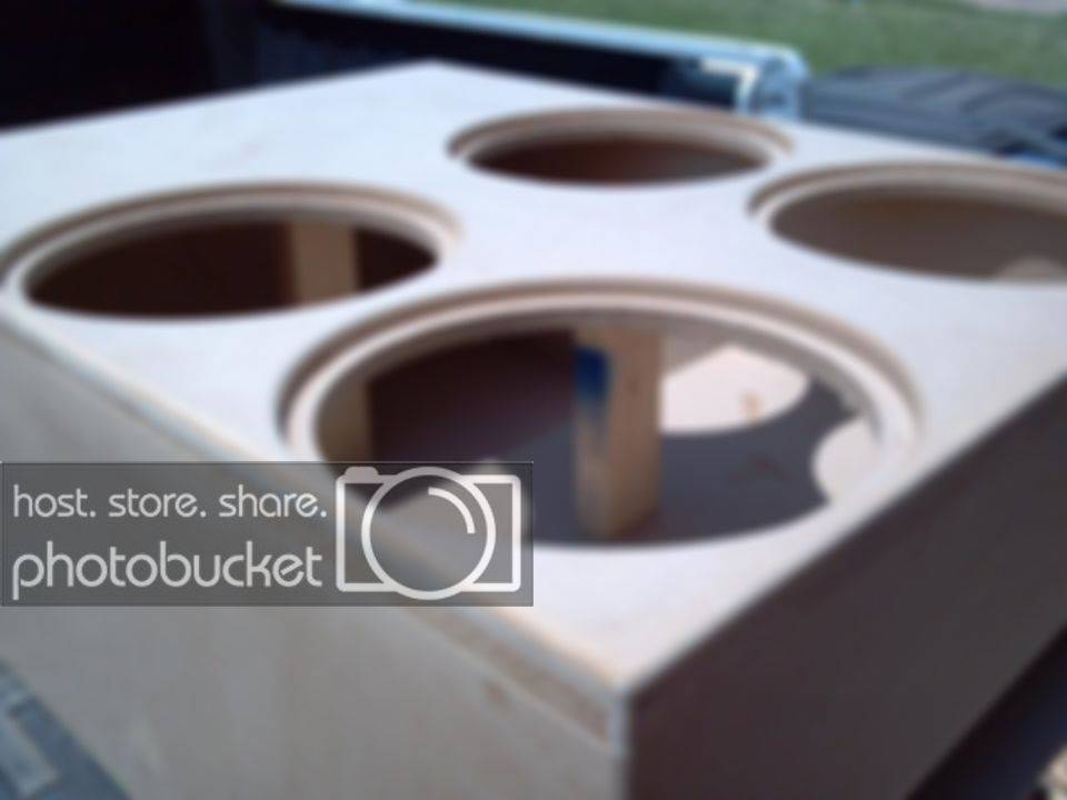

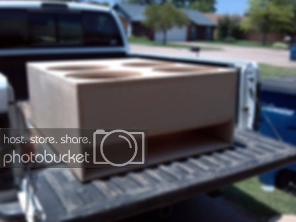

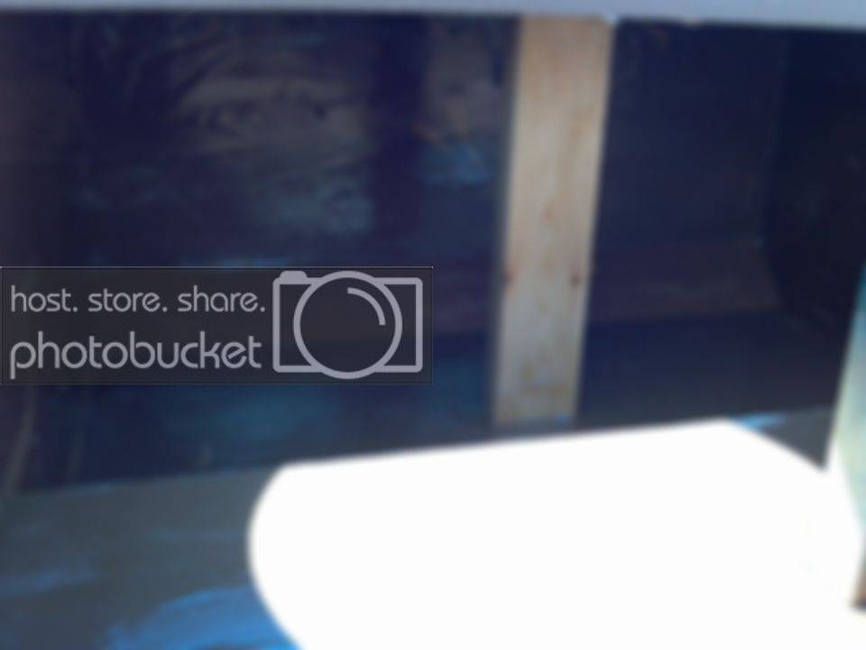

Build this box in a couple hours this morning for a local customer from Tulsa, OK. Box is 12.5 cubes with a big kerfed port that's 162 sq. in. tuned to 32 hz for 4 Skar Audio VVX 15's running off an AQ3500 at 0.5 ohms. All of this will be going in a 4 door Chevy Blazer. Guy won't have the last 2 subs for another week or so, so it will be a while before we get numbers/videos. Box is fully resined on the inside with 2x4 bracing. Round overs on all corners, with flush mounts for the subs. Anyway, here's the pics.
Questions? Comments?
