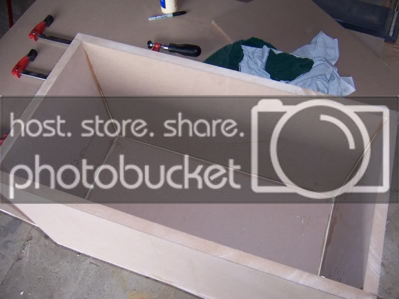

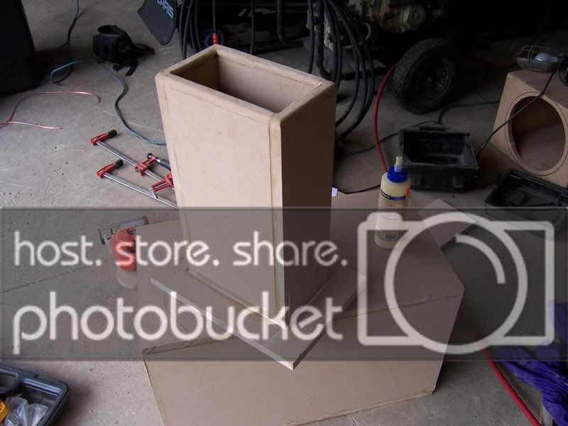

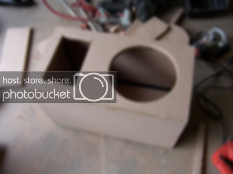

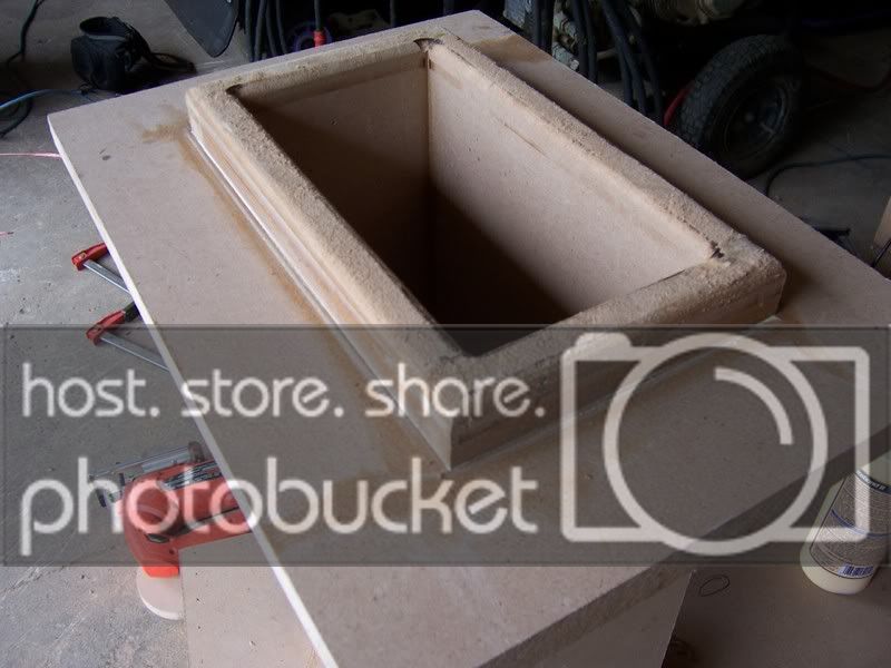

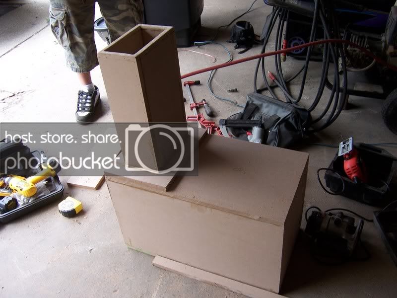

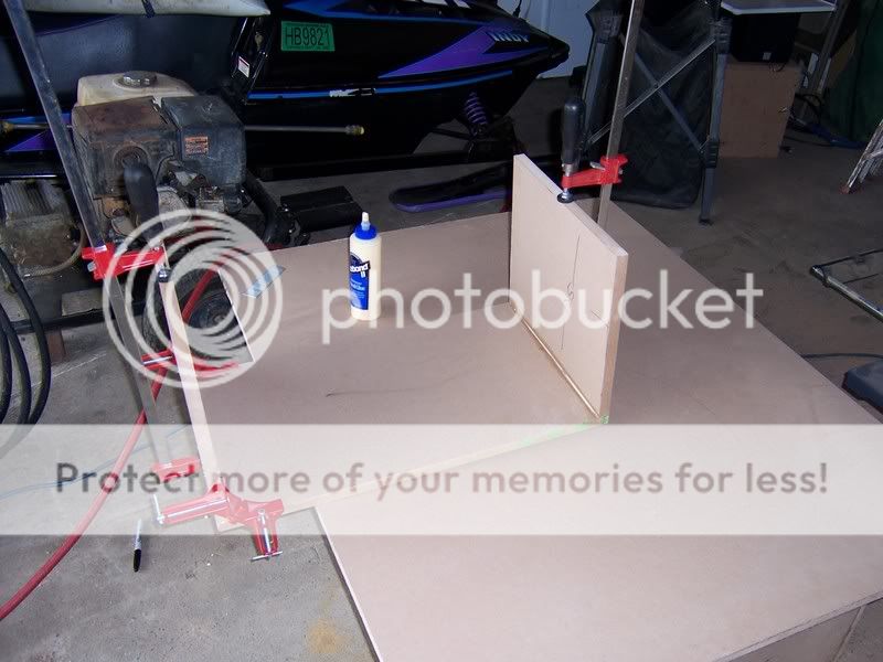

Well I woke up today and decided to design up a box for a 12" Type R I had sittin around for a while. Decided to do an external port so I can swap it for a different one to change the tuning if I want. This one is tuned to 37Hz. Hopefully I can sell or trade my 12" RL-Ps so I can get an 18, hopefully an SX or Q and do a semi-wall in my car. Well on to the pics.......
Real good, it can almost get as loud as my RL-P's, and I was definately suprised with the sq out of it. It should hold me over for a little while, atleast until I can get an 18.
Its 14x26x16 with a 4x8 port that is 19 inches long.
