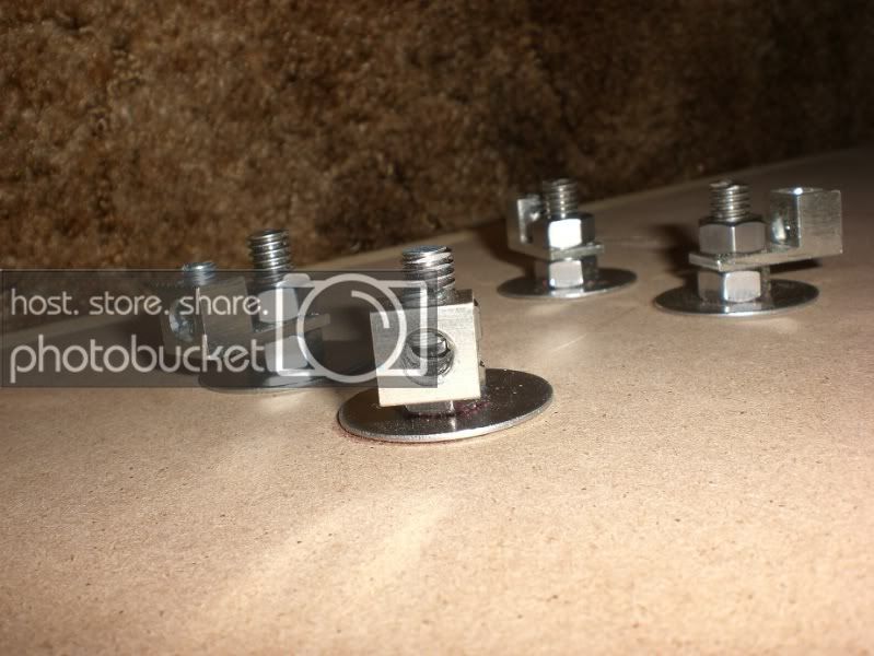

I would only use ring terminals on the inside of the box. On the outside use these:
I found some at my local Menards in the electrical section, they will make your life a lot easier.
