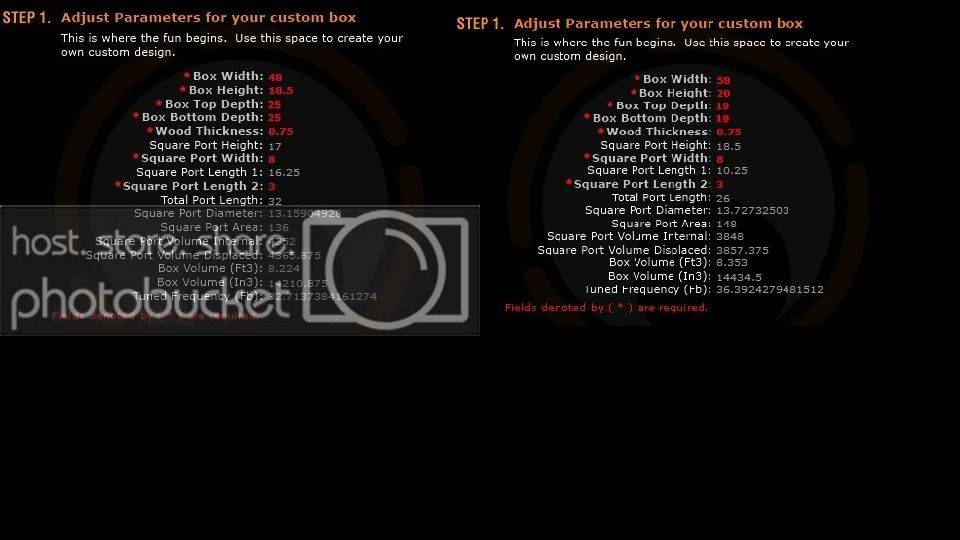

Box assistance? Made a couple designs, not a clue if they are right.

I really wanted to try to design my own box. However anything past plugging in dimensions is completely guesswork to me. The subs are the older re sx15s, being pushed with a crescendo 3k @ 2ohms. Going into the back of a dodge ram quadcab with the rear seats removed. Both designs are meant for subs forward pass side, port up drivers side. Think this might move some hair?
//content.invisioncic.com/y282845/emoticons/confused.gif.e820e0216602db4765798ac39d28caa9.gif
Any feedback, recommendations, is greatly appreciated. I really want to make one of these two designs work. I am able to pretty much change the length up to 60, the depth to 20, and height to 24.
One is a long slender box which the batteries will be underneath, and the amp rack on the front floor.
One is shorter, with a battery rack and amps being mounted next to the box.

Re is off by a bit. But not much. Many will say it's way off, but if you do the math to check it. You find it's pretty close. What is your goal? Kinda a big diff from 32-36. Also 8 cubes is pretty big for 1 15. More like for 1 18
What is your goal? Kinda a big diff from 32-36. Also 8 cubes is pretty big for 1 15...
It is for pair of 15s.
Still no direct answers to my question here. I was hoping for someone who has some knowledge of these subs, and knew what they sound good in. Please chime if you do!
