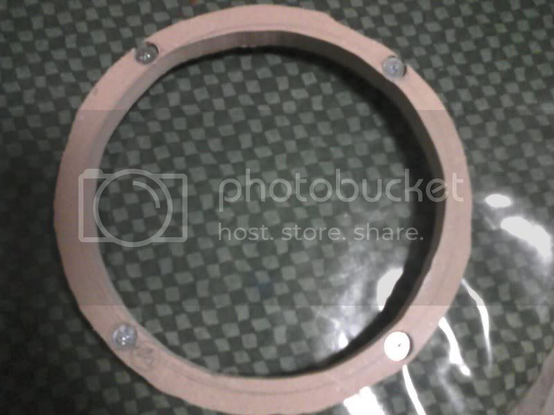

like i said i can get crazyer but if you aint going to make them apper then whats the poing in making them so sofisticated. i made these for a member here for the same woofer
There is an angled spacer between the door skin and the speakers. Go on eBay and get speaker adapters that will allow you to mount the aftermarket speakers to that spacer. They're like $7. Using a flat baffle in the Neon will eliminate almost all the available mounting depth in the door because there is not a lot of clearance between the door skin and the window when it's rolled down. Fitting 6 3/4 is simple. They're notionally the same size as 6.5s anyway.
