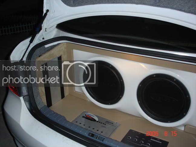

so i could get a smooth finish like this one

boxes with that exact shape are usually done without "fiberglassing" anyways. They put a flush ring on the outside of the box and use filler or kittyhair to get the shape, sand prime, and paint.
