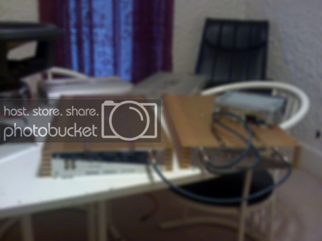

Here is a picture of 2 of my strapable amps.
The master amp is on the right, slave amp is on the left. You will see the Master amp have a headunit on top of it. Of coarse the rca cords are a bit shorter then what your using, but you should get the idea.
