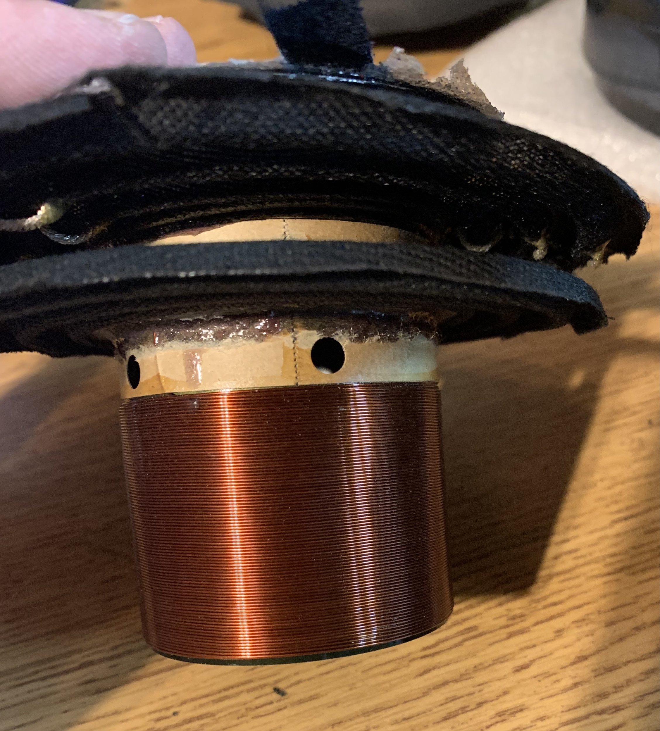

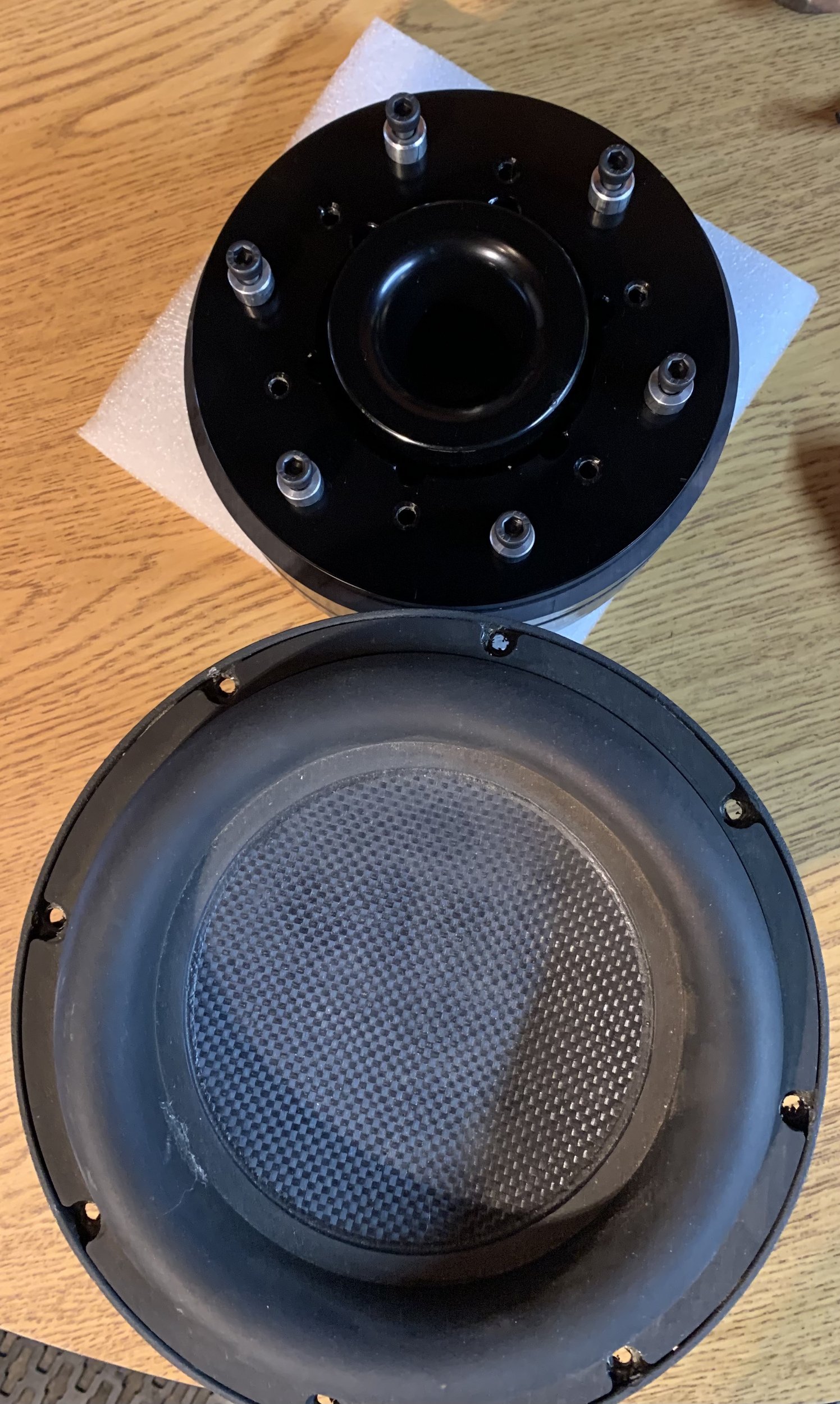

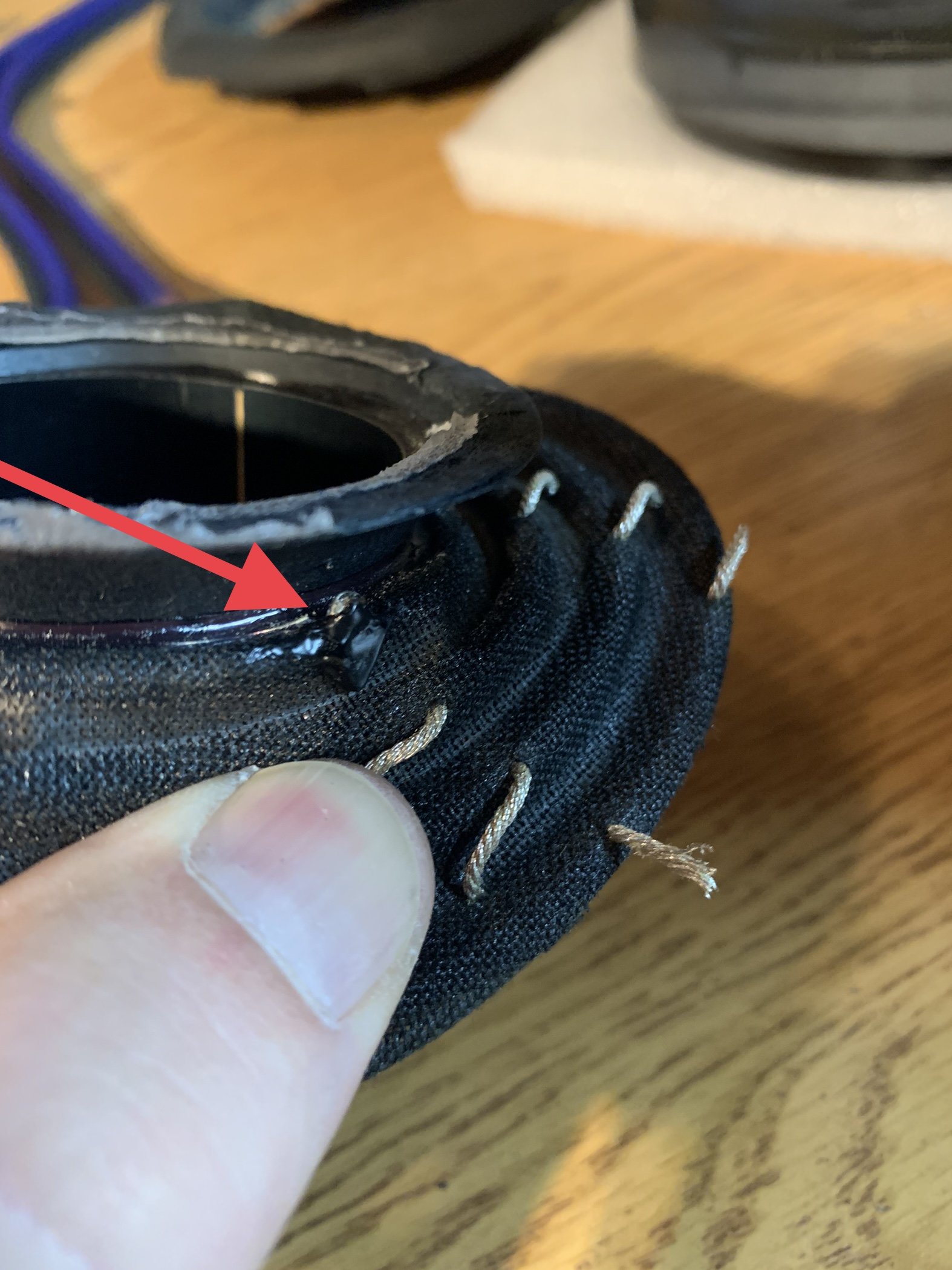

Blew my little Dayton ultimax 8 awhile back and sent it out to someone who can do something useful with it. I’m no subwoofer rebuilder. He said the build quality isn’t very good, and the glue is cheap. Coil is perfect and was never over heated. He sent me some pics after he tore it apart The red arrow is where it failed. Part of the 15 inch sub he is building for me is also in the picture.
No warranty?
since the failure was at the lead on coil to tinsel leads it would require a full dissection To discover it. If they checked the sub the lazy way and saw one coil read 0 chances are they will blame it on too much power when it clearly isn’t the case. The coil windings are perfect, bottom of coil had no signs of bottoming out and absolutely no striations on the coil showing rub. Perfect example of poor build quality. They went a weee bit light on the solder and the wire came off. It’s amazing how easy everything came apart. I’ve taken a max x 15 apart as well and that was the same only the failure on that one was the cone detaching where it was glued to the coil. The other discovery was the coil size, they say it’s a 2.5” coil when it’s actually a 2.38”.
