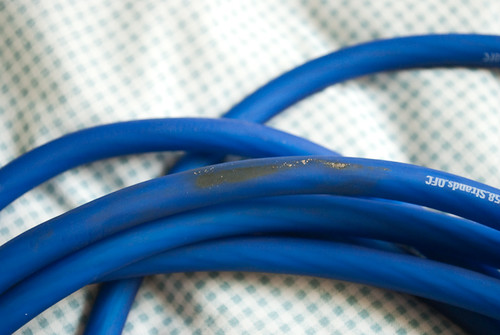

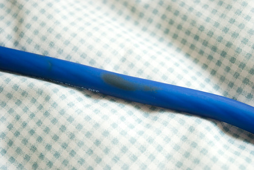

Ok I did a close inspection of the power wire... there are no cuts in the insulation, but these marks are suspicious. I can't tell if they are burn marks or just grease/gunk from random places where it was run.
