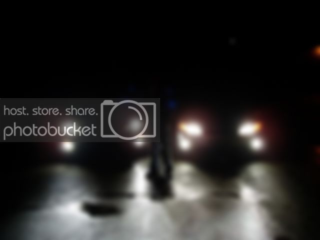

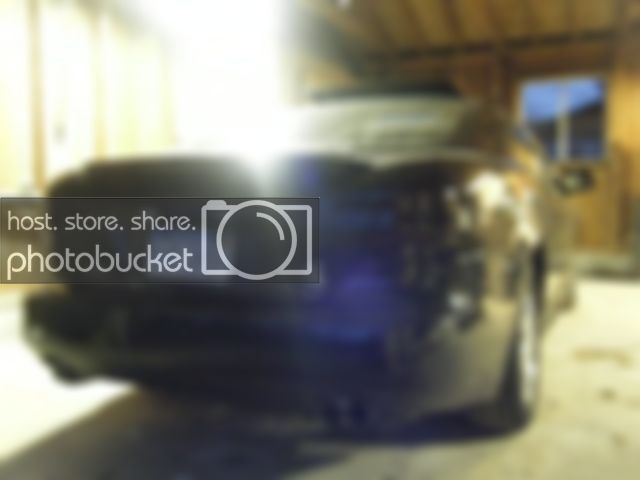

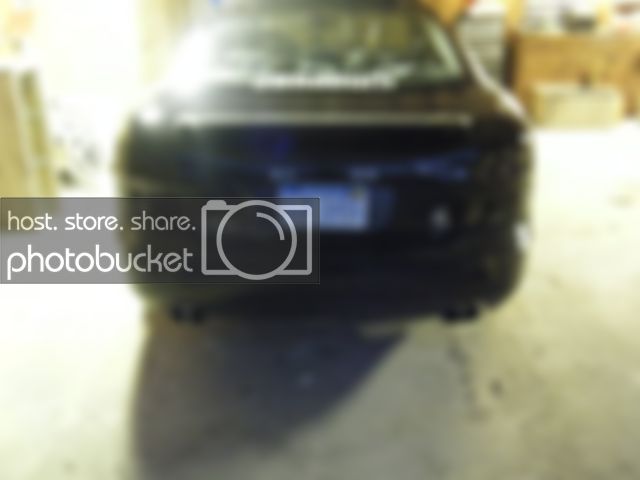

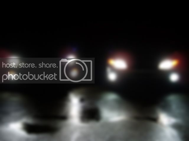

just got the hid's installed on my 05, and got some pics together with adam coon. we both got 8000k in the headlights and fog lights.
the headlights are running a 55 watt ballast, while the fogs are just on a 35 watt due to space inside the housing...
here are the end results.

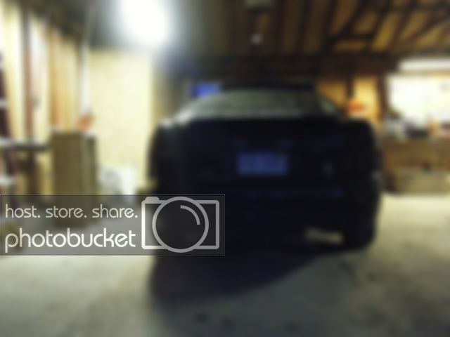

got a little work done yesterday, gettin ready to go back out in the garage and get some more done. here are some more pics to get you guys by.

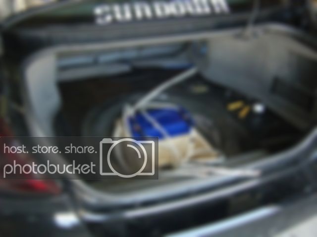

what am i gonna do with this battery???
keep in mind, everything not done yet, everything will be cleaned up.

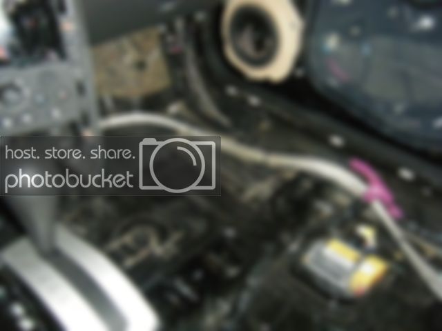

decided to rewire my front stage and get it all installed. i used kukonceptz bi-wire (basically 4 wires in one sleeve. really nice and less hassle and mess when installing. only downside, is its about the same size as 2 guage. oh well

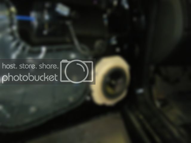

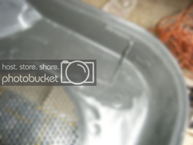

my baffles housing the id oem's

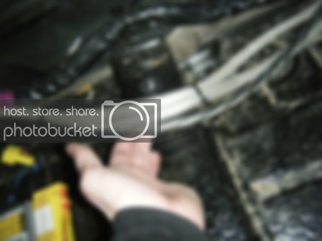

the speaker wire matched up against my 1/0

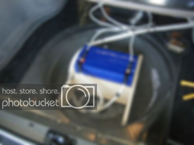

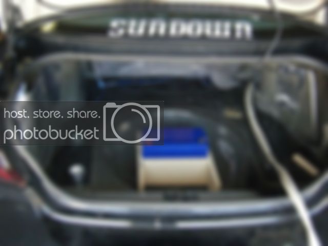

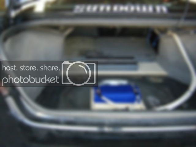

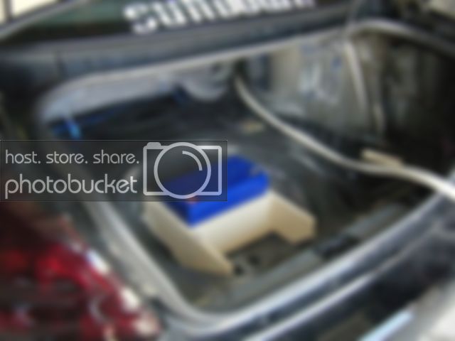

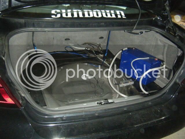

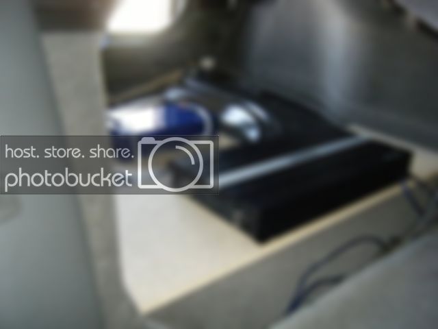

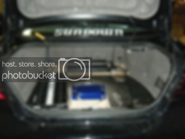

here is the start of my false floor. and getting the 100.4 mounted, will be all wired up today.
the false floor will not cover the whole trunk, if it did my box would not fit as it would be to tall. i should have mroe updates tonight for ya guys

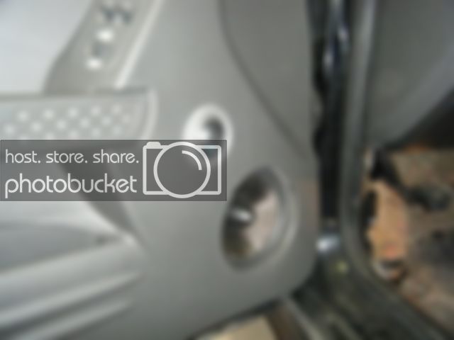

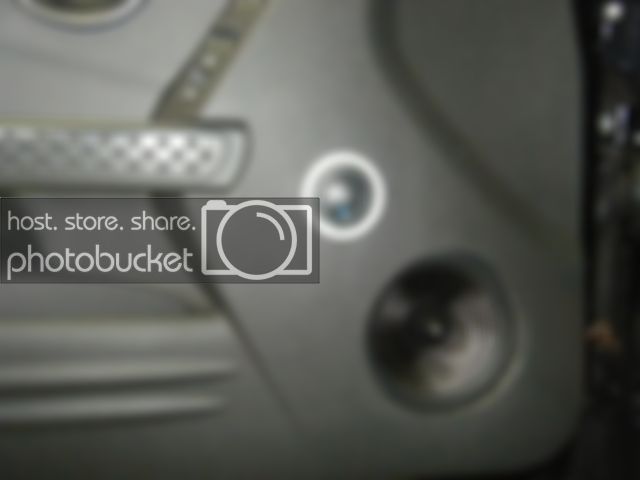

in order for my door panels to fit on the door, there were a couple pieces i had to remove due to them hitting the baffles.

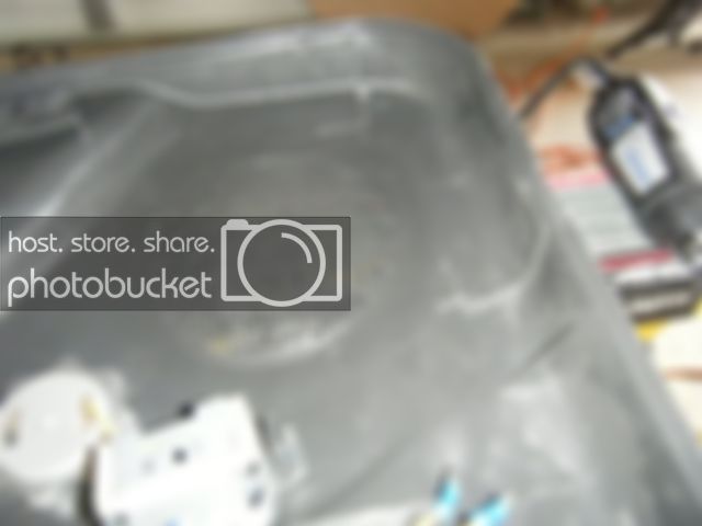

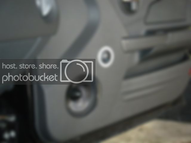

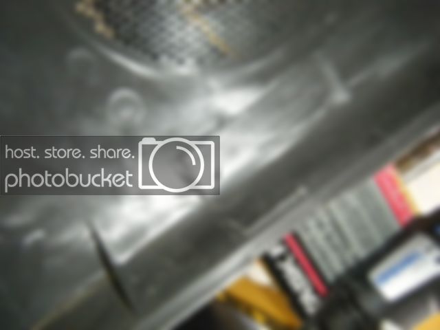

well when installing my door panels and after i started tuning it, it sounded really distorted....
come to find out the plastic piece on the oem's cone was butted right up against my stock speaker grills on my door panel. well i had to make some adjustments for it to fit.
i had to cut out the stock speaker grills. i dont think it looks bad at all.

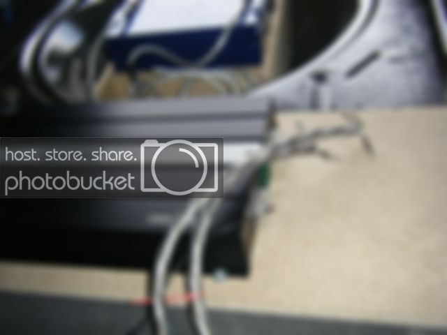

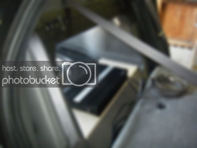

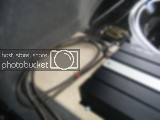

finishing up wiring the amp

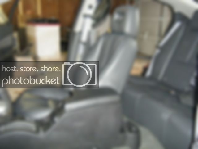

and then installed the seats and carpet and i am good to go
gotta still finish the false floor in the trunk and build my box, carpet everything, and clean all the wires up. but once thats done im pretty set.

throw the oem grills on the mids to protect them and give it a stock look. Also i got engine whine in the speakers when i ran the speaker wire next to the power wire. I moved it and it went away. Might get some the way u have it ran just letting u know my experience.
