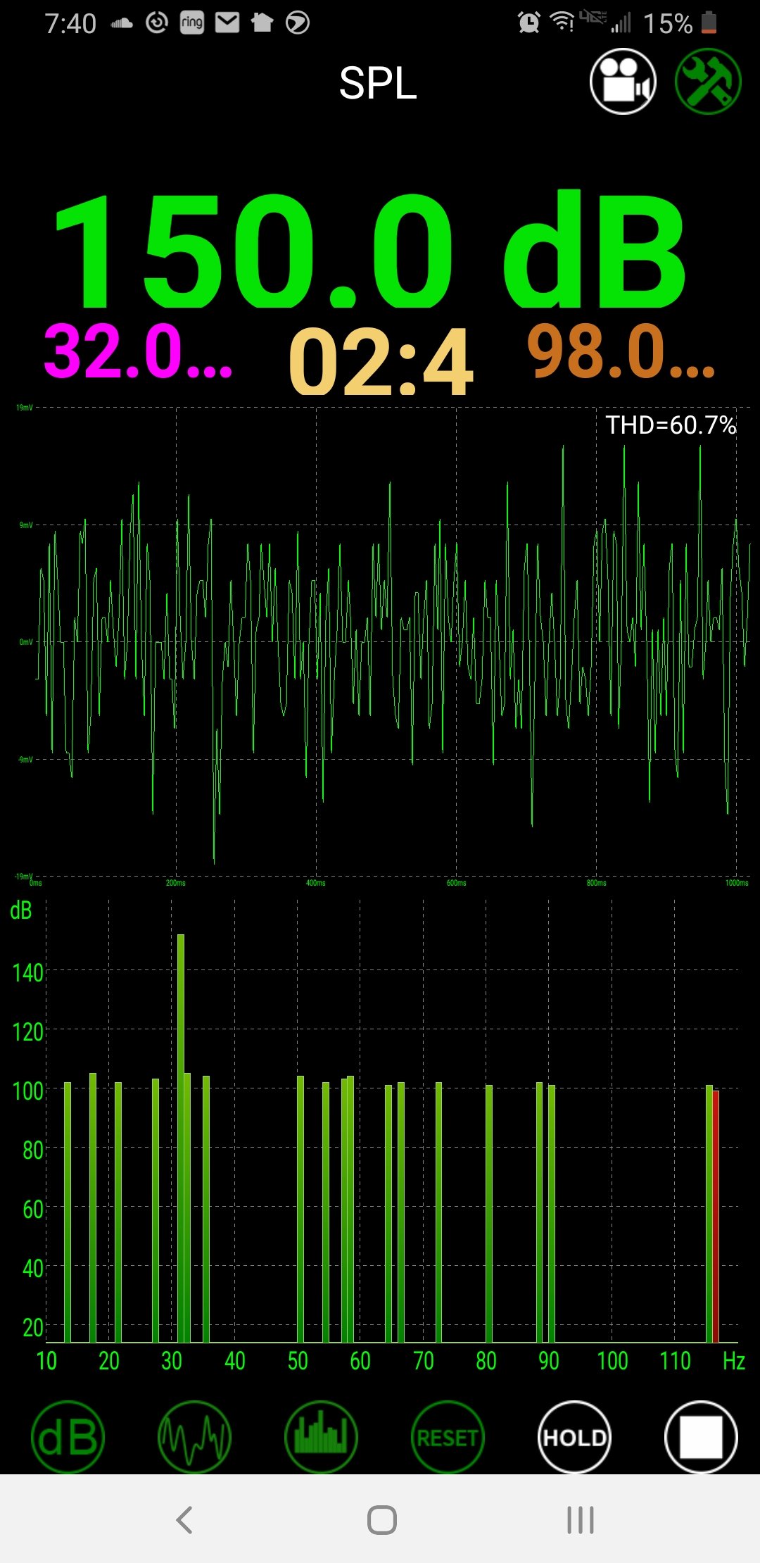

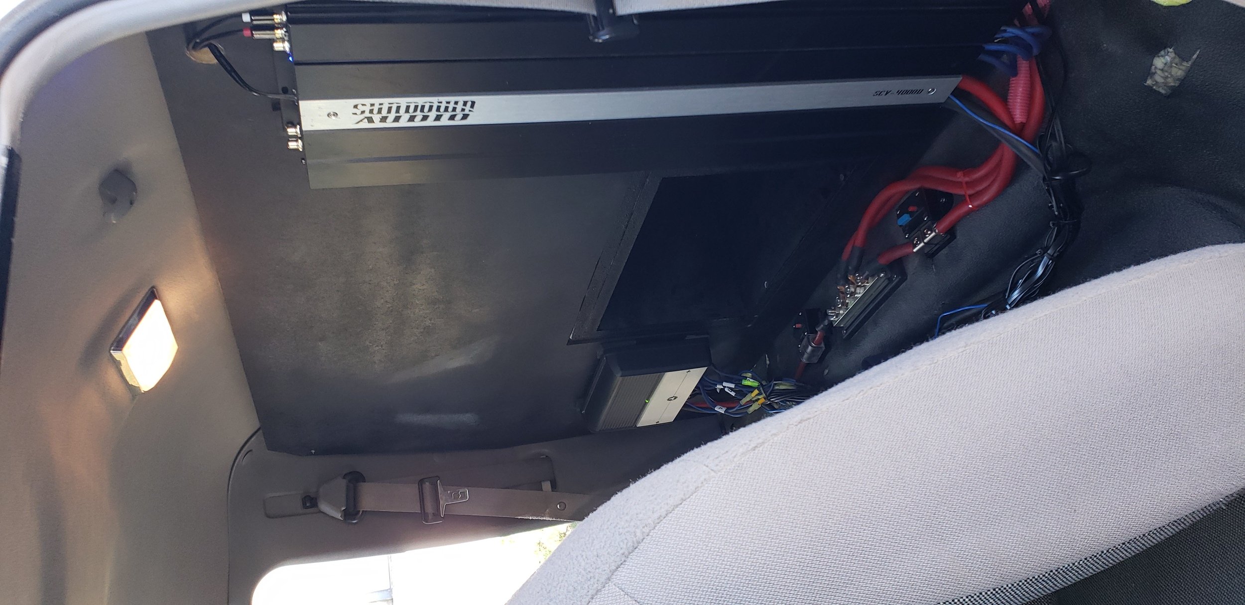

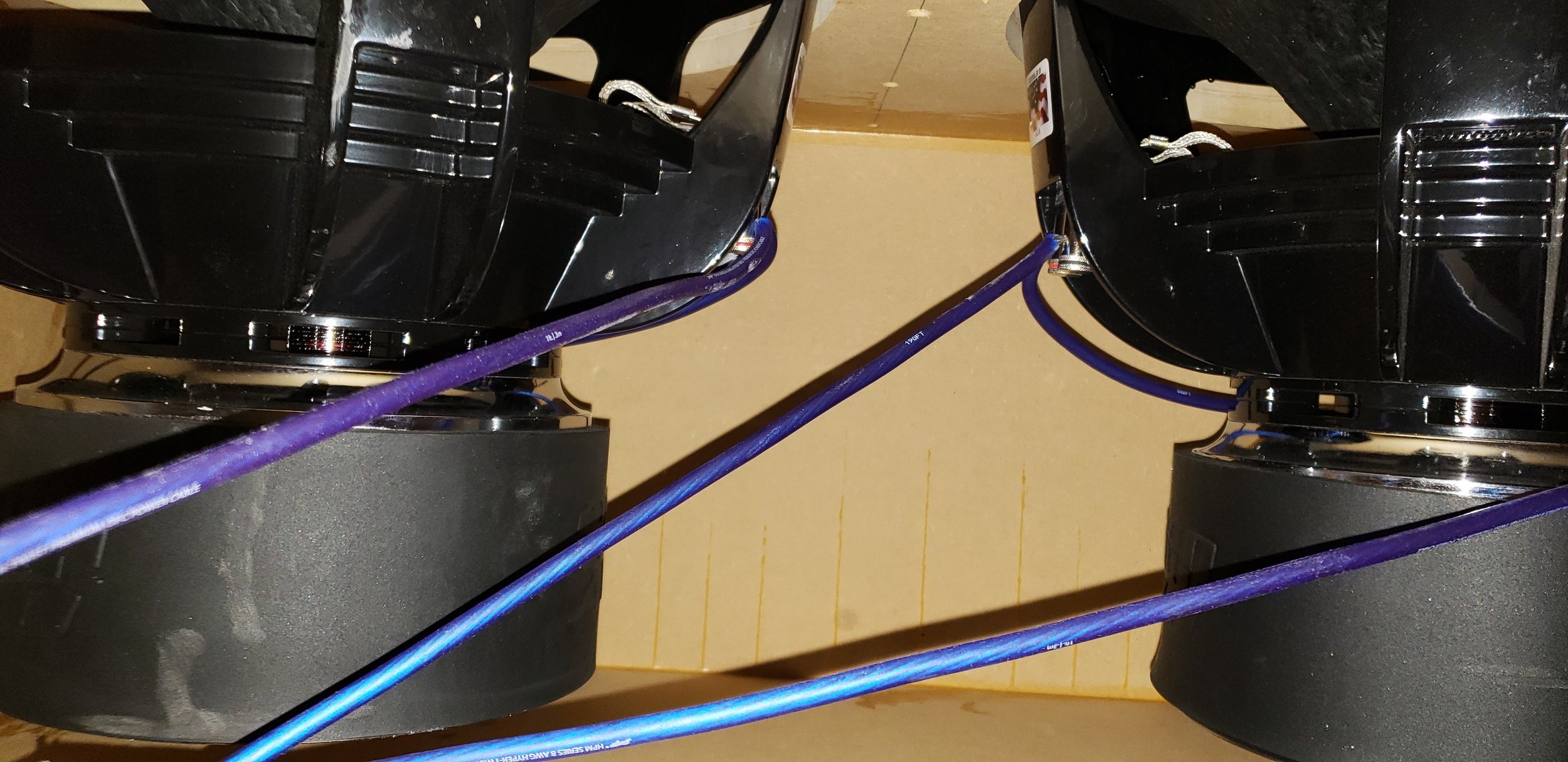

I don't know if y'all are following the thread still but the build is done and I have some numbers. Mid build we did a spl test and got 150.0 at 32hz. After the build was done we were only able to hit 149.5 at 36hz. This was confusing but now that the system has broken in some we hit 151 at 36 hz. We are 150+ from 30 to 38 and 140+ from 20 to 55. We also ordered a sfb 8k and are hoping to get the 155 with more break in and a few upgrades to our battery bank. I will continue to keep you posted!
