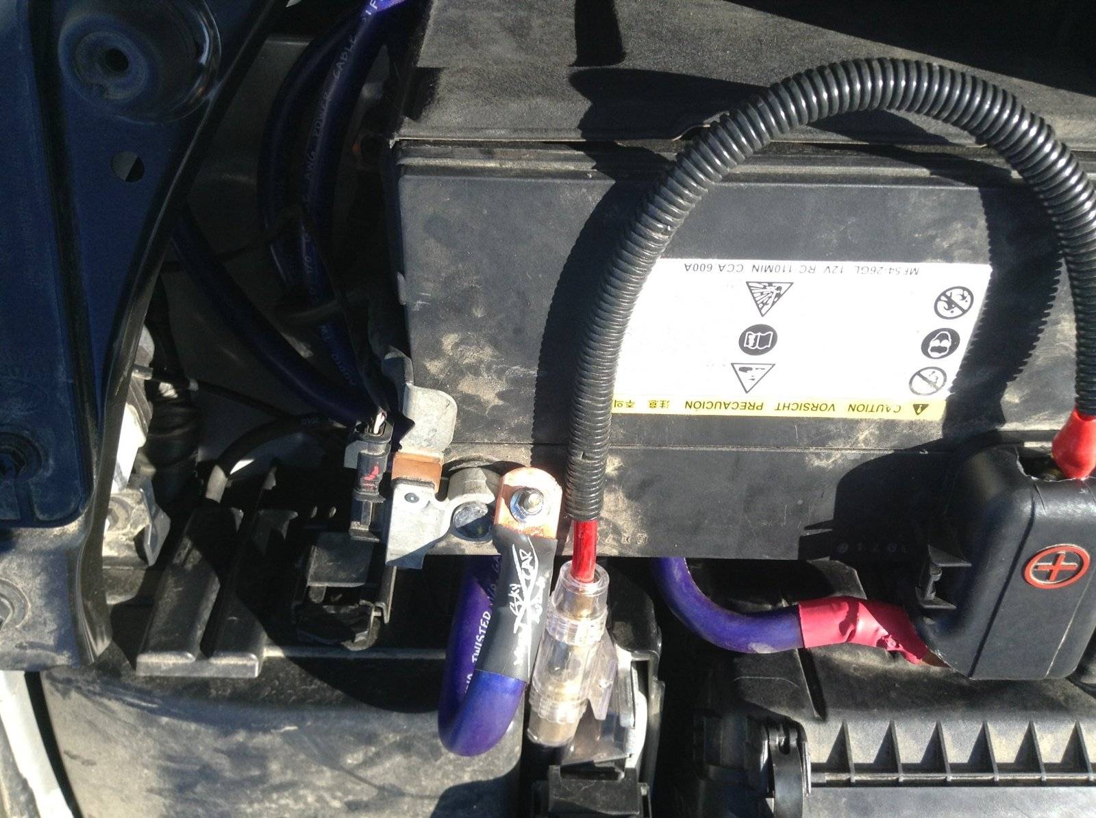

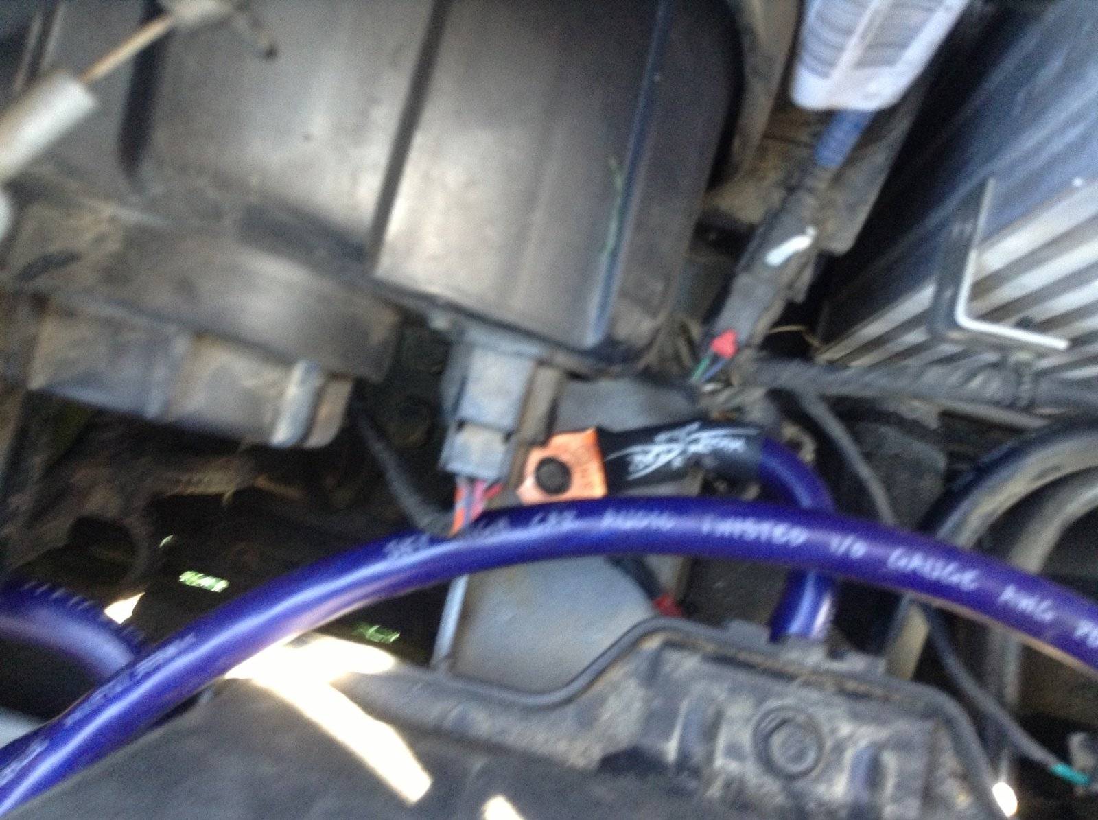

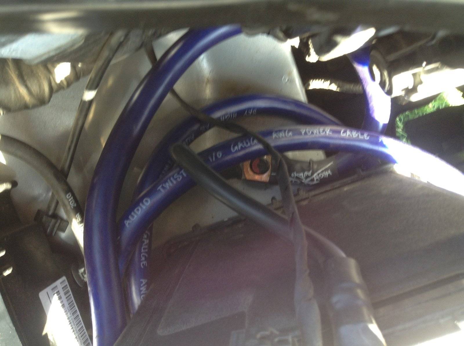

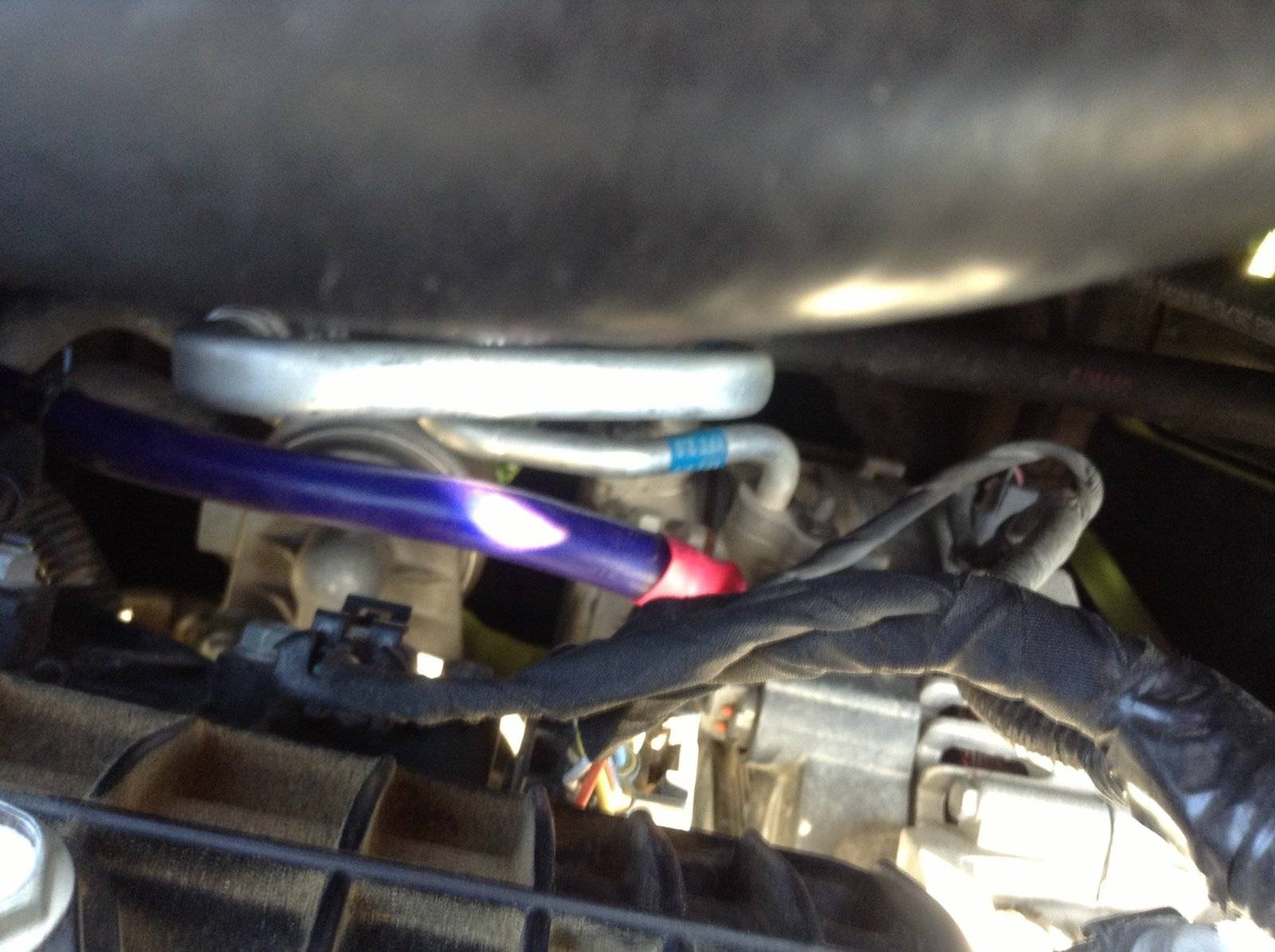

Got my big 3 done today thanks to quick shipping and great kit from mylows10. More trouble than i wanted but alot less than i anticipated. With stock battery cables on hyundai sonata you need to have one connector either smaller or grind it down a bit to fit. 0 gauge wire from mylows is extremely flexible and easy to work with. Just thought I'd post an update.

Pics of big 3
