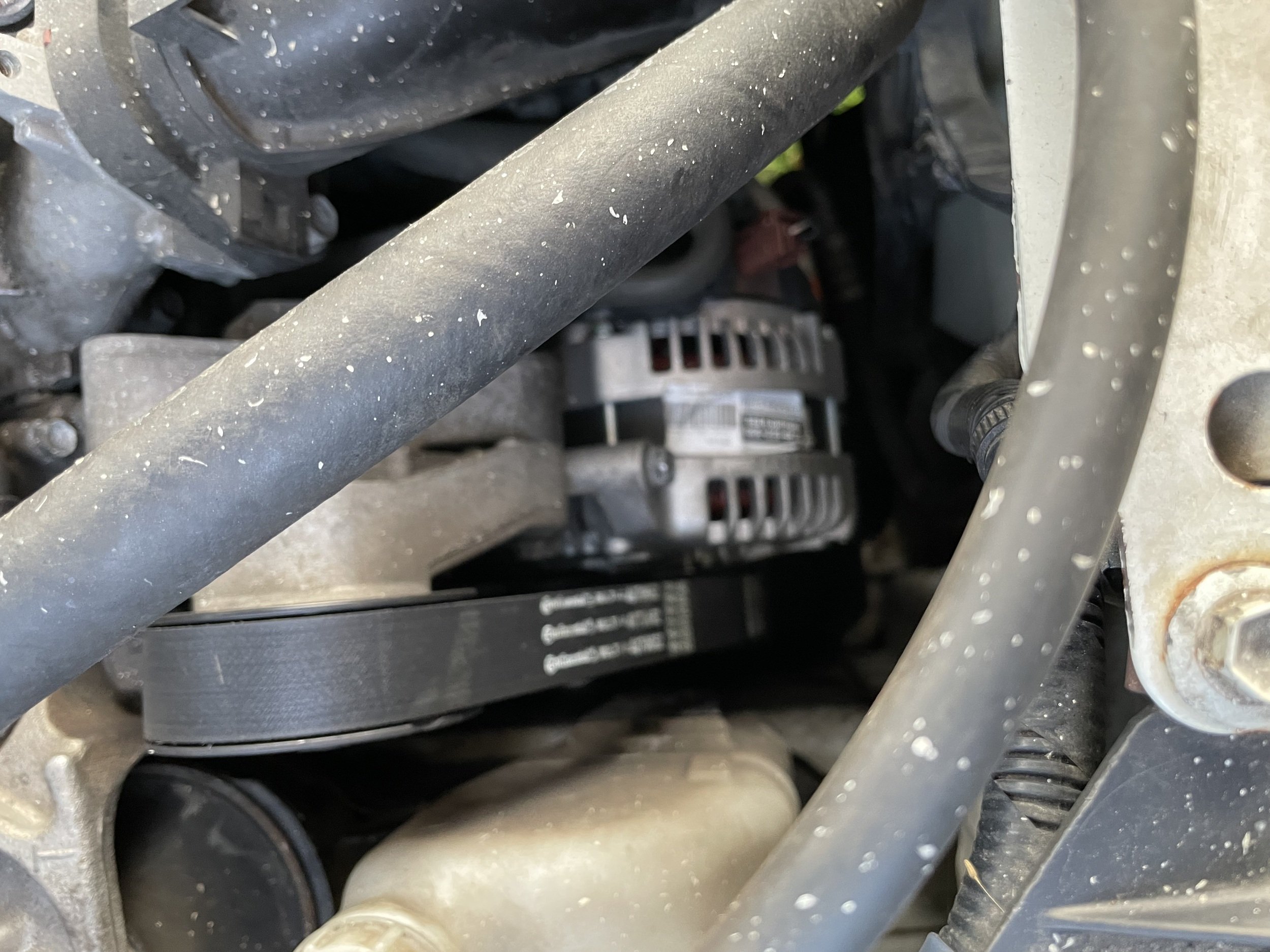

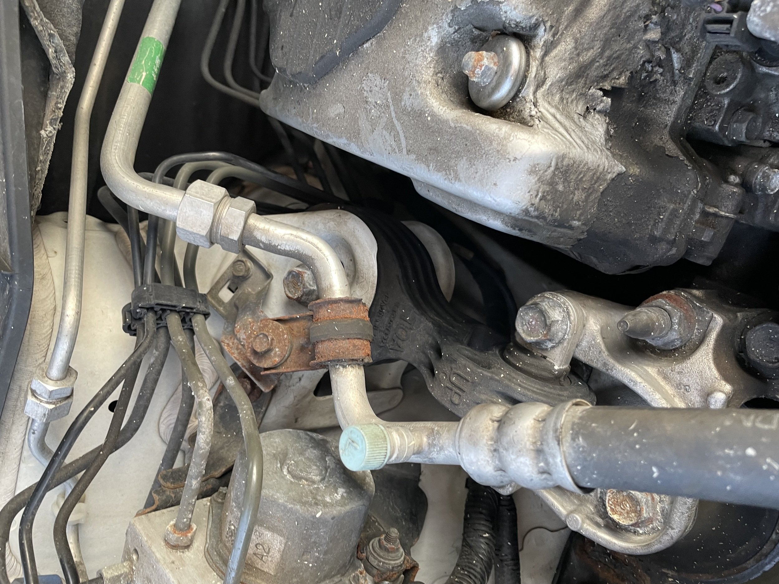

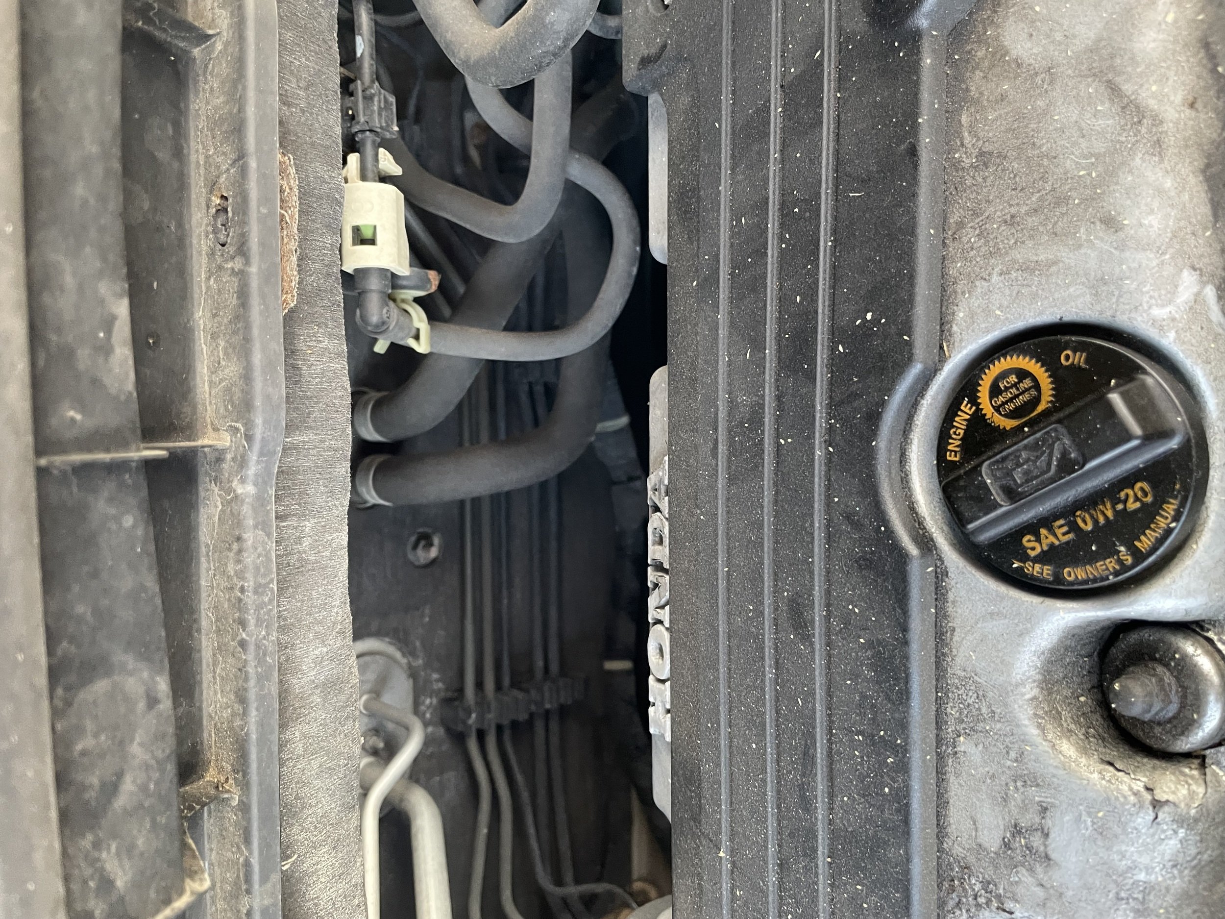

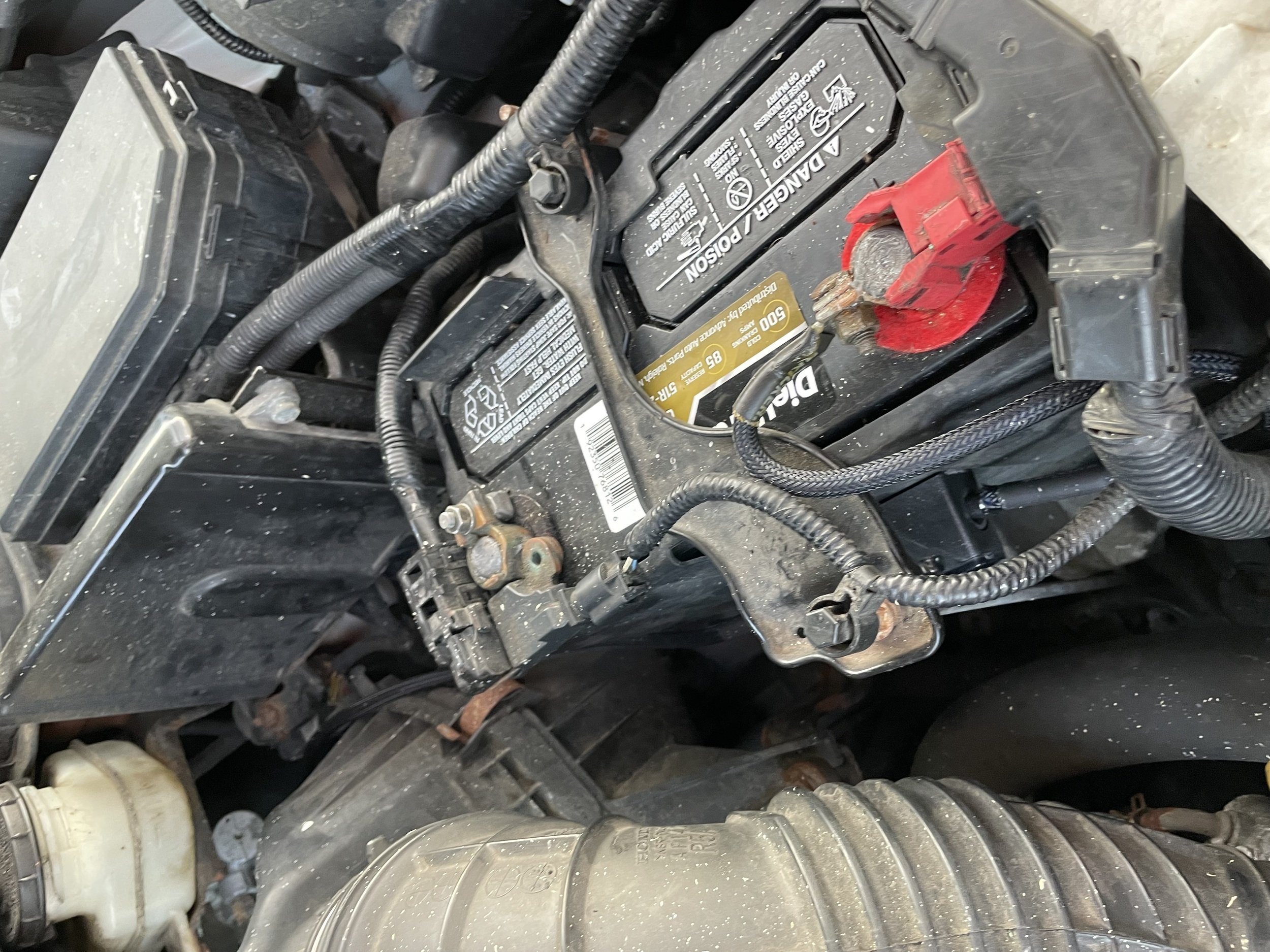

It’s the engine to chassis one that’s hard to get to it’s only about 6 inches long and right under the engine mount on top of the strut mount. It’s small gauge too. Looks like 10 or 12 gauge to me
Where did you get your information from of how the Big3 is done? Id like to know what the source of information and or Video is that you are acquiring to conduct the Big3? Pics of your issues of the engine bay areas will help determine a logical remedy. It isnt necessary to just use that strut bolt. There are other areas to utilize for a proper ground point. But tell me or Link of what source and or Vid. you are acquiring about in order to conduct the Big3. I am a bit curious

All jokes aside, I figured it out. I took the plastic cover thing off of the negative battery terminal, and I can attach a new ground wire right...
