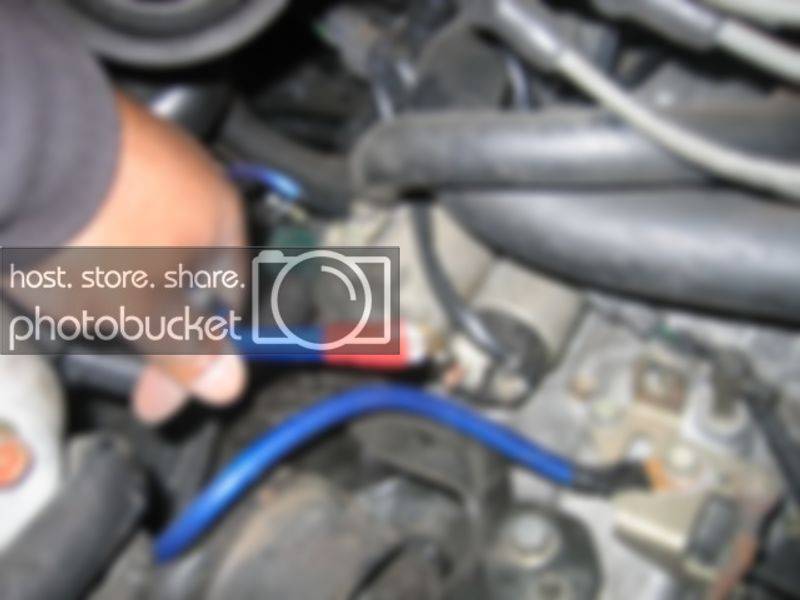

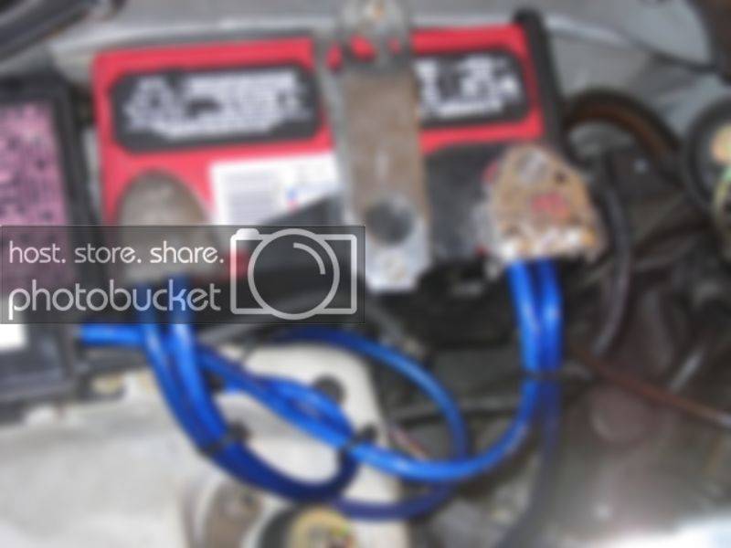

Here are pics of the starter wire and ****** ground.
is this part of the big 3?
under the hood, instead of the pos batt goin' to the alt it goes to a fuse box.
//content.invisioncic.com/y282845/emoticons/confused.gif.e820e0216602db4765798ac39d28caa9.gif:confused:
thoughts?

Hey brother, I think you answered you're own question //content.invisioncic.com/y282845/emoticons/wink.gif.608e3ea05f1a9f98611af0861652f8fb.gif! I think you're being confused by the fuse box. Just pretend the fuse box isn't there.
+ to + alt,
- to -***** (on the left side of the engine bay under the air filter box)
- to - chassis (should be 3" off the batt)
should need 8 feet or so (that's leaving you with a little slack)
Using all the same color wire (blue) can get confusing
Especially when you need a quick battery JUMP or charge (be carful)
You may want to solider the connections as well; the outside elements of weather are tuff on all wire connections (corrosion will build up between the wire and the connector)
There is nothing negative about upgrading the input power feed to the fuse box
Will increase the input current capabilities of the rest of the electrical system
