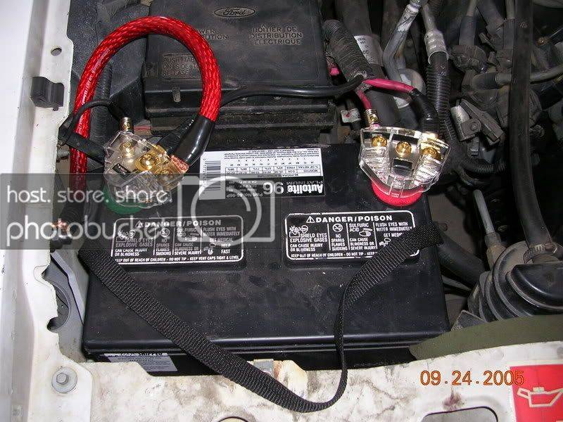

I used these way back when to install my big-3...
They have 3 posts you can connect up to #1/0 wire
Yeah, there are 2 4/2 gauge wires crimped into the OEM terminal now so a 3 terminal 0 gauge will definitely do the trick. Thanks guys! //content.invisioncic.com/y282845/emoticons/toast.gif.bc0657bf54b9ee653b6438524461341e.gif
I used these way back when to install my big-3...They have 3 posts you can connect up to #1/0 wire

I've ran several optima's in several cars and have had excellent results with all of them. I'm gonna upload a pic for ya to see mine.
