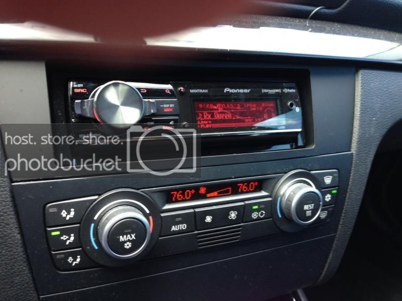

I own a 2008 BMW 135i that's been giving me a hard time with my stereo setup. My car came built "XM ready" (pre-wired, that's it), however BMW wants $1200 for a XM tuner. I've looked on ebay but theres no guarantee that'll work with my car.
So, back in April I purchased a Pioneer DEH-X9500BHS, fast install and it sounded great too! But after the first couple months the Metra dash kit started breaking down and it just looked awful..
