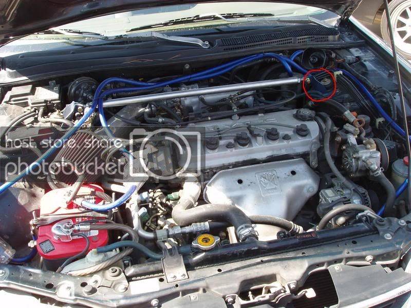

when i had my accord... i ran power wire through the little hole in the firewall on the driver side you should see it.. and ran my RCA's/remote on the passenger side.
there should be an opening where the red circle is
nonononononono...
theres a big *** grommet down behind the fusebox on the passenger side of the car... i've got a run of 4 gauge and a run of 1/0 going through mine, no problem. Just use a coathanger and some KY Jelly to pull wire through it, and make sure to angle it downwards.
