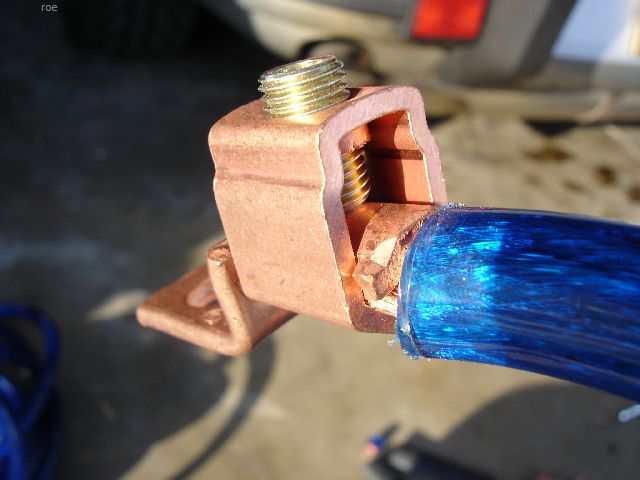

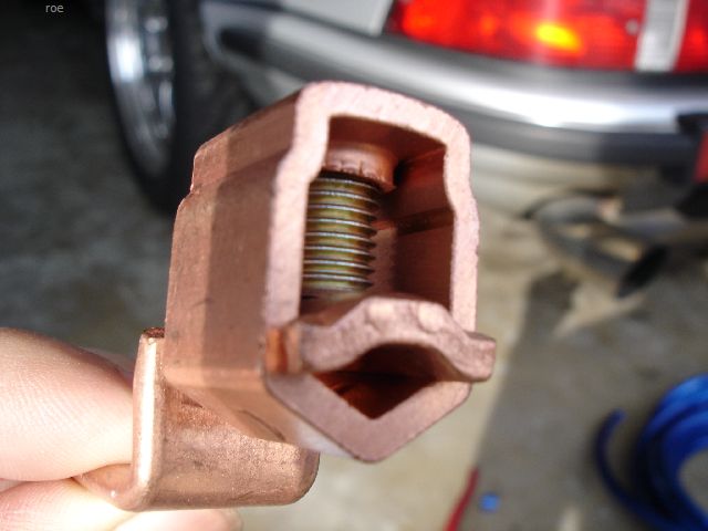

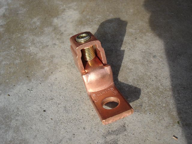

I've got one of these. It works so fvcking good. Stick the wire in there and beat the sh!t out of it

That sounds like a good connection, but the problem is that the wire is quit a big smaller than the lug and leaves alot of room. The wire is 2 awg and I think the lug is from 1/0 - 2 awg.
in that case, i would just get new connectors. i've found a nice compression type connector at home depot. it's readily availiable at my location and it sells for around $2.50 a piece. you can find various sizes to fit your needs. i would suggest that you add some loctite just to be certain that the screw doesn't come loose. the only problem is that it's a bit bulky. works great for grounding but not sure how well it works if your trying to connect power to a battery terminal.
Interesting, in the electrical department?
