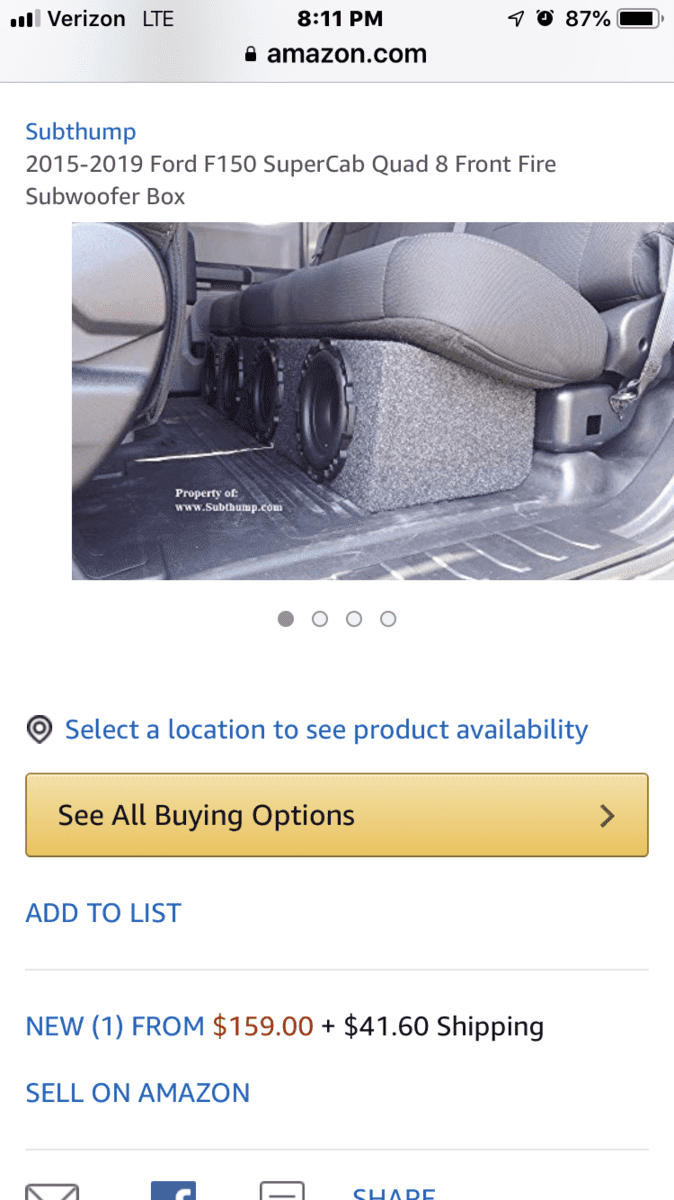

You would need to double cone area or power to experience any worthwhile gains in general. That being said 2 8s is 90% of the cone area of a single 12 so you'd need 4 8s for noticeable gains.
What kind of enclosure is the Q12 in and how is it oriented in the vehicle?
I will have to double check dimensions. I think it is around 14x14x16 with an octoport facing up behind the passenger seat, where the small portion of the back seat folds up.
I’m not real sure I can even fit quality 8s in a box like this back there.

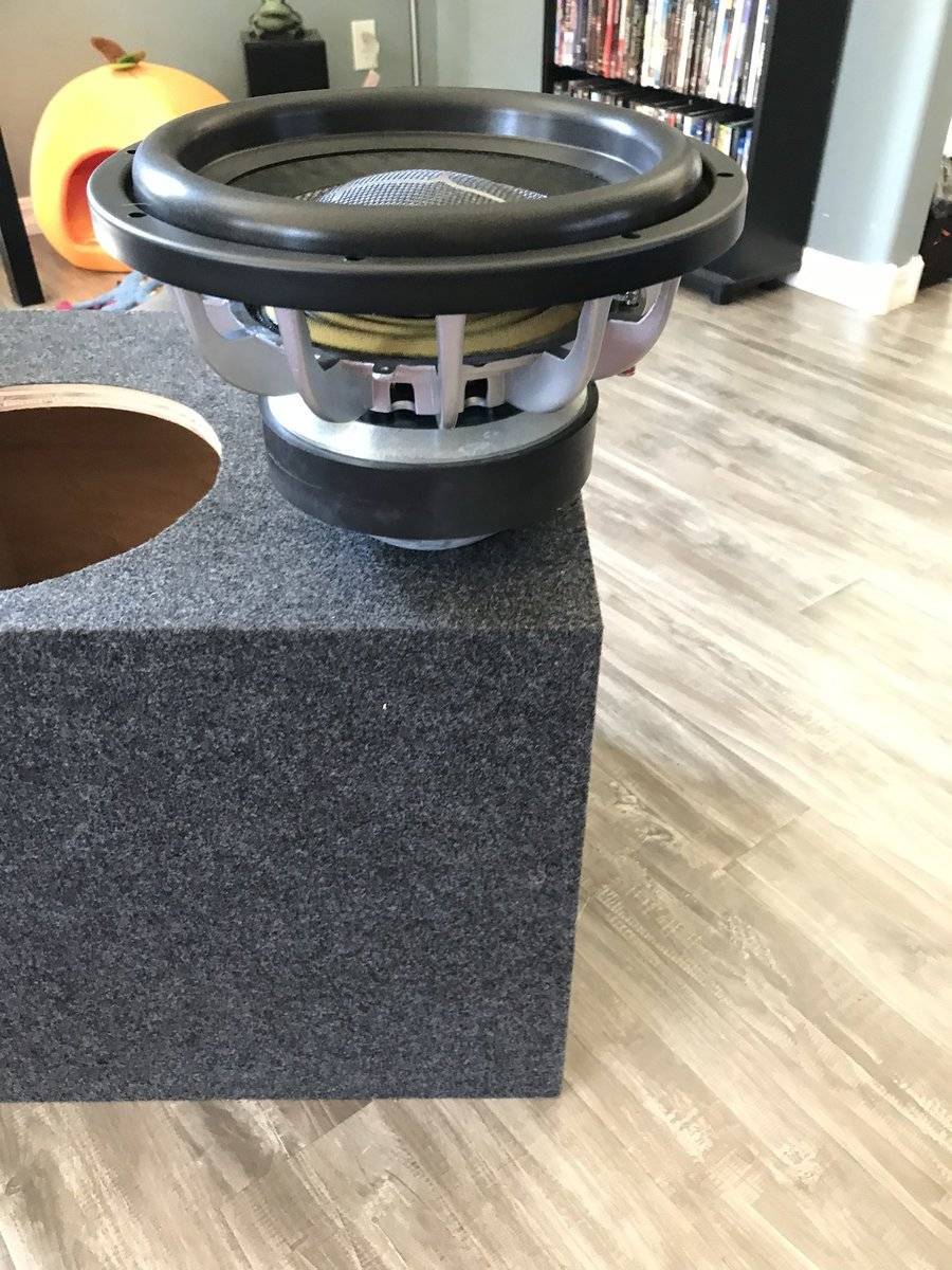

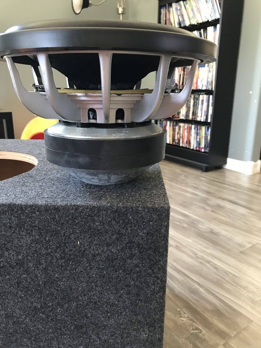

What version Q do you have? Is it a neo or ferrite motor?
Either way, you are underpowering that sub due to impedance rise.
Upgrading the amp would be a good idea but you will also need to upgrade your electrical system so it can sustain the current draw of a more powerful amp.
Which amp?
my FI Q is old. See the pics. Not neo.

Thats an older style Q, I'm pretty its still a 1krms sub. Upgrading to a 2-2.5k amp would be a good idea. A 50a fuse it too small for that JBL amp, bump it up to a 100a fuse. What size wiring do you have?
