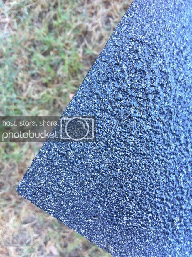

I sprayed this
Dupli-Color :: Truck Spatter Paint
on my box, stright to the MDF
still stuck to the box and no chipping or pealing
you can get it with green,white, and I think blue mixed in
I used an oil based primer so the MDF wouldnt soak up the water based stuff and make it swell and whatnot, then just put a black oil based epoxy paint (i think it was garage floor coating) on top of that because I had it lying around.
That duplicolor stuff looks good.
Ive never heard of spatter spray before I dont think its in my area, I wonder how strong and expensive it is, and if its reasonable to cover a box with it
