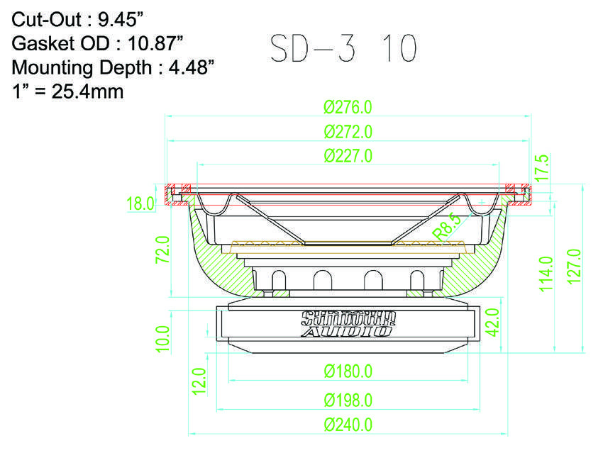

Thanks! SD lists at 4.75 so won't work for depth. Looks like I'm going Pioneer 12" as that's wfat box was built for per builder.
[quote name='Slammed01']Thanks! SD lists at 4.75 so won't work for depth. Looks like I'm going Pioneer 12" as that's wfat box was built for per builder.
Sent from my iPhone using Tapatalk[/QUOTE]
i thought they were 4.48 sorry. all the other sites say 4.48 and so does the manual and there woofer measurements. guess would have to ask @sundownz ;
