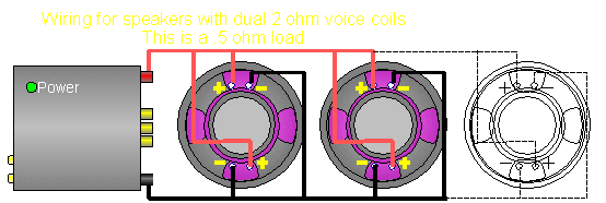

Mine would be hooked up like the first example. I know what im doing, i just dont know the terminology.
This link is to d2 subs, they would wire to .5 ohms if you wired like the picture, you should stay away from .5 ohms.
Now, if you get the d4's and run a full power at 1 ohm amp then yes, use that wiring.
You would wire series/parallel to 2 ohms for d2 subs, then you need to buy an amp that makes full power at 2 ohms.
You should get the d4 re se's and a full power (1000-1500w) at 1 ohm amp and wire it like the picture I posted.
Get dual 4ohm coils(d4) and then wire them up like the diagram it will give you a 1ohm load, easy as sh!t to find a mono amp that runs around 1200rms at 1 ohm:D Like maybe a us amps md1d works very very well with 2 SE's:)
sounds like a good idea. and i would wire how it is wired in the picture he posted?
that would be fine on a pair of d4 re se's wired as i posted in the picture. Start thinking about your box.
