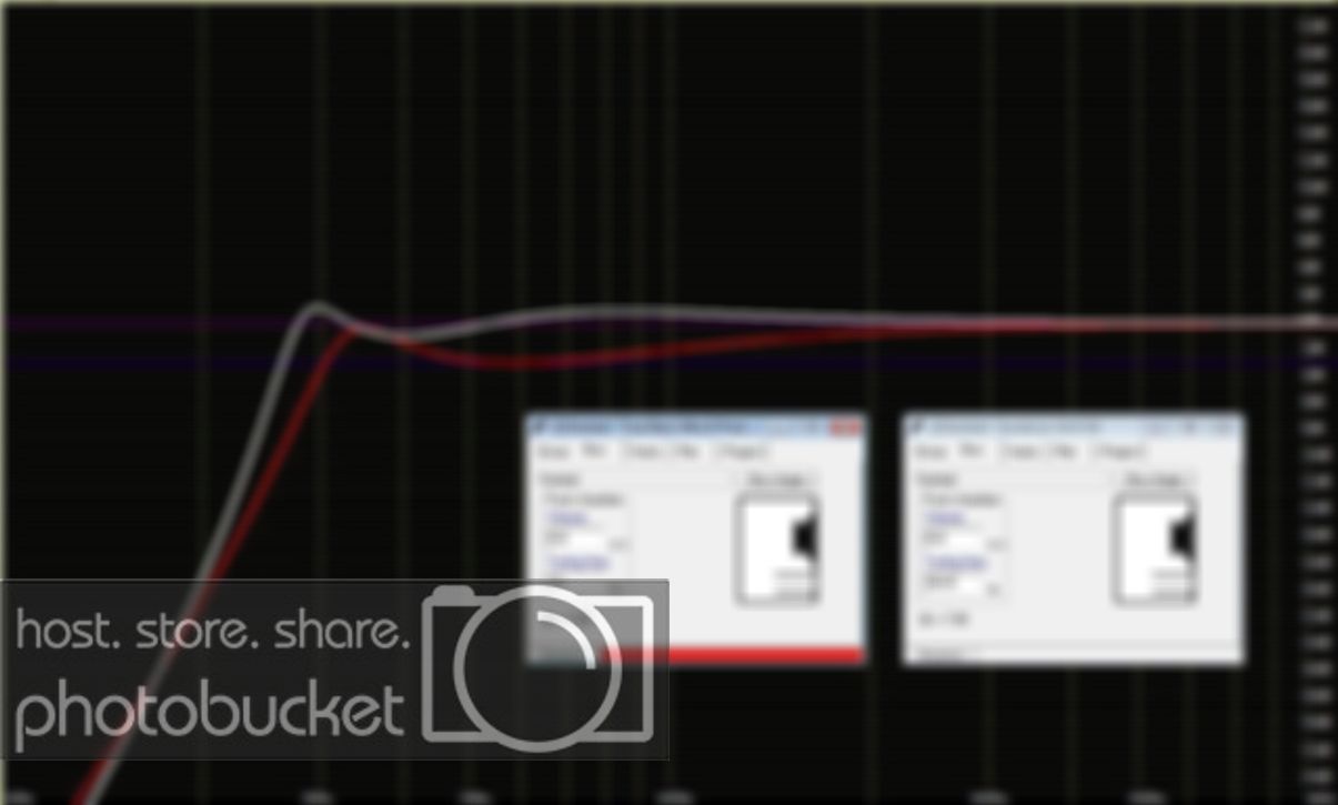

Here a freq plot showing output, both are in .8 net, the SA prefers 30Hz for flatter response thanks to that crazy Qts, the TB likes 32Hz. Both subs shown with 600 watts applied. ~4.4dB difference @ 34Hz - 37Hz .8 @ 30Hz and ~2dB @ 50Hz.

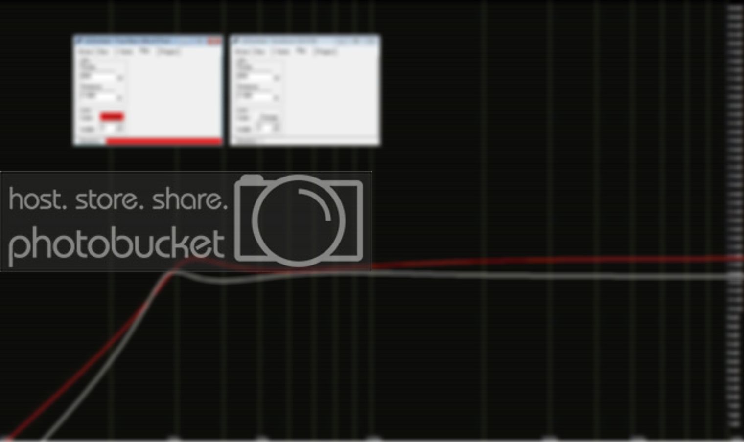

lol, be lucky to do a 133 with either on 600 in, The Graph was basically showing sound characteristics. The SA deviated alot more, heres a gain plot showing transfer function. The High Qts is very apparent in the subs "boomy" characteristics. The TB contours more naturally and would blend into cabin better with less eq. Since the del sol is a smaller car, you would want your natural dips in response to be around 50-60 Hz to compensate for cabin gain and make the output more flat. If I were to run an SPL system around an 8, at this time the SA-8 would def be my driver of choice. Extreme power handling and High Qts makes for a more SPL derived driver. Higher Qts subs are known for being muddy sounding, Low Qts subs are naturally more transient and natural sounding. Not saying "hey dont go with the SA-8" just saying for your goals the DD or TB would be a better choice, and the TB is the most user friendly driver of the 3, Not alot of people have played with True Bass stuff enough to know what they are capable of but names like DD and Sundown are in every bodies vocabulary. Bang for the buck wise, I guarantee there is not a comparable sub on the planet that is readily available to the car audio market. I have a definitive technologies 8 that flat destroys a TB SQ wise, but it peaks out around 128dB and thats just not enough to cut it when the windows are down and cruising at speed. I, like you, am not a numbers guy, every build I am currently working on is an SQ system and I currently don't own any "dedicated spl" subs, I just simply have no need for them at this time. I have run alot of different brands over the past 17 years, and owned over 400 drivers now, the True Bass Subs have always been a no compromise fail safe when looking for ample output and good sound quality and time after time I return to them for builds be it SPL or SQ.
