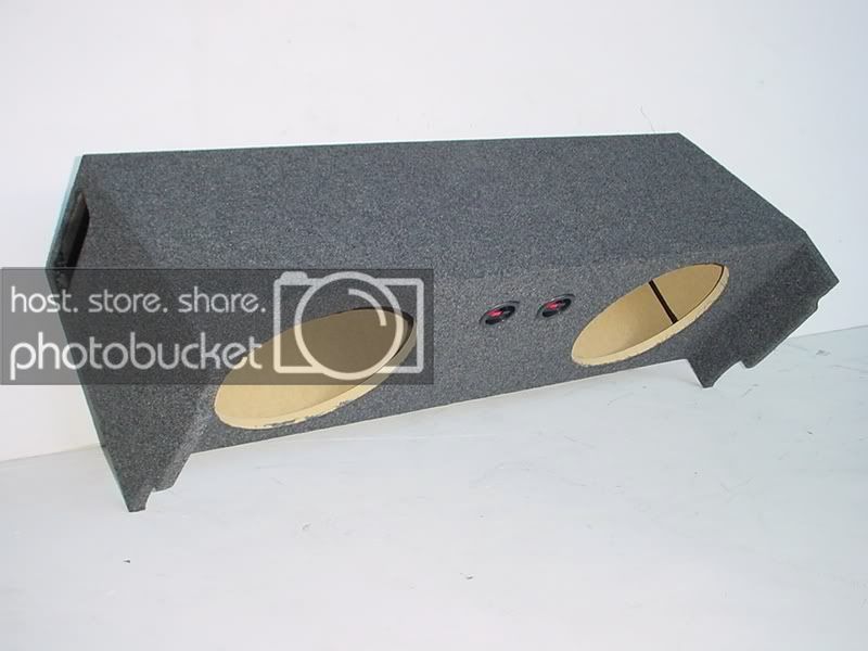

i'll try to get some pics tomorrow but picture a wedge box that fills that rear area all the way to the top of the seat. the subs fire down to the floor with maybe an inch or so between the subs and the floor.
Rough dimension I have to work with (most likely gonna need to fire down so gotta leave room for excursion) is:
Dimensions 42.25'' W x 12.5'' BD x 7'' TD x 18" H I could go about a few inches higher (maybe 6-8in) but my top depth would be shrinking as well.
I'm guessing it'll net around 2.5-3.0cuft. Havent run exact numbers yet.
Design was looking to be somewhere along this line as mentioned by Chipmunk2k3.
It MIGHT fit 12s, but I'm not too sure if I'll have enough volume for box n ports. I gotta sit down and work on the exact numbers maybe tomorrow. But it'll probably be around 2.5-3cuft as I mentioned before?
