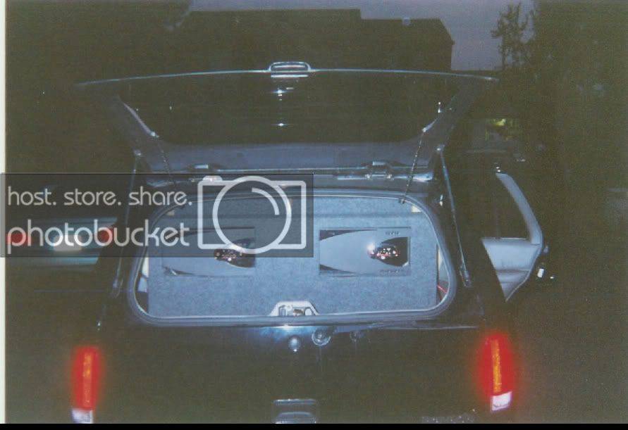

2000 Olds Bravada, stock 100A alt (170k miles-has never been replaced), Delco 75PS battery (new as of October 2013); have only done Big 3 so far.
ZRX3200.1D (which I'm told does not do rated) on two AB XFL1244's @ 1ohm; 1/0 ofc for power wire, all grounds cleaned before install. I know my stuff is starving so I haven't been playing it other than for the day after I installed.
