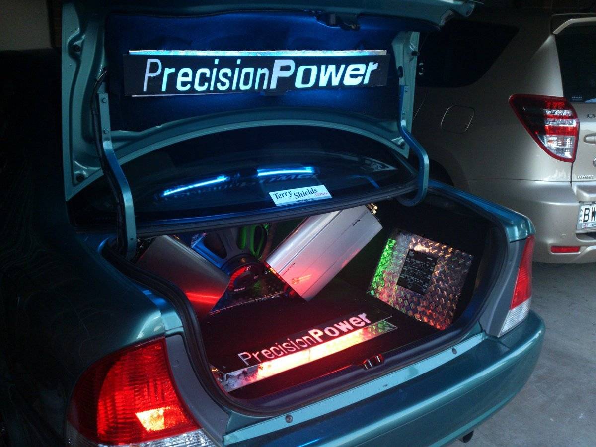

  • This is a rough impression but you can be more creative and have good wood working skills to do a better custom work using more elaborate tools such as router / Perspex, Custom subwoofer box instead of a sealed / ported prefab box but its a good start to searching for a decent sound in your ride.
