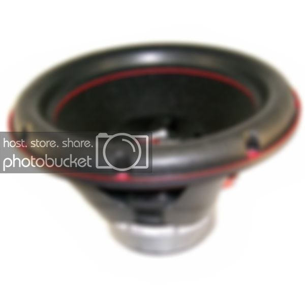

I only asked because so many people say "after rise", and I don't really want to run my amp below 1 ohm. All said and done, I think I would be be adding a tad under $150 or so to the exchange. Here's the sub:
resource.ashx
to replace this one: as you can see... the surround is contoured to allow a drill/screwdriver access to the mouinting holes. It is around one of those contours that there is damage.

I definitely don't like the look of those surrounds. Cute, and in theory that edge of the surround shouldn't be live anyway, but still....ugly.
The bright side with those particular Lanzars is that you should be able to recone them cheap if you manage to break them. They look very solid and the few reviews of that era Opti subs have been encouraging.
