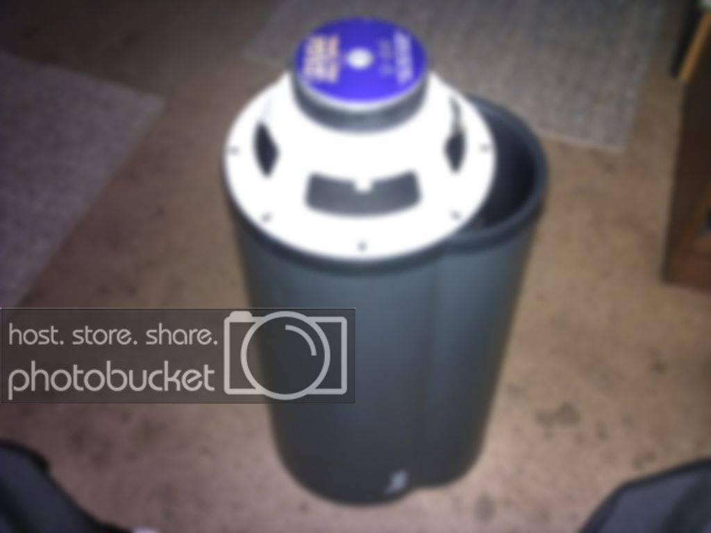

On the other hand, you CAN buy a bazooka tube off of ebay for $20 (a blown one, sometimes even a good one) and use the enclsoure for another speaker entirely like the Soundsplinter 8", or some other driver.
for example :
Thats the older 8" bazooka model, the new ones are fairly close to this so at least you get a peek inside.
I got bored the other month and did this to it :
I use it for my computer's subwoofer off of a old 80's Pioneer 300 watt amp, and it rocks man. I also throw it in my vette on occasion.....sure its ugly but functional.
my point is this, buy the bazooka tube for your own cheapie pre made box and just put whatever sub you want in it.....add fiber fill to adjust tuning...wah-lah
