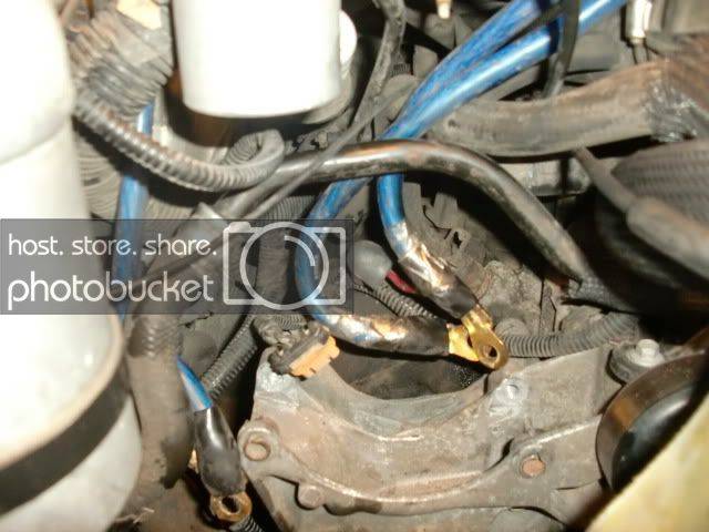

So I got on it today getting on the interstate, battery light came on, stayed on a few seconds then went off. Put it in neutral, reved it, nothing for a few seconds, stopped reving, light came on a few seconds. Pulled over, put DMM on front battery 14.18. Reved it up, droped to 13.2...stereo off. Checked rear batts, 14.18 running, dropped to 13.5 off, probably would have kept dropping slowly.
O'Reilley AGM in front, 2 large O'Reilley AGMs in back 100aH. Iraggi HO alt, the highest at idle lowest peak: 160-180 idle, 200-220 peak.

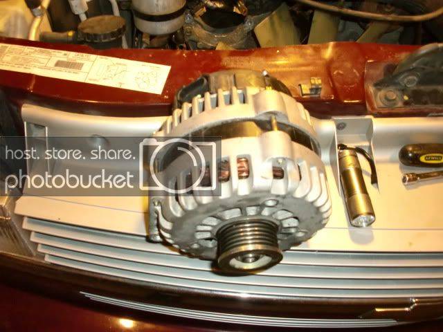

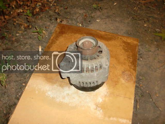

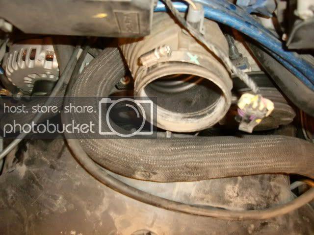

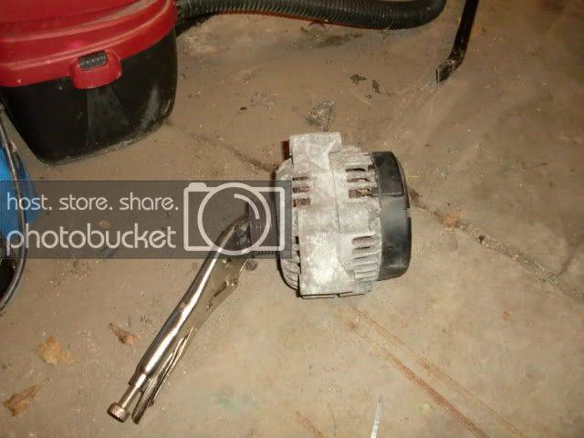

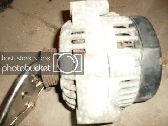

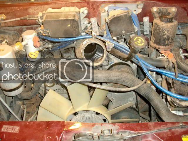

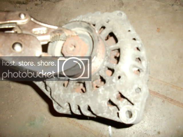

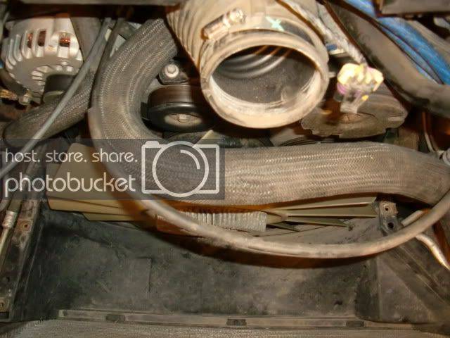

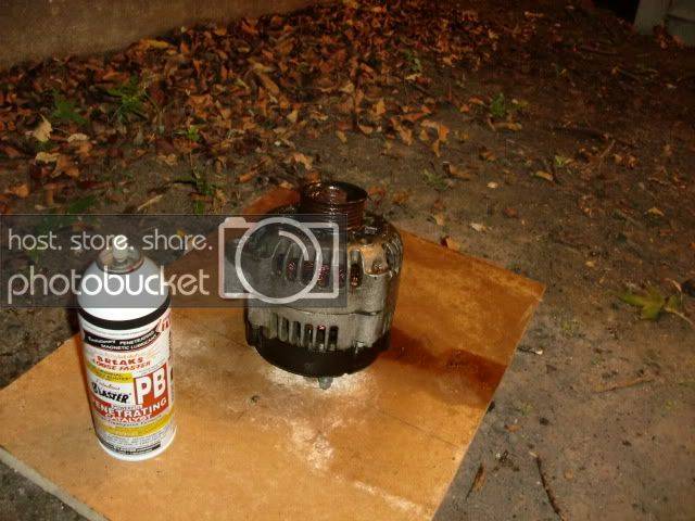

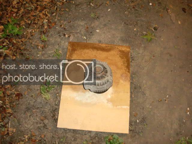

pulled the Iraggi today, was gonna drop the stock back in so I have a vehicle to drive till I get it repaired and order a 2nd alt. The stock one has been sitting on a shelf in the basement since I pulled it. it didnt get wet, but it's been humid. The **** thing rusted and I cant even spin the pulley! Now what the f do I do? I am stranded at home, cant get ahold of Iraggi.
I know a lot of people are gonna talk shit, but 4 separate forums have said the same thing. But it never fails, anything I do, so many people think they gotta say sumthin stupid and when I get mad Im told not to over react.
I was told to spray her down. So I did. Do I need to use anything to remove it from the pulley after it sits over nite?
brought the HO alt and the stock alt back to Vans, talked to the owner this time. What a difference. We had a blast going back and forth, guy knows his shit. The brush tensioner spring went bad. He replaced the assembly for me and I gave him my stock alt. I know he came out ahead, but my HO alt works great so I don't care!
