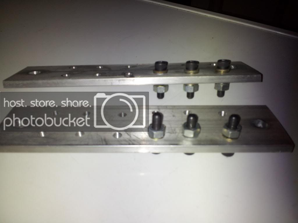

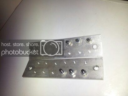

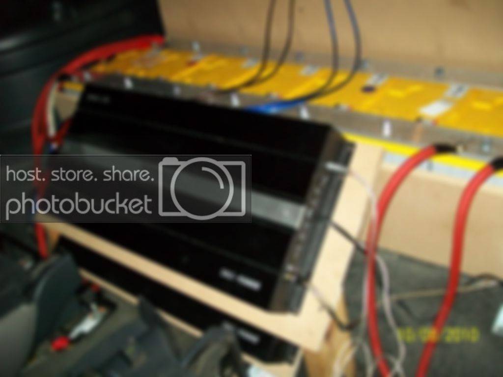

1/4" thick 6061 aluminum ..go to a metal scrapyard u can get odd pieces for cheap..i paid 15 bucks for. 3 ' long piece 2 inches wide...i drilled them to fit my studs to connect my rear batt bank and i also drilled and tapped 12 holes on each one to allow lots of easy hookups for all my runs and amps..very easy simple and cheap..hell i think i have enough left to make another set if i needed too
can i get a pic of this? as i think i need to do something similar with 2 batteries i buy
Drilled a through hole for battery post and drilled and tapped the holes for the ring termonal bolts I used 1/4"x4" if I recall might be 3" wide its covered now so cant measure it.
