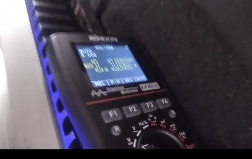

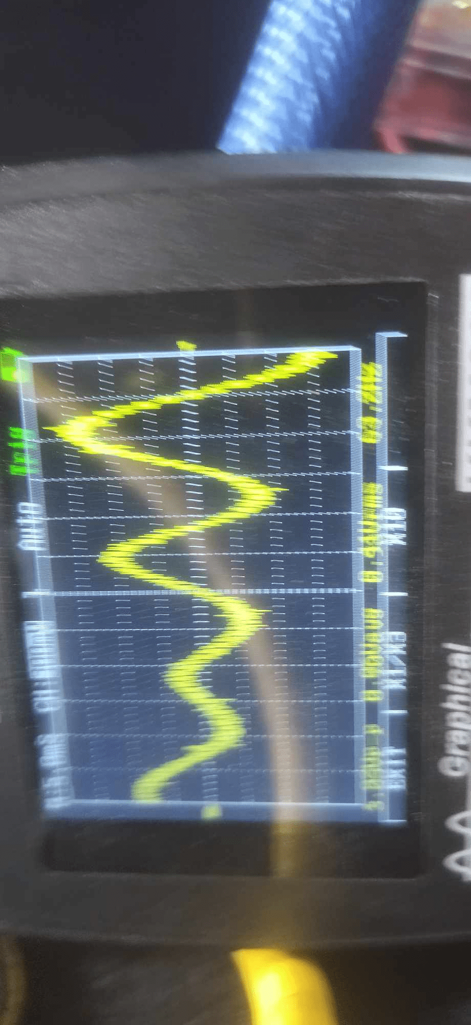

Update 3: New and more ground point (PARAEL) not working... First start play my sound system, bass not bad, and not 100% good, the bass gone after 10 minutes. Ground wires 2x shorter, but now power wires 2x longer.
Below in the photo you can see the tension on the music play, tension on amplifier ground, in peace is about 0,5v, on music jumps from 0,050v to 1,4v. Reading from: GROUND TERMINAL AMP AND BODY AMP (SCREW)
In addition, I observed two phenomena:
1. FIRST Play system car audio after Test new grounds point: Source AUX/BT nice signal rca (because something else?)
volume 22 and full power audio, after next engine start: i must set volume about 26-27 to get this same. So, RCA signal LOSS?
2. I have on my BITMAT ab25 a 0,2-0,3 voltage, WFT? Why?

Next issues is Weird current on car body? Current power on amps (from 0,5 to 14 volts!!! Metered from One multimeter wire to GROUND amp terminal, and next wire multimeter to Screw (Body amp))
Now i have disconnected all my custom system, but i have weird issue
Led Strip is disconeccted wires GRound and power wire from batts, (They are lying loose) And its work!!! LOL
How? they glow dimly, like about 2 volts ( i must check this how voltage)
I think, this can Mallufuncioning my Audio in car and many devices.
Any ideas for this phenomenon?

For those who are looking for a problem: Look for the cause of the tension on amp bodies,
or in other places
I'm sure that's the cause of problems. This same issue i have at home, but i have not grounded home, my leds in home if are switch off, glow gentlies. And sounds from my PA amps at home is also different!

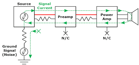

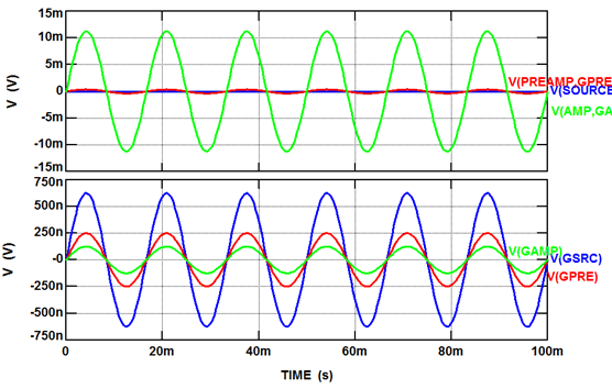

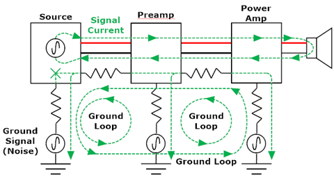

Its a
GROUND LOOP! This is a.. phase shifted, but in a signal.
that explains it, why bass in garage is awesome, but in car no...
Moving sub, bass can back (Ground loop Feedback)
Ground loop can induction voltage (on my amp body) Thats right!
I have Noises on bass amp and werd sinusoidal wave (distorted)
The noises is this same with connected rca and disconected. 0,3-0,5 volts noise.
But i dont know how fix this issue.
connection Source with preamp and amp2 from the bass amp terminall not working.
When i good no iduction voltage (Source ground with 1mm wire only with source body, outside car and back to trunk witch rear doors and to - supercaps, amp) be fine but if i start amp, voltage up to 0,2 volts.
I found a video that describes the problem, but I can't quite understand it. Whats wires itp.
Any help? https: //www.youtube.com/watch?v=xbinXh1ZSqk&list=LL&index=1&t=492s
