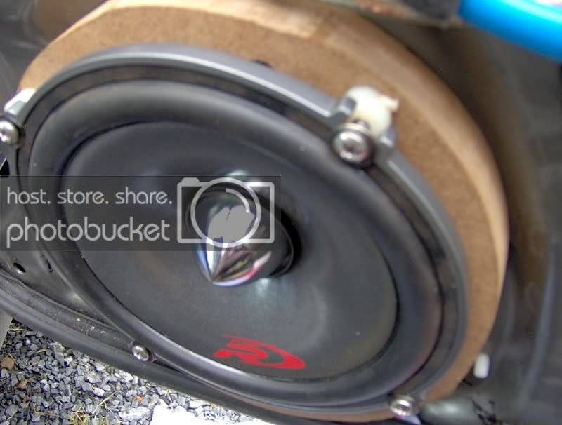

First, try making a form of these. If your having an issue with only one window, I'd say get 1/2" MDF and make ring, I ended up needing nearly 1" to clear my windows.

As for the window clearance problem, my recommendation is do as was also stated above and get some 1/2" MDF and fabricate some spacers for those 6.5's. Build them up until you get the desired clearance inside your door.
