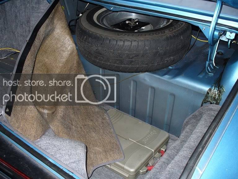

I was hoping I could get some suggestions on what to do. I would like some more bass, but the way the trunk is designed, I don't think a subwoofer would sound very good as there is a lot of metal and a gas tank in between the cabin and where the subwoofer box would sit. I do not think there is enough room for a free-air subwoofer that hangs from the package tray as the spare tire is in the way and even if I were to move it, I don't think there is enough width for even a small subwoofer.

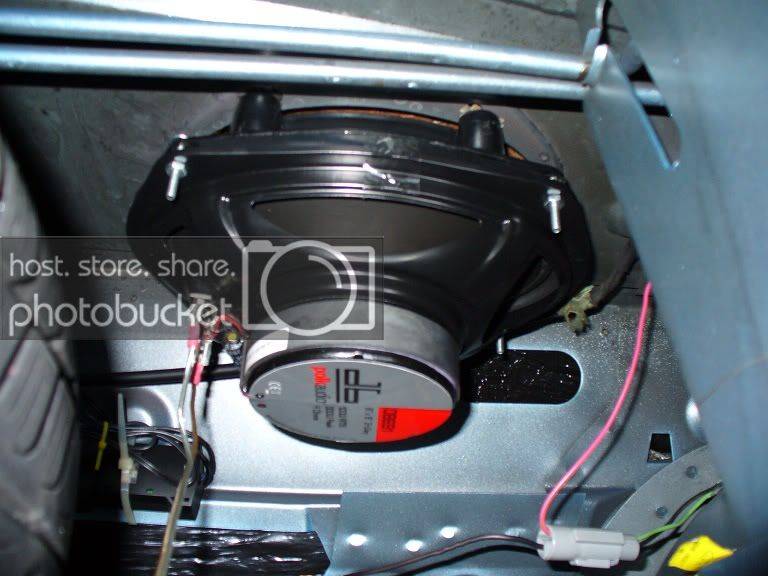

This is the 5x7 mount with the adapter and the Polks installed. I returned those as they did not meet my expectations and compared to my Infinity Reference 6x9s that I had installed in my Electra, they could not play at my listening level with the same amount of bass without bad distortion--The Infinity Kappa 6x9s that I had now can play at higher levels with a good amount of bass. The 24 gallon gas tank sits under that shelf for the spare tire...so I was thinking that putting a box into the trunk might not sound very loud in the cabin...I would rather keep the sound on the inside of the car as much as is possible.
I have mixed feelings about these adapter brackets...The speakers now sit about an inch and a half lower than a 5x7 would and are not sealed. I plan to seal them as I imagine there is some negative/positive air pressure issues there, especially with the lowend (acoustic short circuit as I have read).
I will cut into the package tray and enlarge the openings if I have to...that is if it would make a real noticeable difference, otherwise I will just seal them and see how that sounds.

is that really how the adapter is suppose to work? Can you turn the speaker around so the magnet is going in the direction your cone is in the pictures. Then, come in from the top of the deck to get a better seal? If you can't do that, I would make your own or pay someone to make you just some simple MDF adapters.
AND If you have a decent front stage you can deaden and possibly brace the rear deck and try those 6x9" subwoofers without having a need for midrange or tweets in the back. I have never tried the 6x9" subs, but if you really dont want to put a sub in the trunk it may be your only option.
I say cut the holes and seal it up. Get a good set of components for the front and some 6x9 subs. If you seal your doors and do it right youll have a good front stage (rear is not necessary in this case) and then a nice little low end from the back. I would def try to amp the fronts too

I will seal the things up soon and see what it yields...Cutting will be my last resort. I would prefer if the speakers don't mount from the top as it seems like the grills that are offered nowadays look like ghetto silver spider webs. Yes that is how the adapters are supposed to work. The way they give them to you is less than ideal but I can probably make it work. The car is designed so everything mounts flush, which is probably how that Plymouth was when it rolled off the line-if it even had rear speakers from the factory.
I will snap a picture of the package tray tomorrow so you can see what I am working with. It looks like there is enough room from the top, but when you look at the bottom, the torsion bars for the trunk are located about where I would want a subwoofer to hang.
