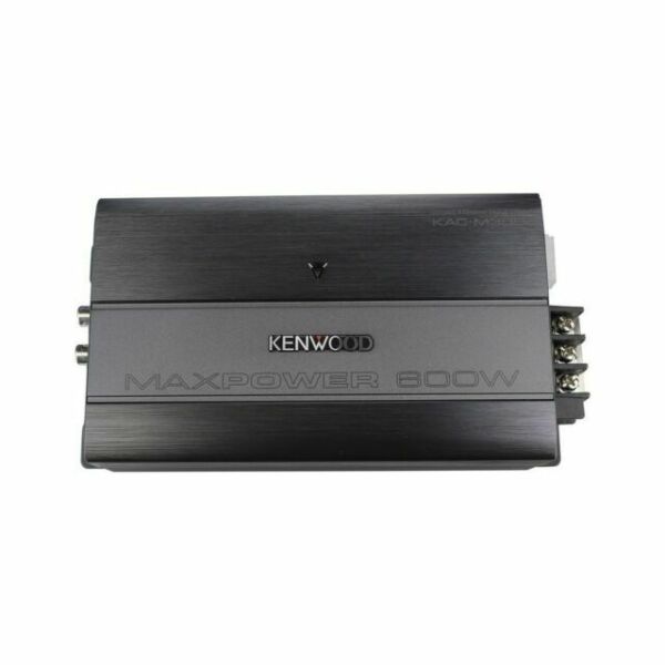

There is a Factory Refurbished Pioneer GM-D8604 4 ch 100W rms amp for sale on Ebay right now for $120 with factory warranty. There is also a few Kenwood KAC mini 4ch factory Kenwood refurb amps for sale. Those Kenwood KAC mini amps put out some killer power on the YouTube bench test. I think it was Big D tested them. Even Crutchfield sells the factory refurbished Kenwood stuff.
