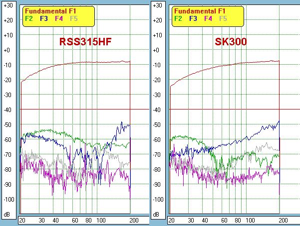

do you realize how BAD 10% distortion is? 10% distortion is absolutely horrible!
I'm not exactly sure on the output level, but I believe it is in the 100-106dB range for both drivers.
-40dB is the 1% distortion mark, -50 is .3%
Both of these drivers are hovering around in the POINT 1 to POINT ZERO 3 percent distortion mark.
Guess what the left driver is? The Dayton RSS315HF (Dayton Reference High Fidelity 12") and it only costs about $130. Your crappy SVS sub that you keep touting has 10% distortion in a very narrow bandwidth at low output levels...the SVS sub sucks!

Like I said the b&w has over 20% distortion at anything below 30 hertz at almost any output level while the svs has below 10% at 95 db and 20 hertz and lower.
I don't run svs, My sub puts the dayton to shame //content.invisioncic.com/y282845/emoticons/laugh.gif.48439b2acf2cfca21620f01e7f77d1e4.gif
The B&W has at least usable output, albeit in the upper bass. The SVS on the other hand has no usable output (anything I'd settle for anyway).
Ahahah, for the money I highly doubt your TC sounds would beat the Dayton as far as distortion. I'm actually willing to put money on it, the RSS390HF would easily trounce your TC2000 from 50-200hz. The TC may beat a 12" Dayton in output, but just buy another one...hell they only cost a little over $100.
