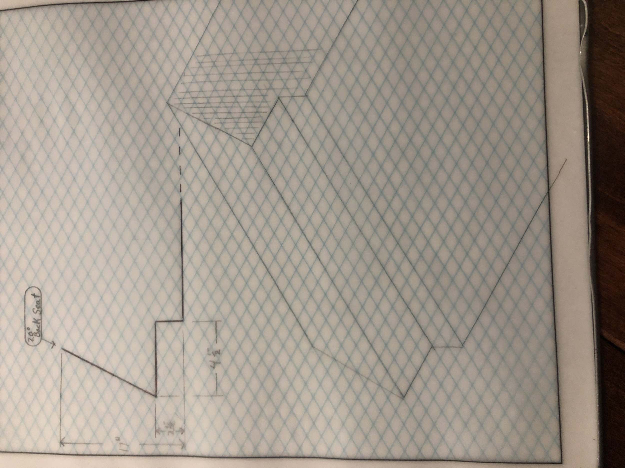

I just picked up a new subwoofer. Audiofrog has a few recommended box designs that they suggest. I’m hoping to save some space by compensating for the angle of the backseat, the structural support lip below that, and possibly increasing the height to make use of all the vertical trunk space.
I’m going to include a simple drawing of the cavity I’ll be coping the rear of the box too.

Original design specs 1.5 cubic feet, PD 4”, PL 16”
If I keep these dimensions without placing the port to close to the woofer should everything perform the same?
Should I just go sealed, save space and sacrifice a bit of volume.

Should I just go sealed, save space and sacrifice a bit of volume.View attachment 23657
It would sound the same assuming everything was done correctly. If I went ported I’d tune it around 38 hz since the trunks I’ve always had really boost the lowest frequencies. If you could fit a single 4 inch aero port facing the back like the sub that would work well. I would personally go sealed in a trunk like that because ported tuned to 33hz will mostly give you extra output in the lower freq and trunks already boost those and tend to filter out higher bass frequencies so you would be possibly left with a real low end monster setup just for a few db’s in the lowest frequencies...better have a bass knob because you will not be able to hear sub on the upper bass notes like many kick drums and bass guitars but when a 30-40 hz hip hop tone comes in it will rattle you head off.
