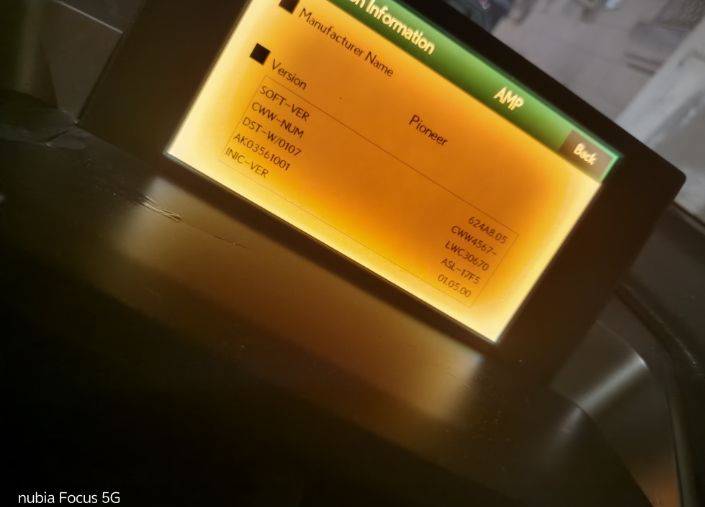

hi, I am facing an issue with my car's audio display screen which is getting dimmer gradually. the attached image was taken almost last year as currently screen is too dark one can't even read the information. I am a kind of a person who always trying to fix before replacement so, I would like to have an advice/guidance from expertise or anyone who expected the same and fixed it. moreover I do have further issues with my car's head unit which can be discuss if requires. thank you!

Most cost effective thing you can do is open it and get the model number of the actual screen and check if you can find it online. Most of these are screwed on and plugged via ribbon cable.
Second method is to replace it with an Android unit that is most often times plug&play if you search by the provided information.
Third option is to buy a used one and see if it plays out the box. If not then scavenge the screen off it.
If you shine a flashlight towards it from the side, are you able to make out any of the info on there? Sometimes LCD screens can be read without their backlight that way.
If so, try going into the settings and adjusting screen brightness/contrast/etc, to see if you can affect it at all.
Could be failing edge lighting, failing power to the lighting. Could also be the circuit that turns the pixels on and off.
As 1Esp said, you may be looking at replacing the whole display, if you can troubleshoot it to that point.
