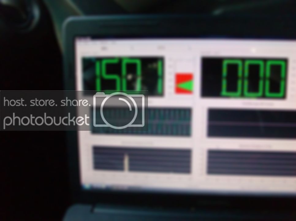

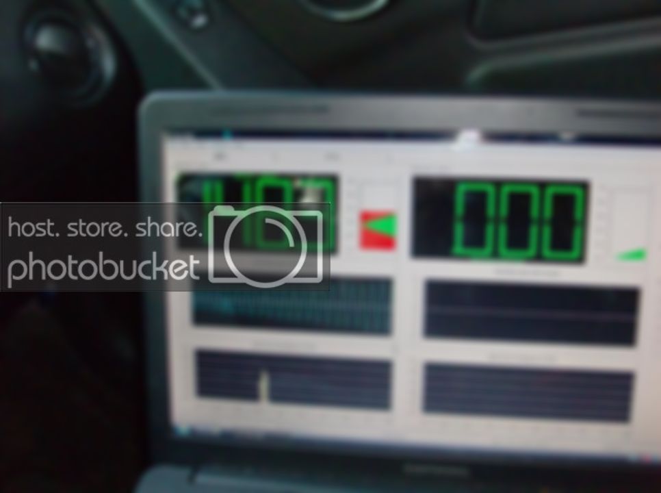

Well had a pretty interesting day.
2 amps strapped at 2 ohm 149.2:crap: re wire them to .25 apiece roll into a 150.7 and pulled the spider ring off the landing:crap:
Since it came off so cleanly( lack of glue on spider landing, my fault) I centered and re glued it.//content.invisioncic.com/y282845/emoticons/biggrin.gif.d71a5d36fcbab170f2364c9f2e3946cb.gif Back in the box it goes.
Pulled the 2nd amp and pushed the box back.
Test with 1 5k at .5 trunk un sealed
Test with same settings trunk sealed this time
Looks like box centered pushed as far back as possible and sealed is the loudest for my GP. //content.invisioncic.com/y282845/emoticons/cool.gif.3bcaf8f141236c00f8044d07150e34f7.gif
Final stages and a permanent seal job ( has shown to gain .5-.8) under way next.

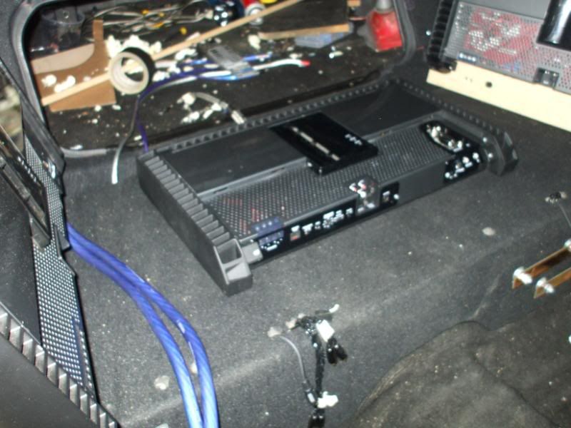

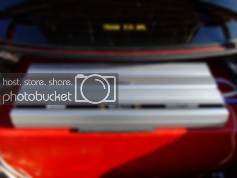

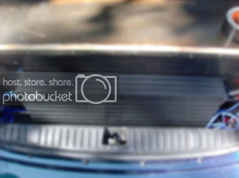

new addition. so far i am extremely pleased with this amp. only had it for today but its beatin the sh*t outta my hd's. //content.invisioncic.com/y282845/emoticons/thumbsup.gif.3287b36ca96645a13a43aff531f37f02.gif

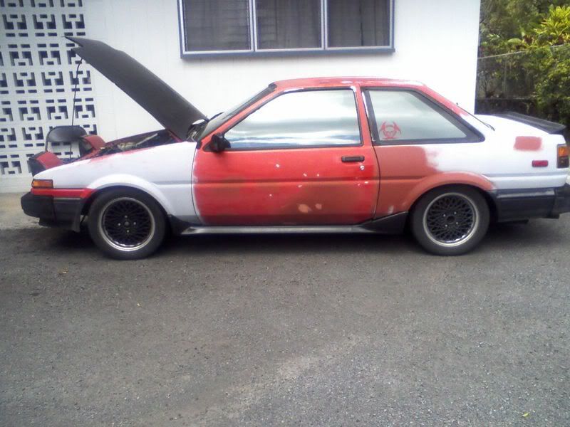

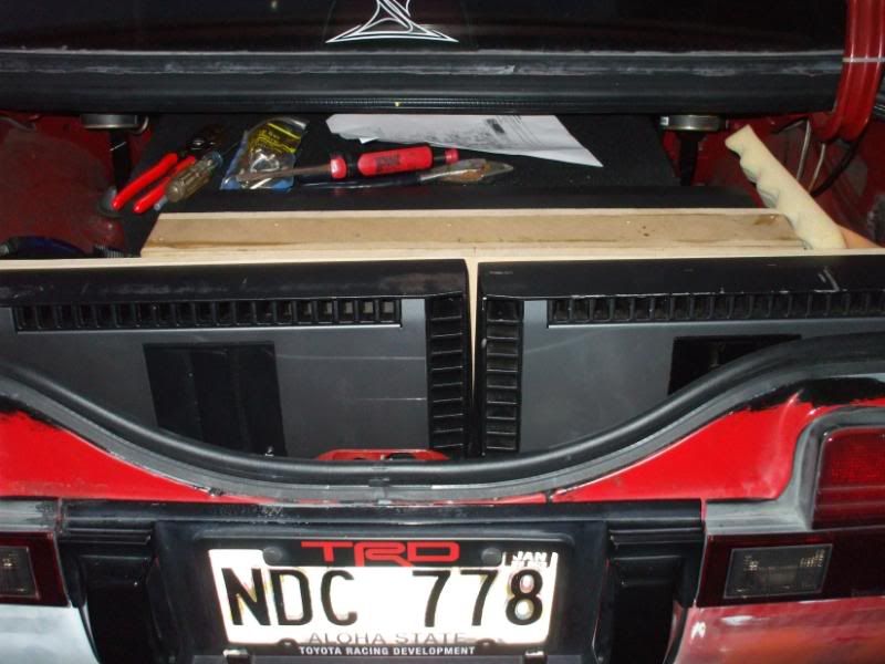

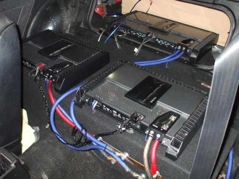

currently, my car..1986 toyota corolla coupe
had (2) Rockford fosgate T10001bd's synced...
but was too much of a squeez to fit them and a T8004 also.
so gave up rear seat...and made a platform to mount amps..

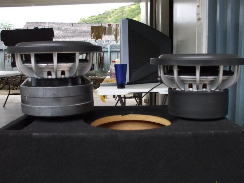

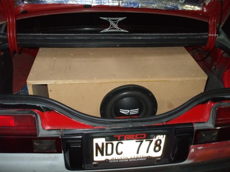

then upgraded from a single 10" RE sx to a MT
daily box tuned to 37Hz,around 2 cubes...
then upgraded to (2) T20001bds..T8004 on the left,master in middle,and slave on the right
also got (2) kinetik HC2000's under the platform
with a 360.1 in the car, highest during testing we got was a 143.2...
switched to a 360.2,gains all the way down, 143 flat @44Hz, still gotta tuned for comp. coming up, number should go up a little, also wanna try a fart box....
sorry for the long post guys..will do a build log soon.

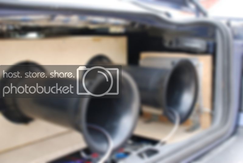

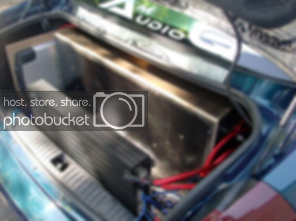

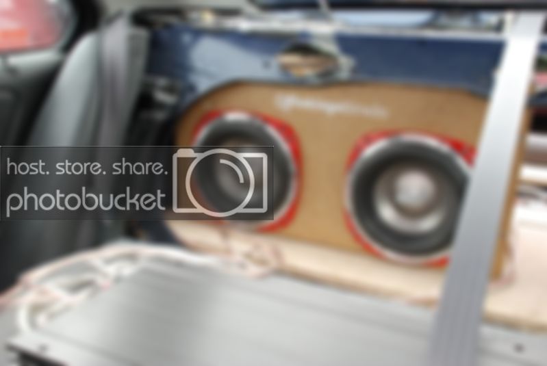

Volvo s60 2001 trunk setup... 148.3 @ home.... local comp 147.2
me putting the charger on
oh sweet sweet 10s

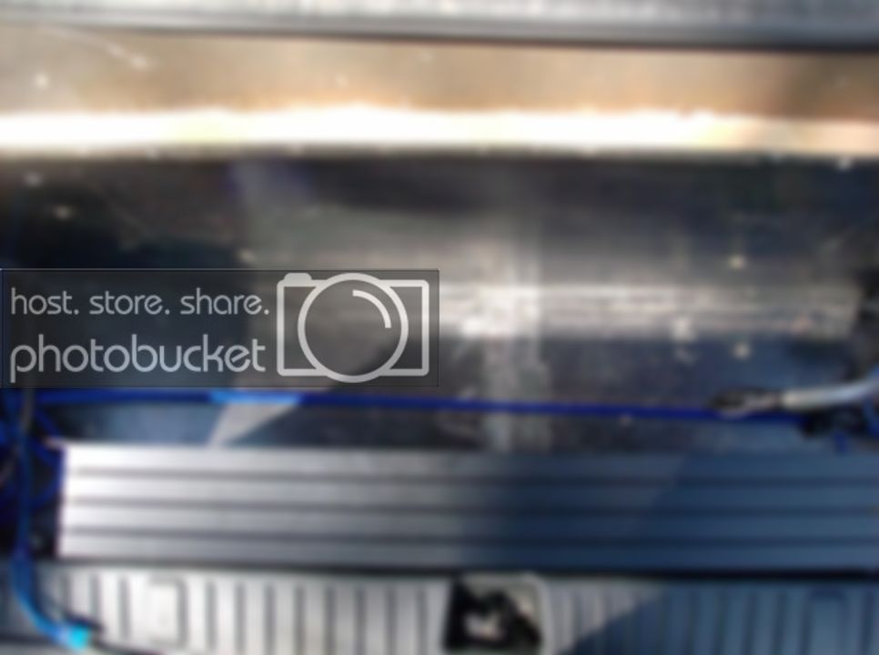

Did these results with a GZPA 6500.1 , sold the amp a few weeks back and got a SounDigital 8000.1 now...
7 maxxima 900 batteries will be enuff i hope //content.invisioncic.com/y282845/emoticons/rolleyes.gif.c1fef805e9d1464d377451cd5bc18bfb.gif
150+ soon? //content.invisioncic.com/y282845/emoticons/tongue.gif.6130eb82179565f6db8d26d6001dcd24.gif
Since im competing in ESPL 2woofers atm i cant seal the car up (no foam), but after swedish finals im hopeing 150+ woofer and port firing forward seal'd

oh sweet sweet 10s
Sweet! Very impressive numbers for a pr of 10's I just love that saying:laugh:
10's FTMFW:cool:
