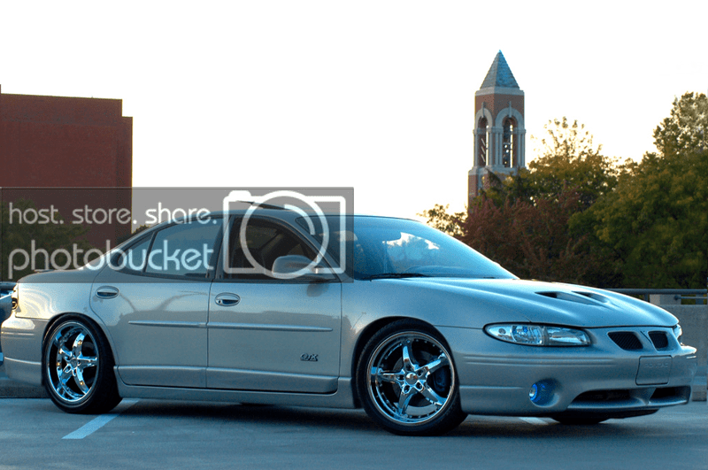

springs are in and its all even'd out
what size rims and are those bbs wheels
