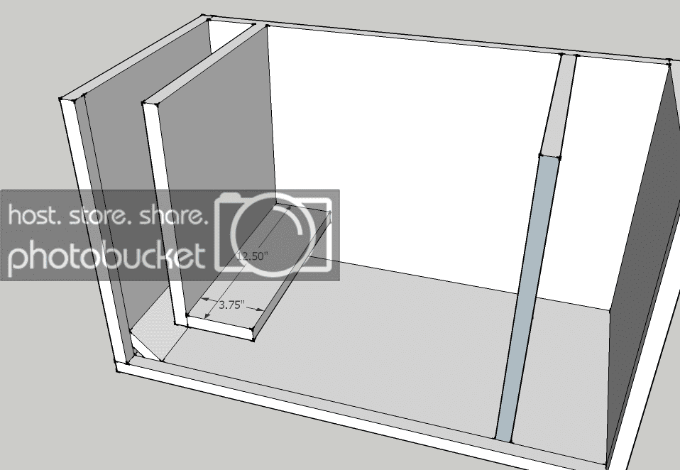

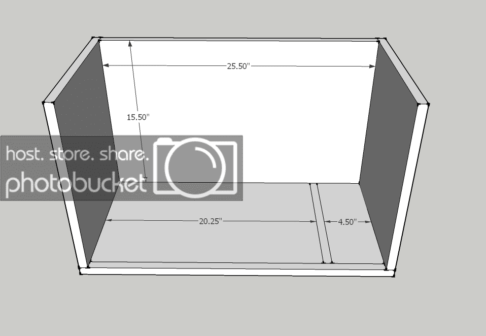

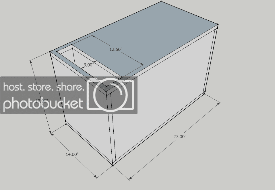

I got an e8 in a 4th order bandpass on 300w rms and when I try to play mid 30s, or low 30s it sounds like its bottoming out. I turn it down a bit to where it doesnt do it anymore, what could it be?
I think it is a little too big to be honest, but the sealed chamber isnt really sealed up 100% yet, where I ran the wires through its loosing alot of back pressure as I dont have any caulk right now to fix it.
Heres a video though.
I suggest no more than 0.3 sealed.
