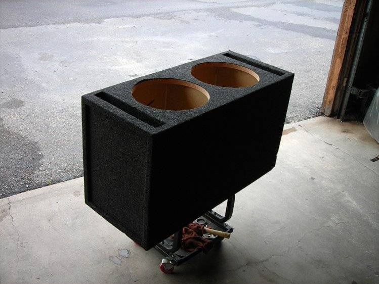

Here it is..... Tell me what you guy's think.... Not bad for $95 w/shipping
I agree Atrend Boxes are sick, best pre-fabs around. That enclosure is an Atrend TDXT enclosure and it is specific for diamond audio subs. If its the 12TDXD then I believe it tuned to 38 Hz and if its the 10TDXD its tuned to 44 Hz. However i'm not sure if thats the best enclosure for your Type R sub. It really depends on what gen Type R you have because I know that the new 4th gen Type R is shallower and only has about a 5-6 mounting depth and requires less cu. ft. I have had the opportunity to hear a single Type R sub in an Atrend 10LSV and it pounded. Not only did it shake the ground the sub didn't skip a beat, it picked up every frequency.
atrendusa.com

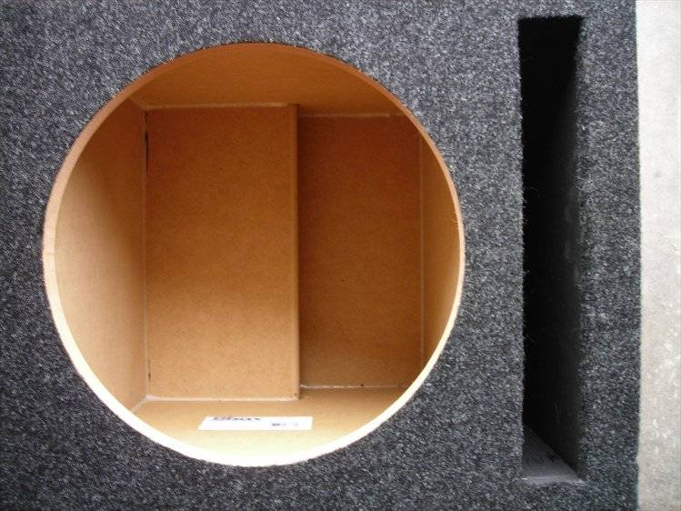

Pre-fabs always wrap maybe 2 inches into the port and the one I had it caused a little turbulence. It looks like this one has that.
It does, I'll trim it though. The carpet isn't glued down that well thats for sure. I noticed the port was coming unglued and if you look really close the left driver hole's crpet is pealed,. Dosn't mater though since the sub's will pinch that. Then again it was sitting in my garage for 3 days were it was in the mid to upper 90's with like 65-80% humidity. I can just see the carpet flapping and fraying at the port though if I left it like it is.

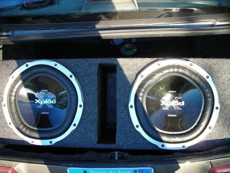

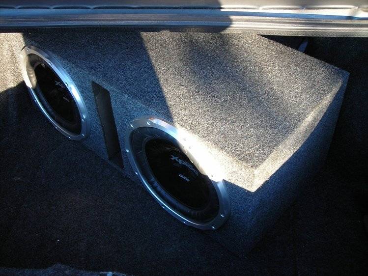

heres my other alternative, I bought it at a pawn shop like 3yrs ago for $75... I know my new box will blow this POS out of the water and to the moon.
B4 captain obvious (whoever that maybe, every forum has one) chimes in.
Yes I know my ground cable is too long and yes my deck speakers are just sitting there, and my subs are missing two screws, and there a CD in my trunk and that sony is over rated crap and the box is a POS... There, I think that covers everything //content.invisioncic.com/y282845/emoticons/smile.gif.1ebc41e1811405b213edfc4622c41e27.gif...
