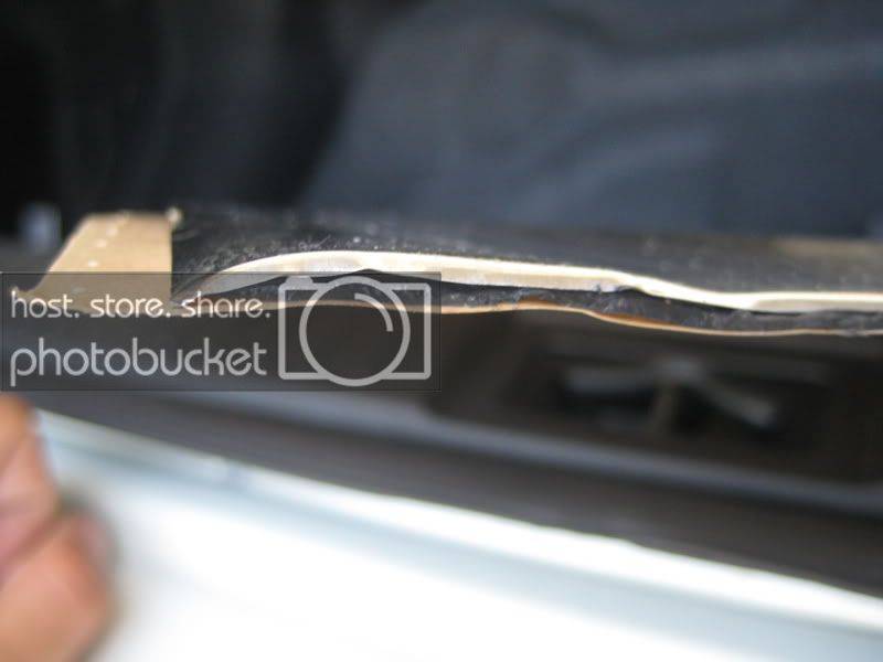

First off, I have used Second Skin before, but never Damplifier Pro. I had high expectations, because I already know how well Second Skin's products work. There is a noticeable difference by looking at Damplifier Pro and comparing it with Damplifier and other deadeners, it is much thicker. Take a look.

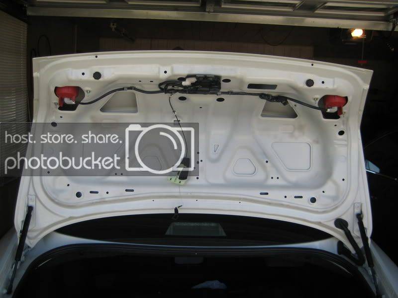

I decided to use it on the trunk lid because I had a thing for deadening my Accord with layers upon layers of deadener. Here is a before shot:

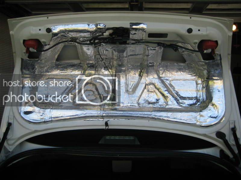

The door pack came with 8 sheets, and with 4 of them I was able to do nearly the entire outer shell of the trunk lid.

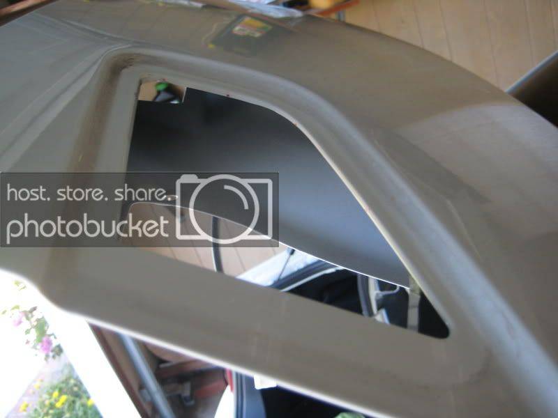

As with the Accord, I decided to take it a step further and went ahead and put deadener on the inner shell of the trunk lid. Originally I was intending on using expanding foam but I decided it may be too much trouble. It made it easier to take out the tail lights and the trunk latch. I was able to use the roller more and the butt end of a screw driver along with my hands to secure the deadener in hard to get places.

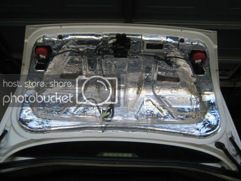

Here is the completed result with one layer. I will be using Damplifier Pro without a doubt for the rest of my vehicle. It's less work to do and costwise it is the same when compared to Damplifier and putting the same amount.

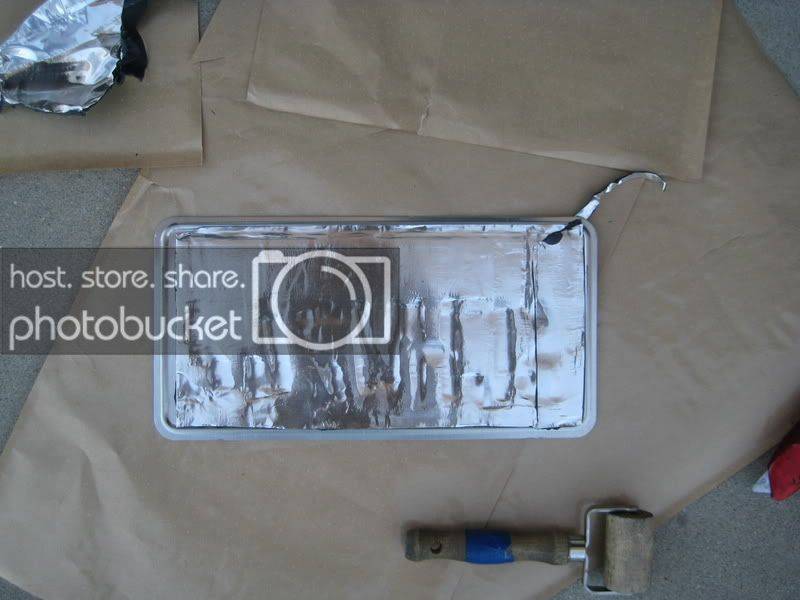

I also did the license plate.
