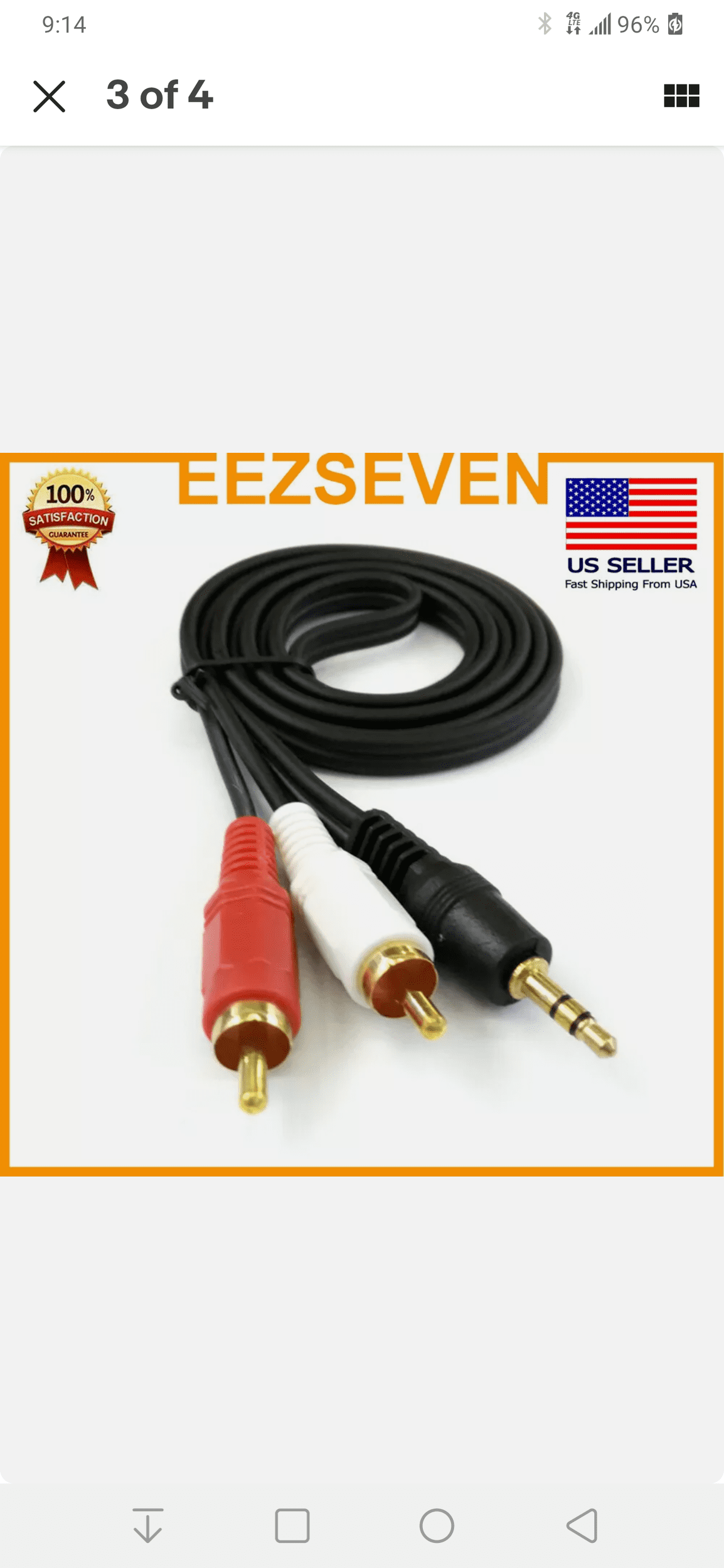

In that case, unplug rcas from amp and hit it with a hair dryer. If static persists, connect an alternate music source. I recommend an 3.5mm to rca adapter which can be found at Walmart or Bestbuy, and connect your phone to the amp for testing.
