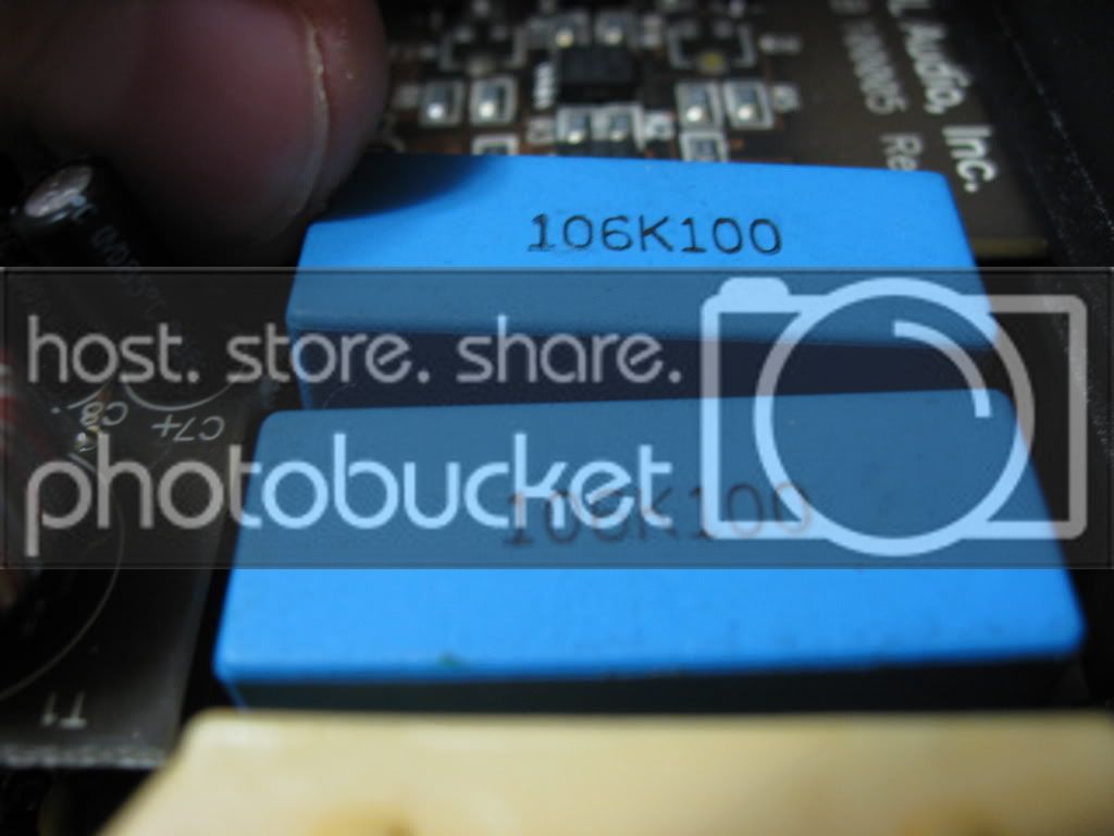

if thats so take the cover off the amp and pinpoint the sound
think we found the problem
That part seems to have come loose during shipping. He bought it on eGay, and the douche put it in a big box, and wrapped it in the little bubble wrap once, so the amp was probably tumbling around for its whole journey.
