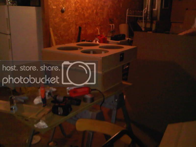

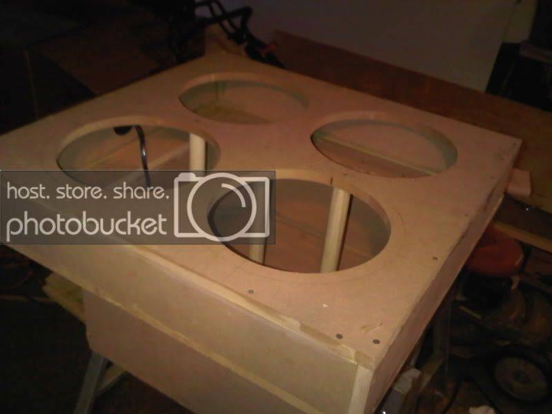

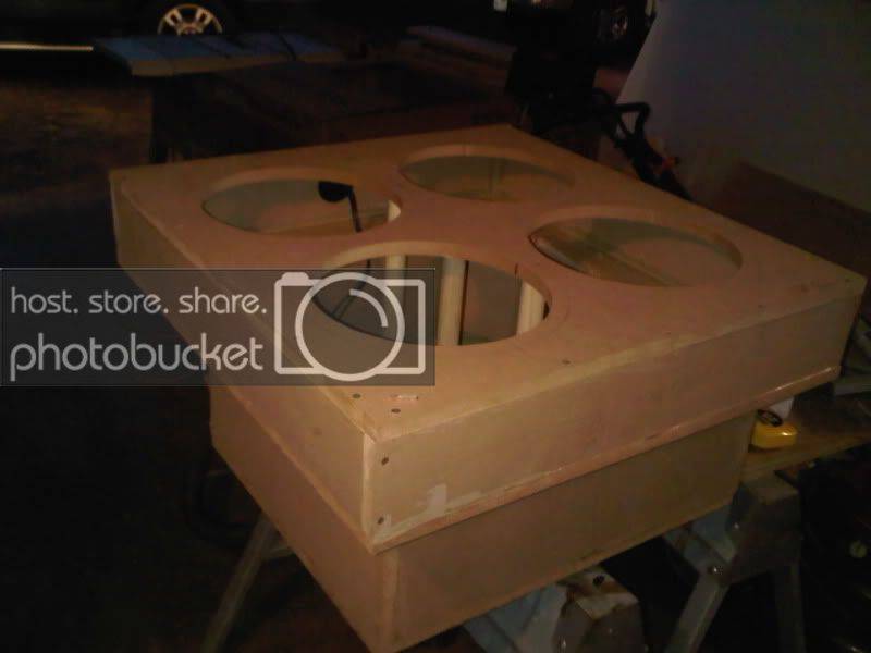

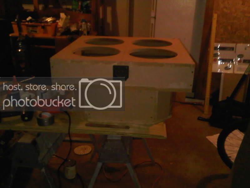

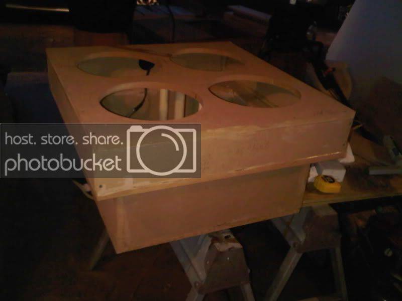

thanks man... fastest box I've ever built. Still needs a good sanding and a finish but the guy who I built it for is happy. It was kind of a puzzle putting it together so I could screw and glue everything I needed to. I wouldnt do the "stepped" thing for ported boxes as it would probably cause loading issues, this one was about 3.6 cubes sealed.
