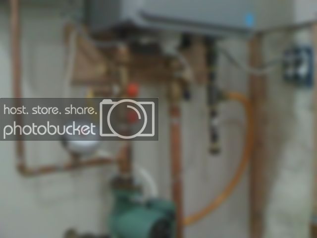

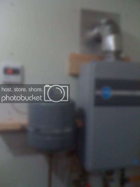

I just got the Tankless water heater installed for my slab heat in my new garage, and Its throwing an error code at me, Its either s1 or 51 i believe.. I THINK it had something to do with the pressure of the water antifreeze mix not getting circulated fast enough, as the pilot will stay lit for about 20-30 minutes and then die out.. Any ideas>?

With all that construction there, I bet it has a low air flow sensor tripped. Check for a filter and clean it.
Pulled out and cleaned some filter that was tied into the water line , some must have gotten into the pipes in the ground, but I bled it pretty good..
