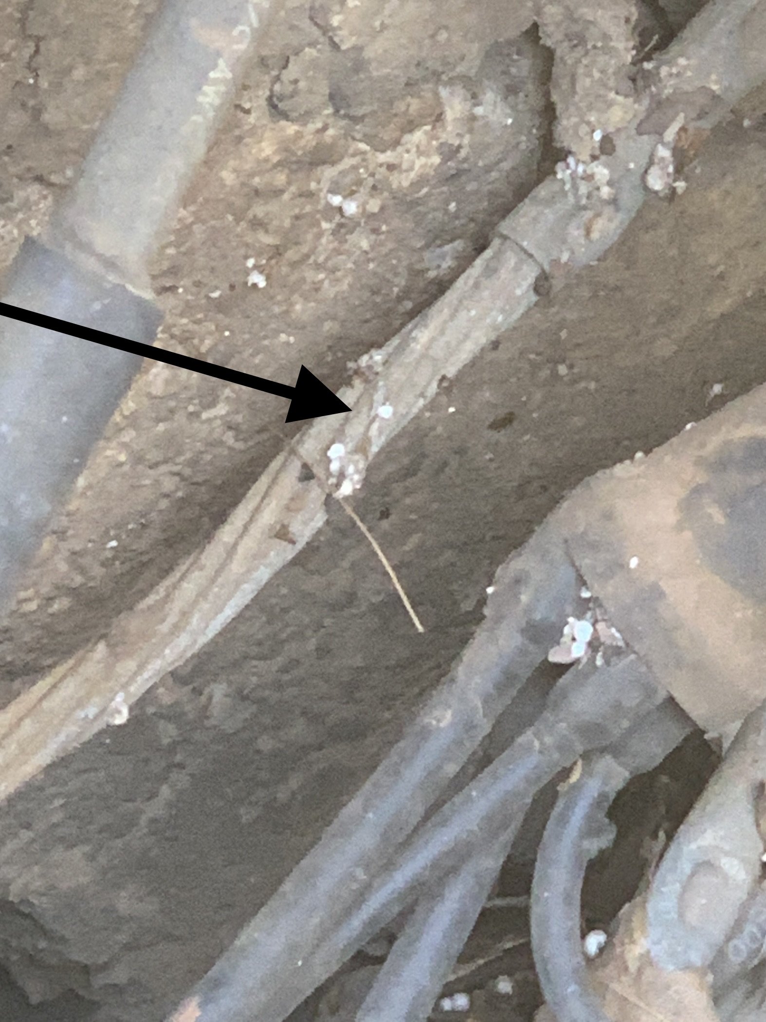

100% and the way around that is by going with tinned copper. The tin protects it and it protects it very well! I see dual 4/0 neutrals cables all day that are bare with no insulation on them but are just tinned. The 500 mcm cables are insulated so they aren’t tinned. Those tinned 4/0 cables hold up amazingly! Tomorrow I’ll see if I can snap a few pics of them and show you guys. These are in structures underground that have water, salt, oil, fuel, you name it constantly sitting on these cables and it eventually drying and then happening again. In car audio though, welding cable is no doubt the best deal hands down! I’ve been looking but so far can’t find any tinned copper welding cable. I did find nice tinned ofc from knuconcepts but it’s about $1.40 ish more per foot in 1/0 ga then the welding cables I’ve found.
Bare cable shown with the arrow pointing to it is tinned 4/0 copper about 30+ years old. That oxidation, dirt, and some salt you see on it is about as bad as it gets. The only time it will burn and fail is if it comes in contact with a live phase or something else starts burning from shorting out.
Oh hell Yea, neutral wire is nuts man! I wasn't aware you could get that stuff with insulation on it. I mean, it's a nightmare to work with, but you can tow a semi with that 4/0 and it will probably carry 600a a solid 50' without drop.
