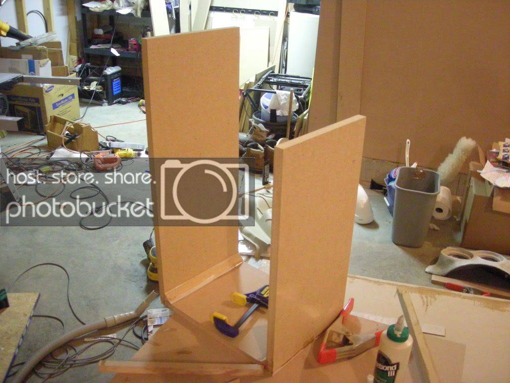

Just started another enclosure for another fellow saturn-driver, this one will be 2 cubic feet per sub, tuned to 32Hz and painted matte black.

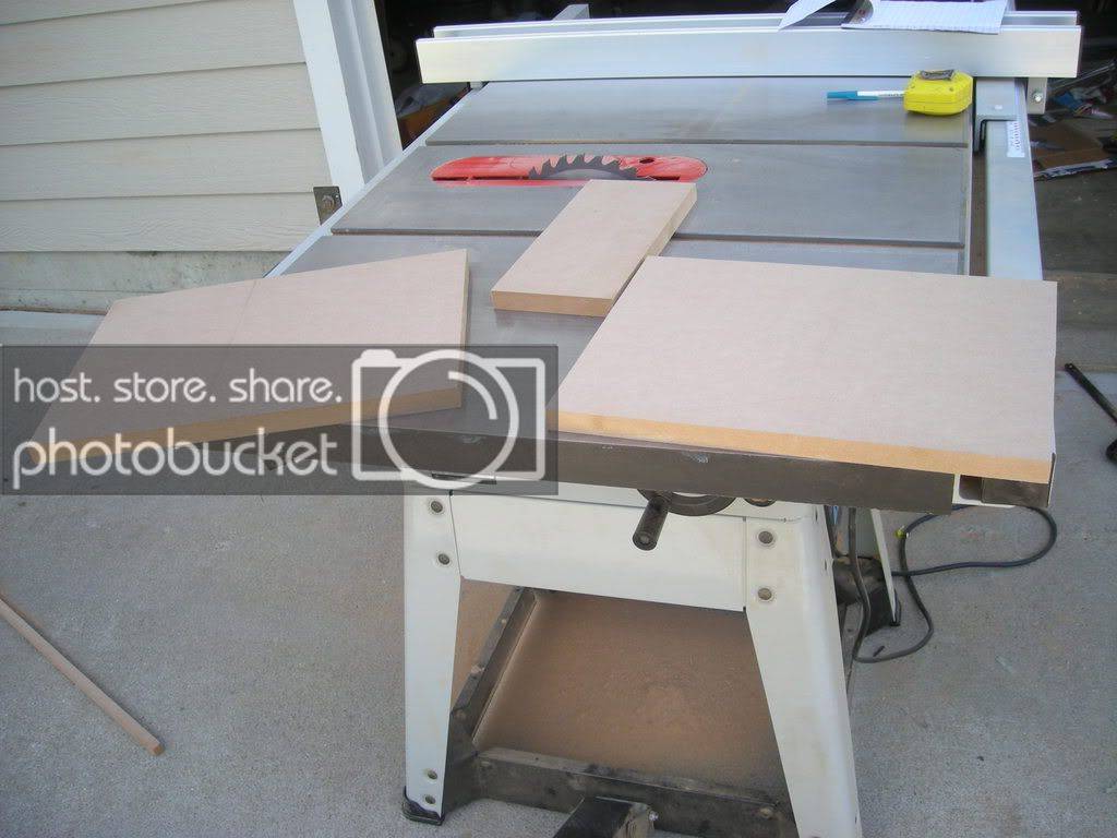

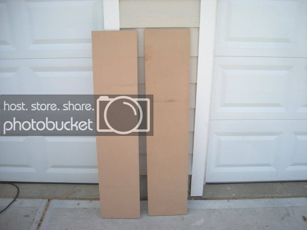

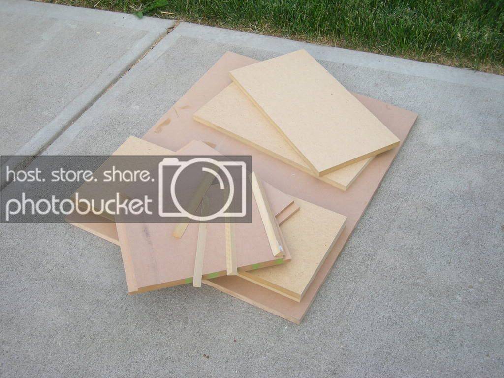

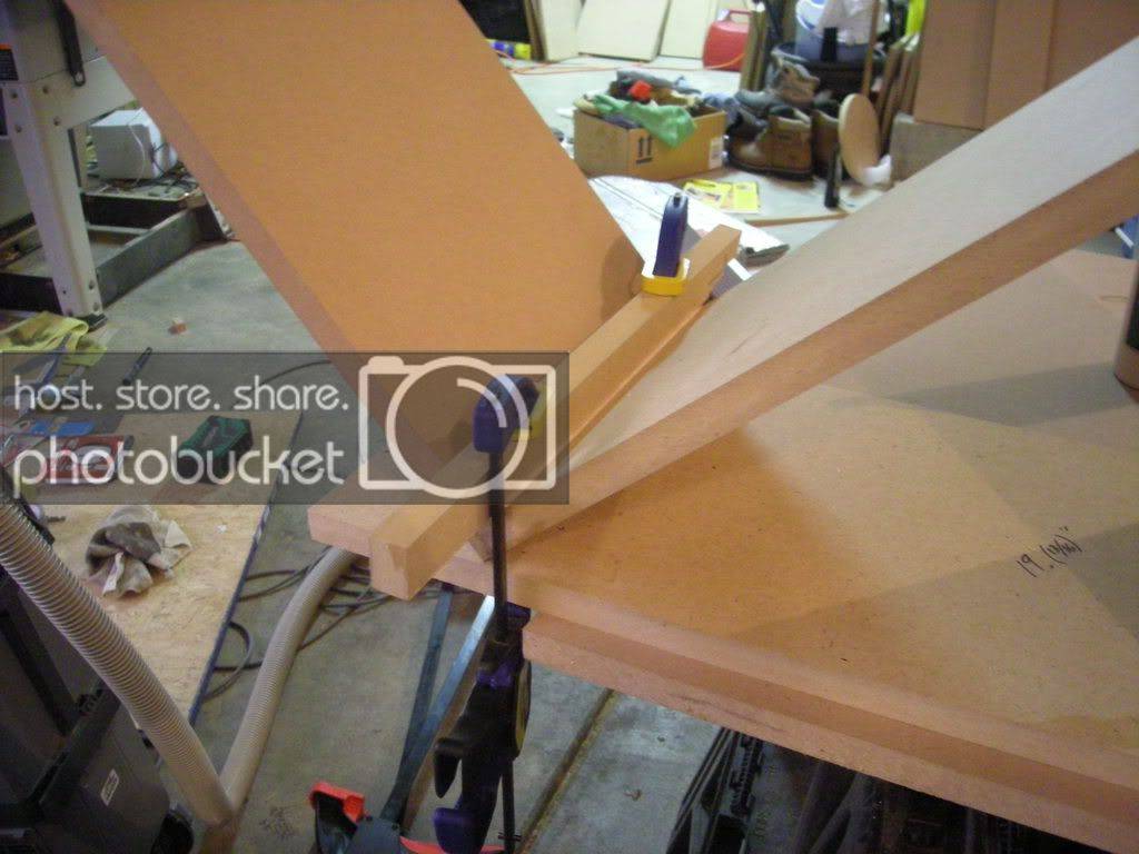

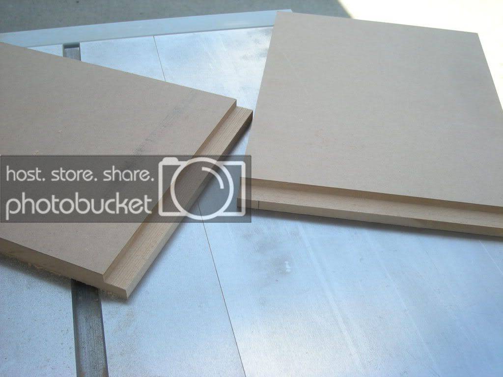

I got all of the pieces cut today, rabbited the edges of every corner of the front and back plate instead of just the front face where it connects to the port walls. Also got the 45 degree angle pieces cut for the corners like the last one.
Here's some pics from today..

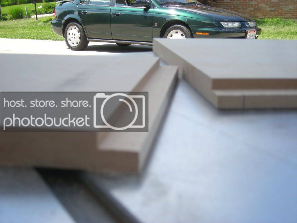

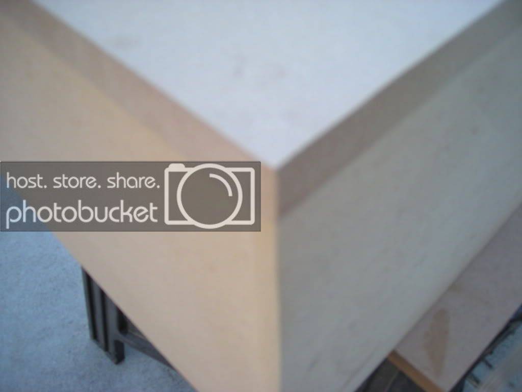

Rabbited edges..
^a rare glimpse of the saturn in its natural habitat...look how free it roams about..

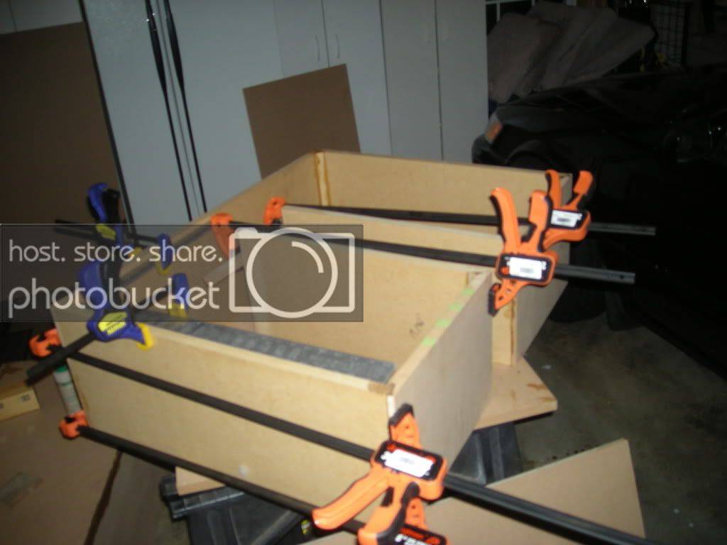

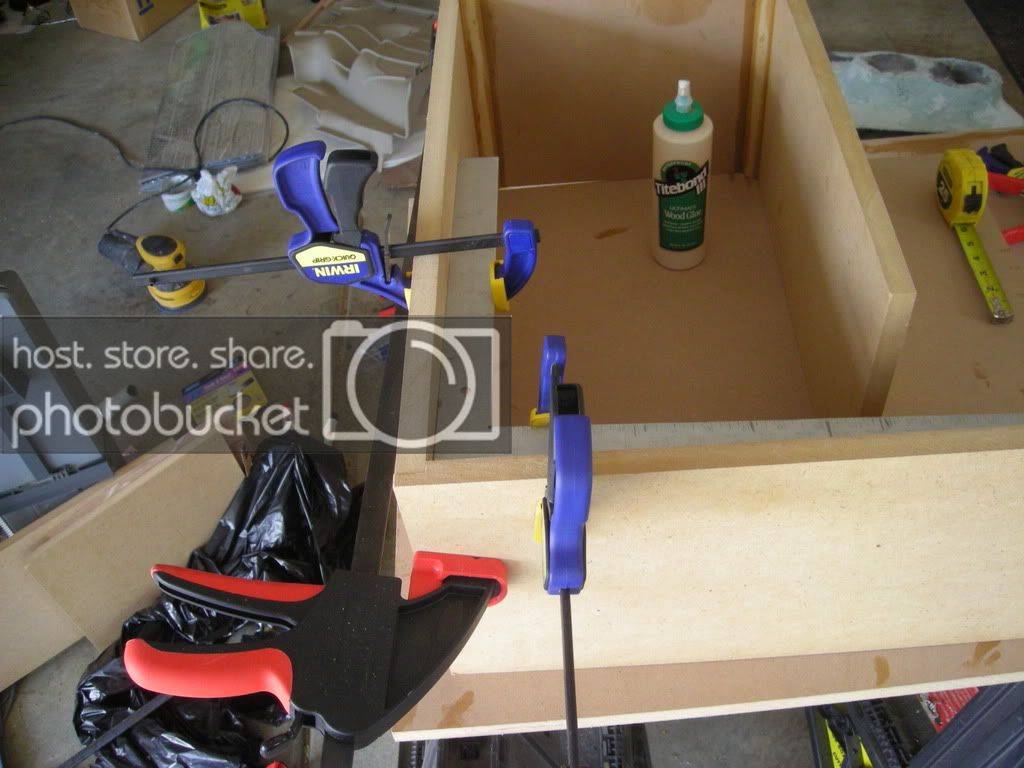

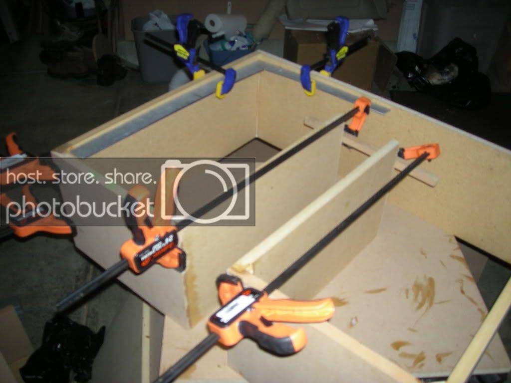

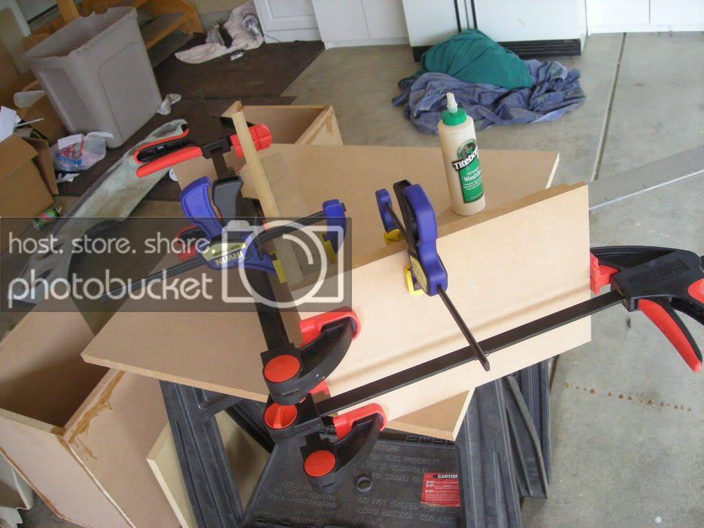

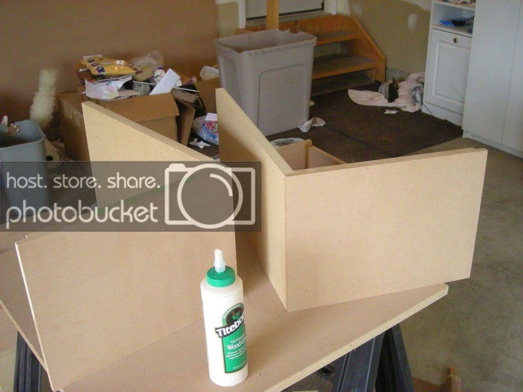

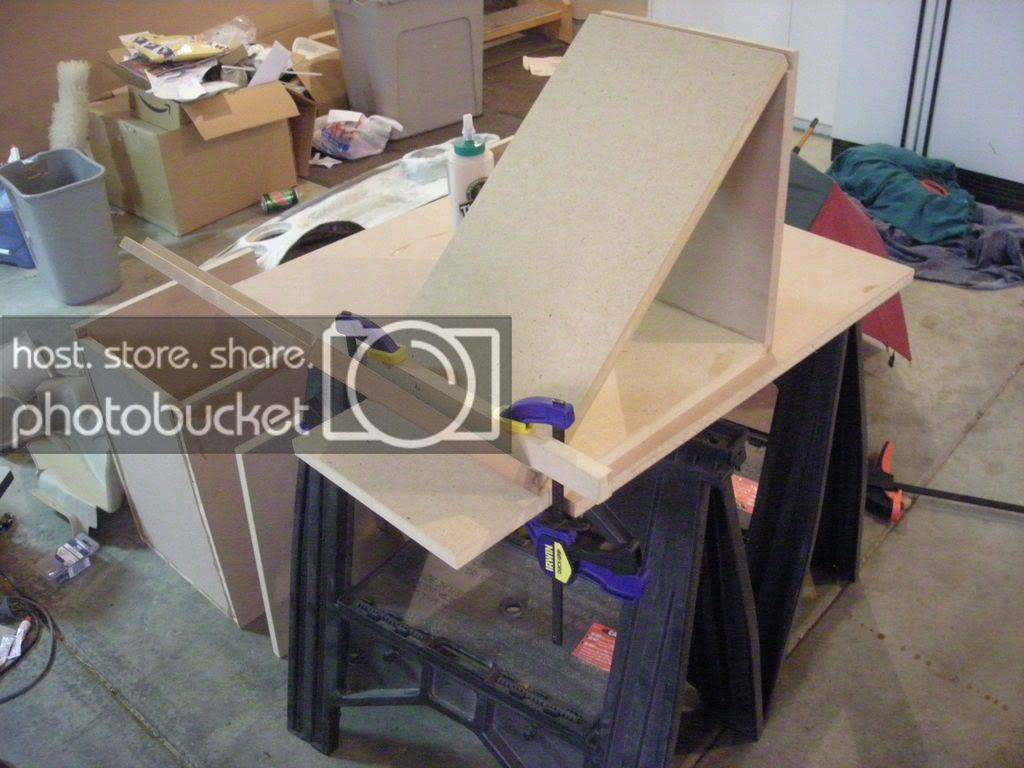

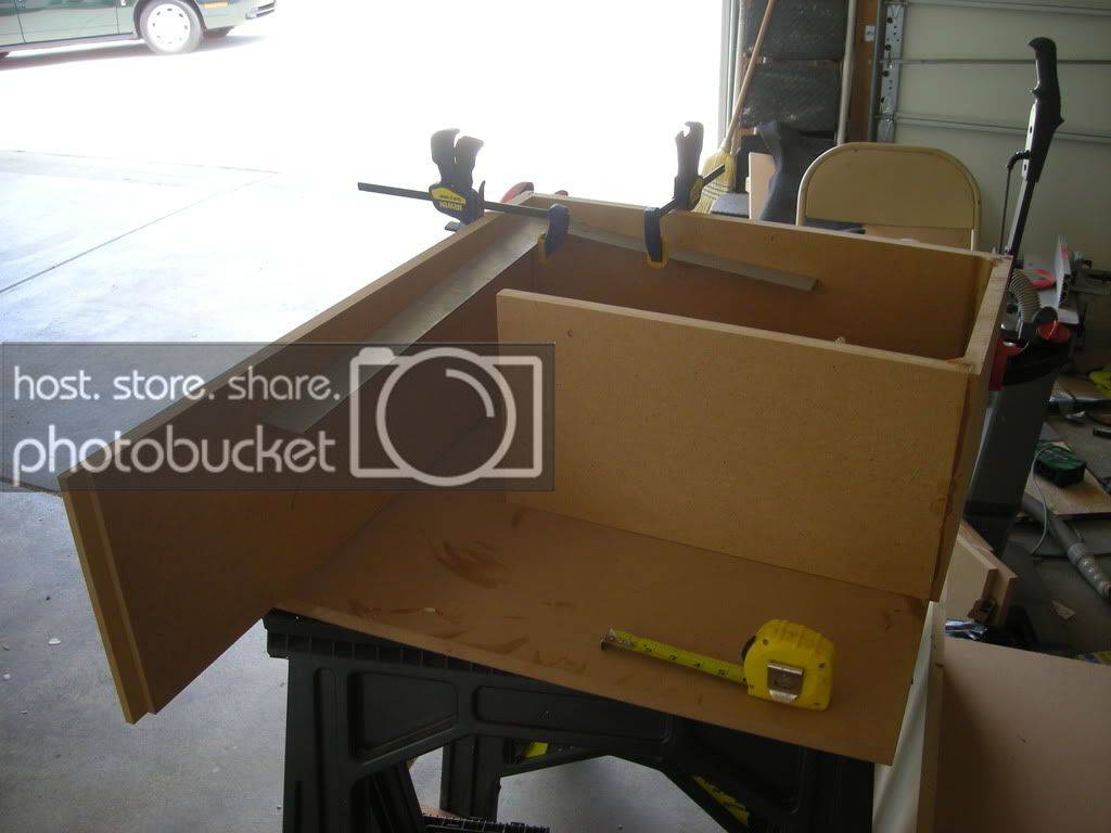

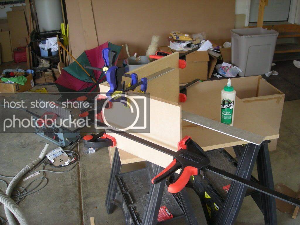

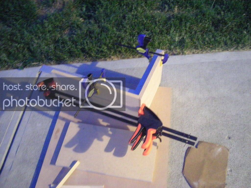

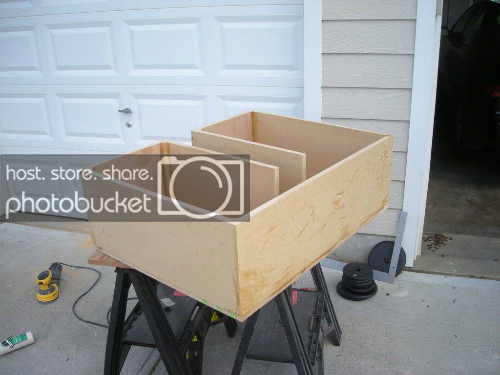

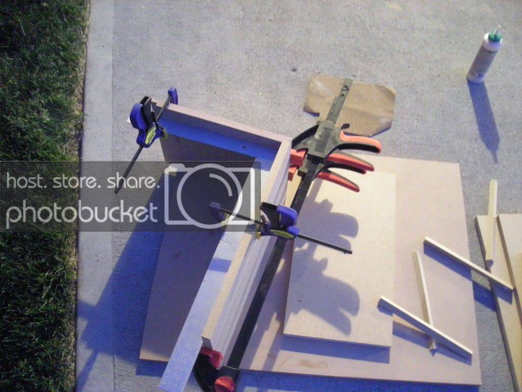

Clamping the port wall and part of front face together and squared up with square clamped onto them..

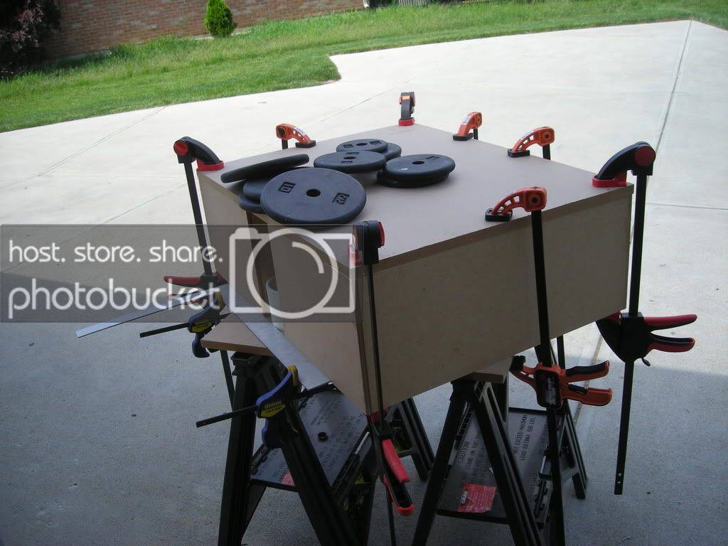

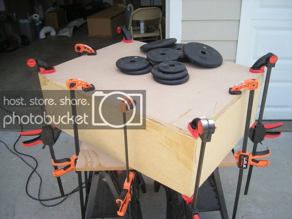

Clamped and set...Titebond III...only the best...

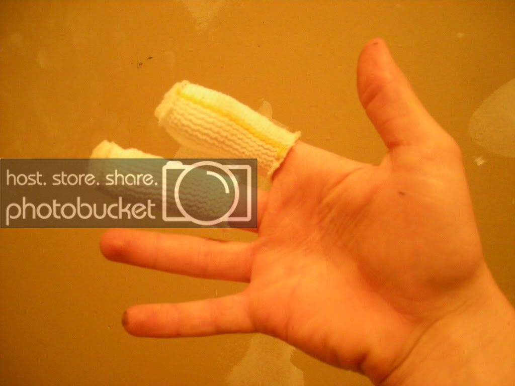

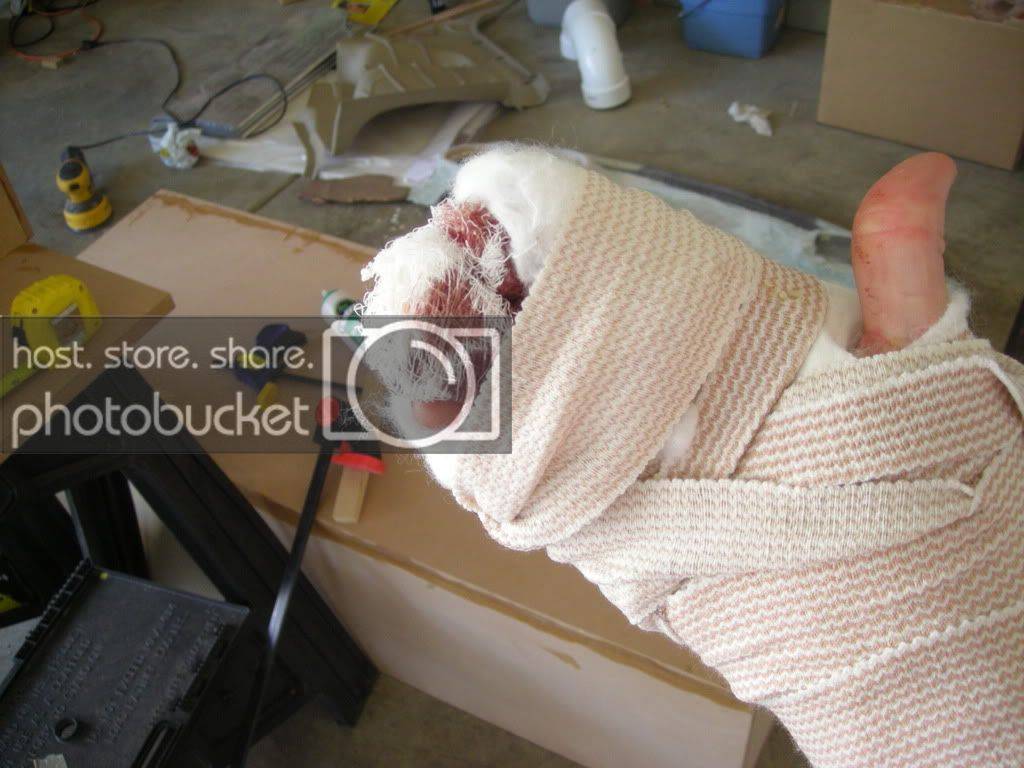

I then cut my hand on another project using a jointer...stupid mistake and was my fault...was trimming down a small piece of wood (too small) and it slipped...lost .5" off my pointer finger and .25" off my middle finger (right hand)..
I was a bit shakin up from this but i'll live, just kinda sux..

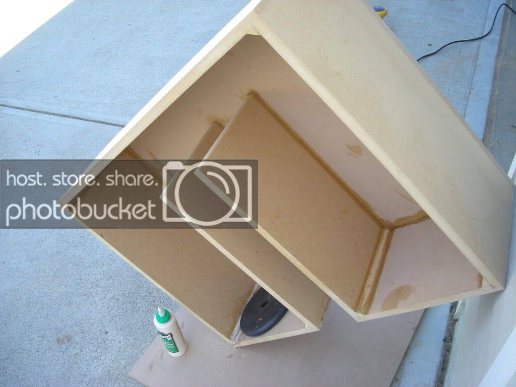

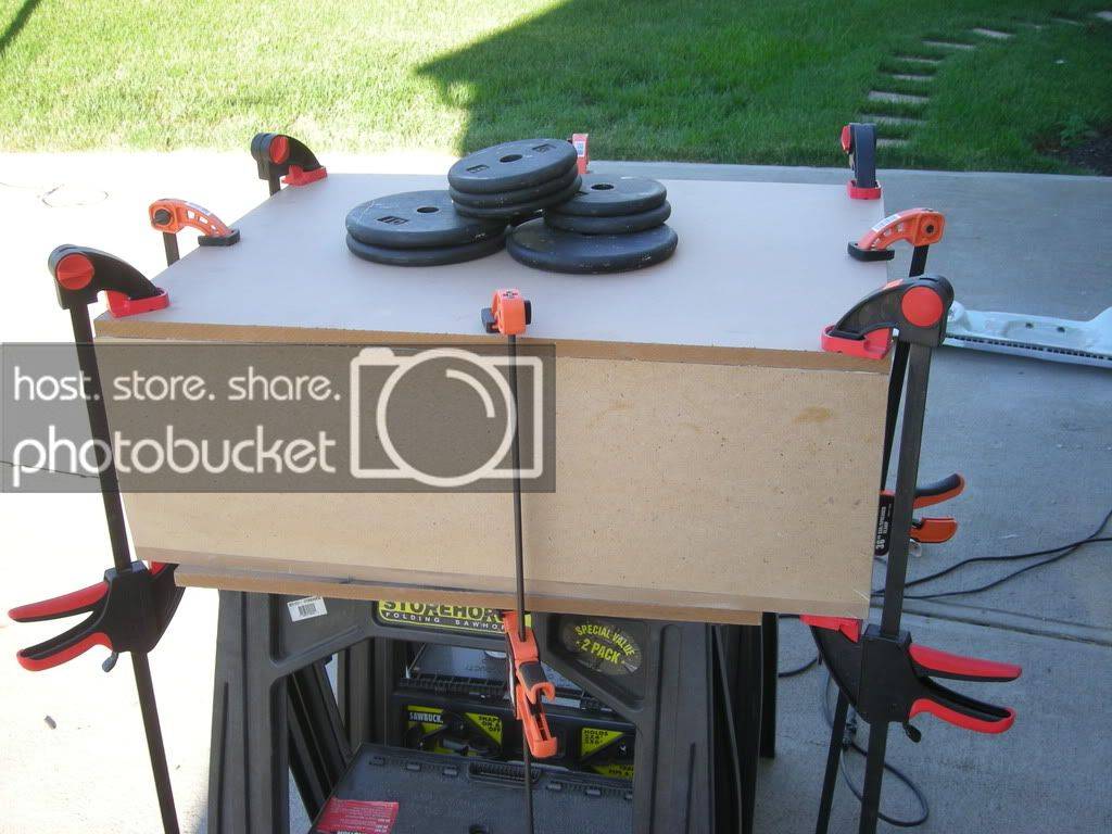

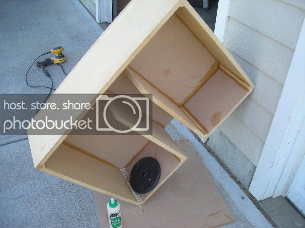

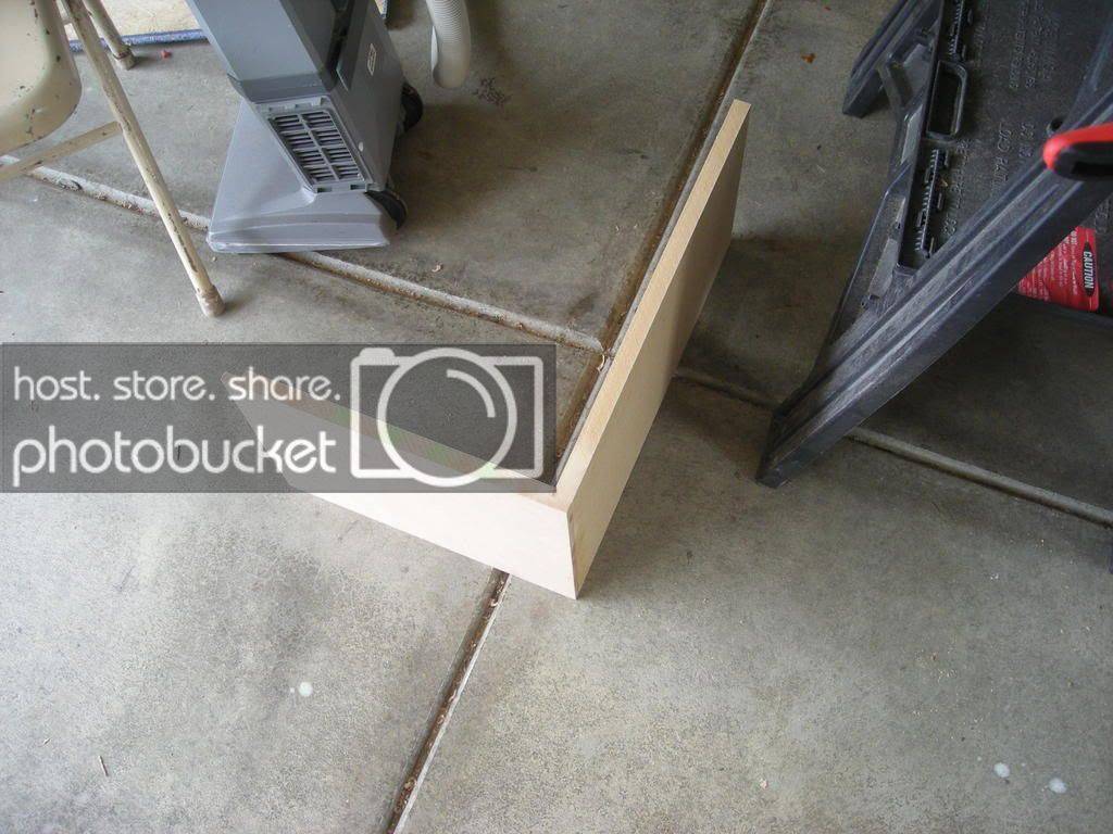

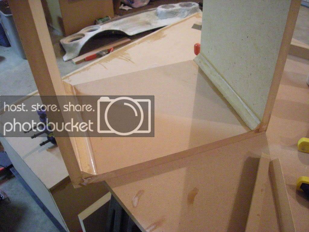

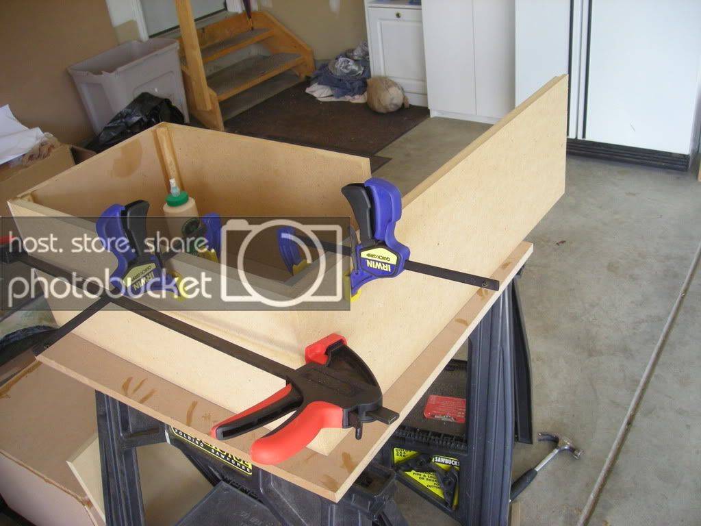

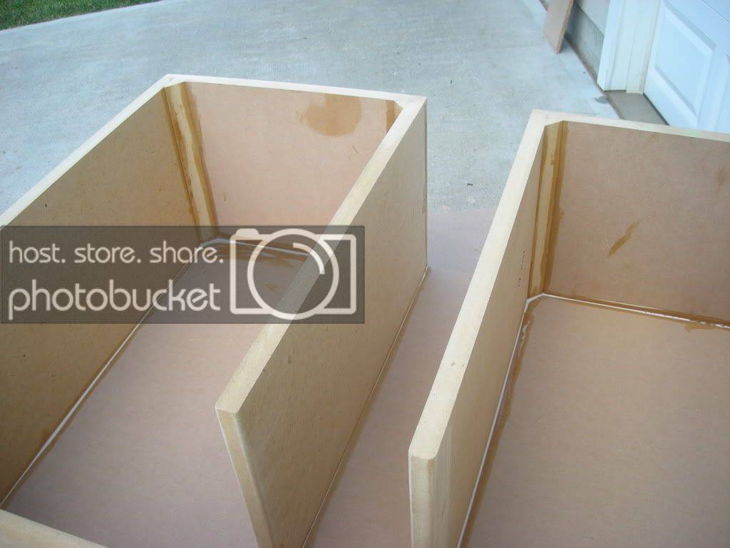

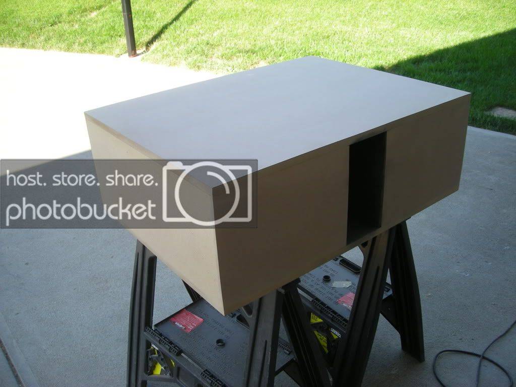

Bringing it together..
Inside..
Sanded smooth the outside and most of the spots on the inside that had glue wiped on it..

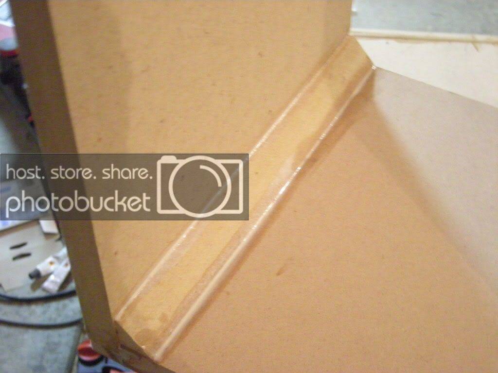

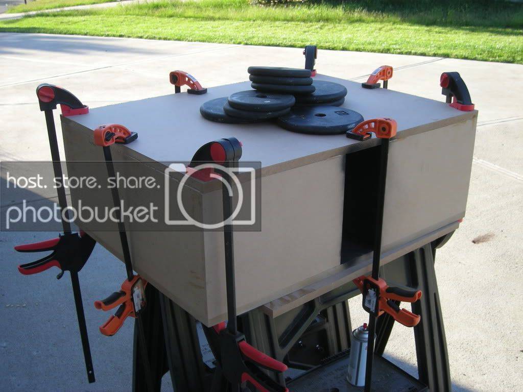

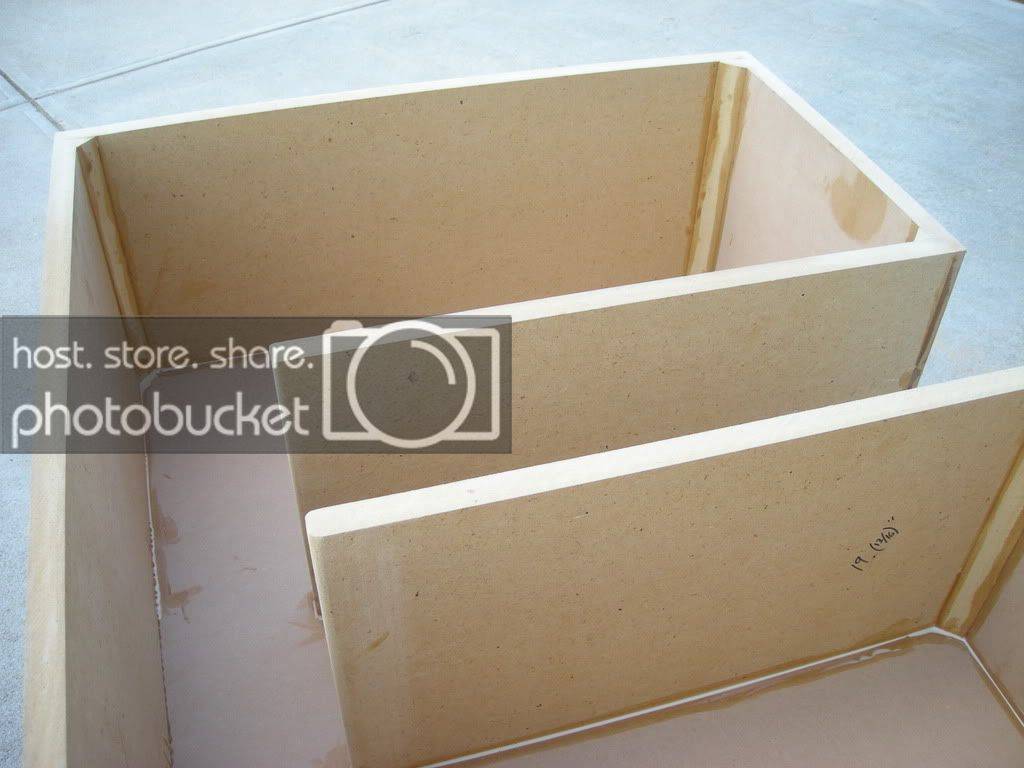

Putting on remaining 45 degree inserts in corners...

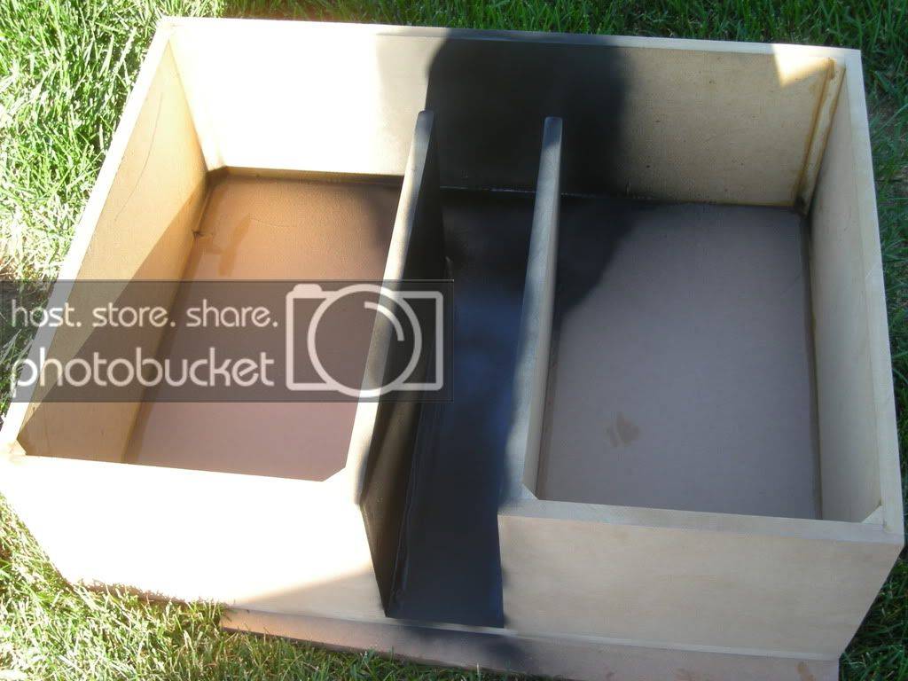

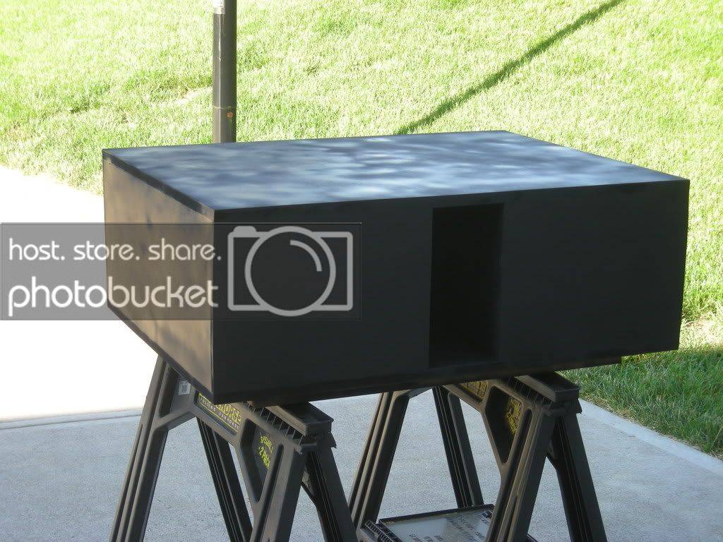

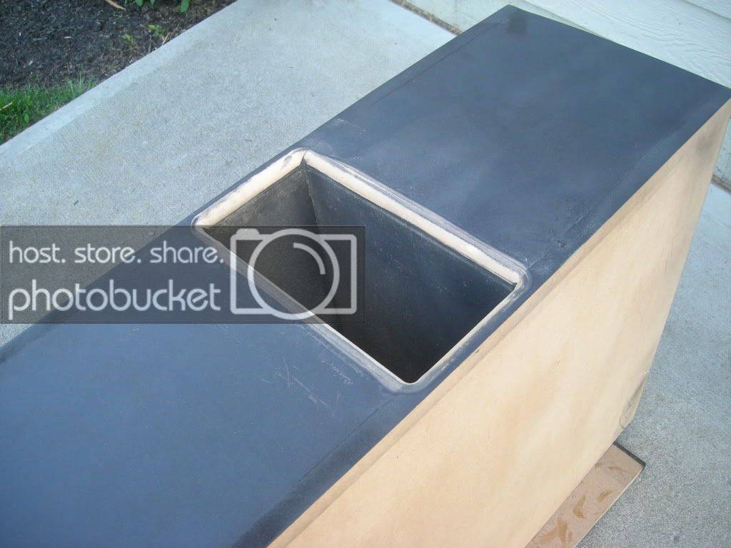

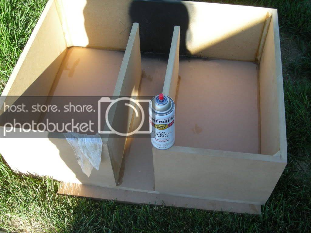

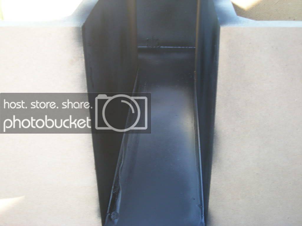

Wiped port clean with damp paper towel and painted black...
Now its the top's turn..

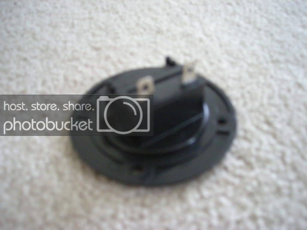

Shop tried to pawn this cup terminal off on me for the enclosure...had to take it back, was obviously used in a previous box, had mdf dust all over it and the terminals had been cut up and pulled apart..

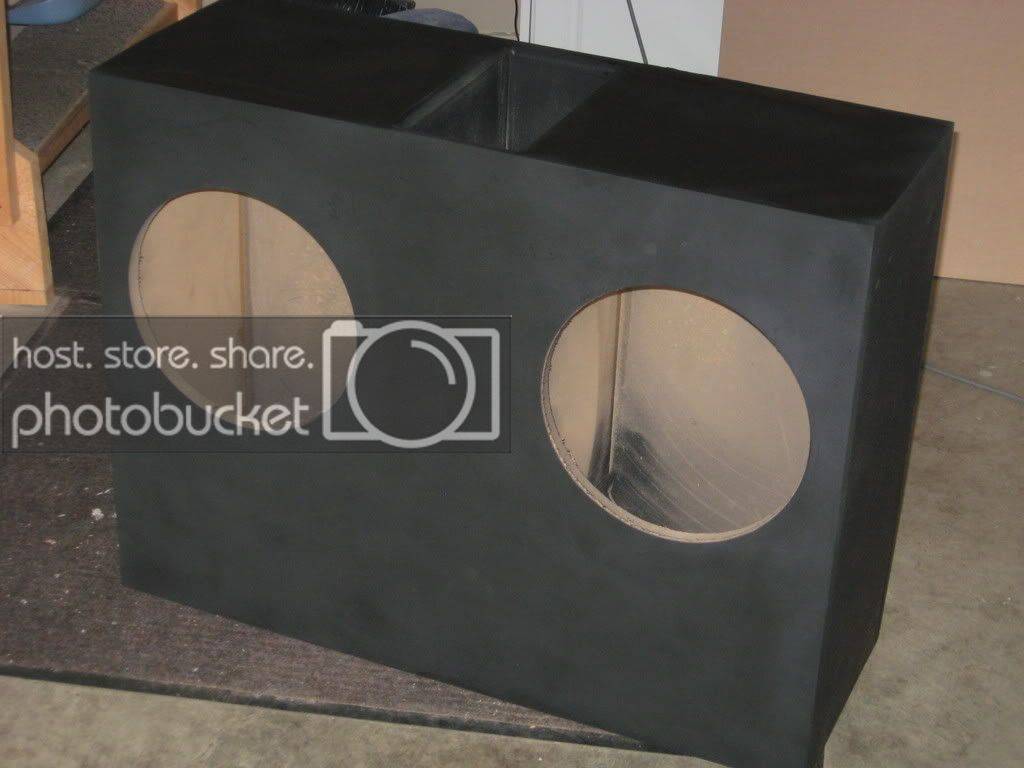

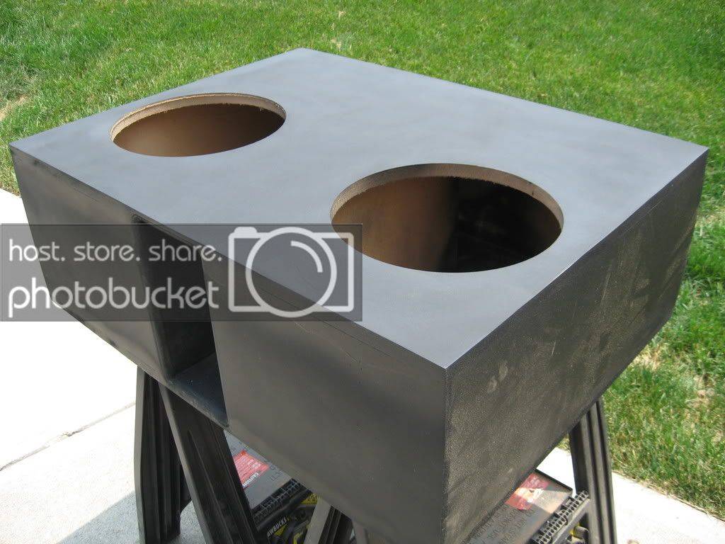

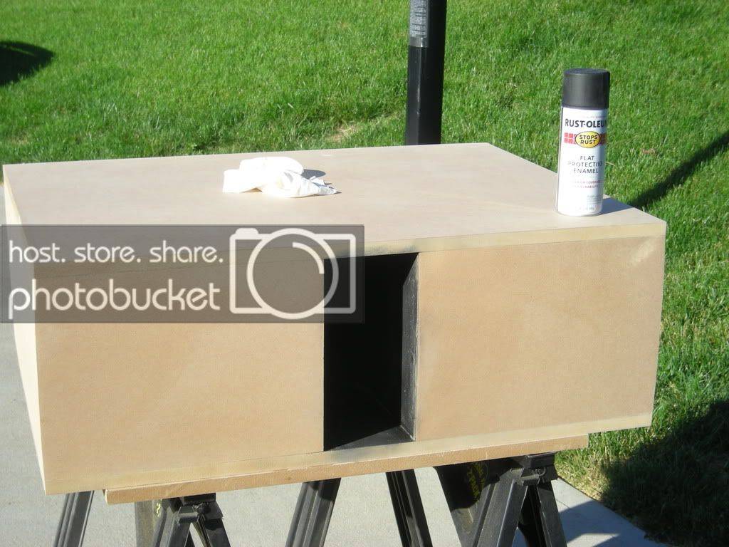

Outside paint..
Looks horrible i kno, still drying...

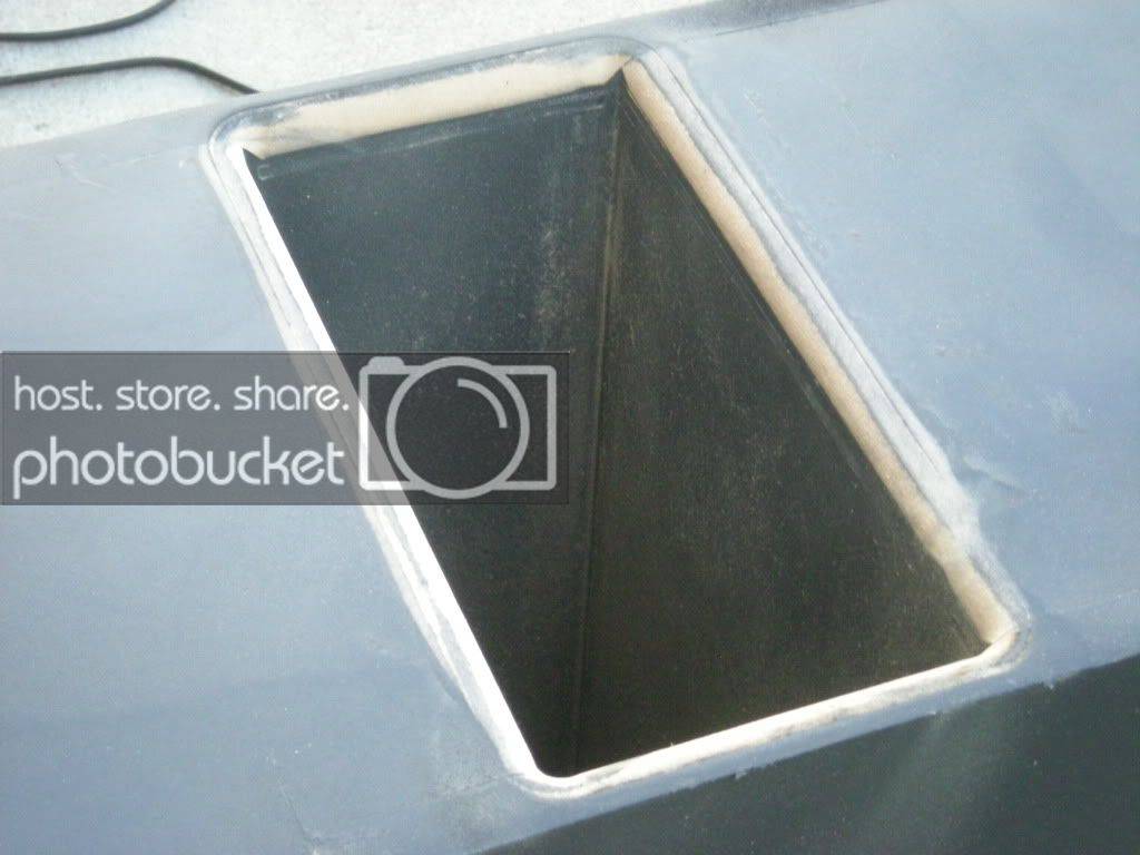

Rounded over the port opening with round-over bit on router...a friend have me a hand here since i didnt have one //content.invisioncic.com/y282845/emoticons/biggrin.gif.d71a5d36fcbab170f2364c9f2e3946cb.gif..
Paint came out a bit better after light sanding and another coat...shouldve primered it really, o well...and i had to sand down parts of the port opening...my friend's kinduva noob when it came to that, haha..

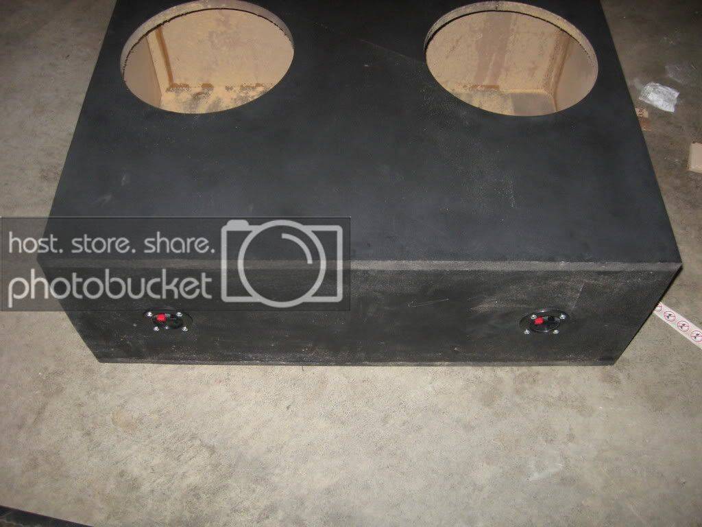

Still dirty, but here are the cup terminals...

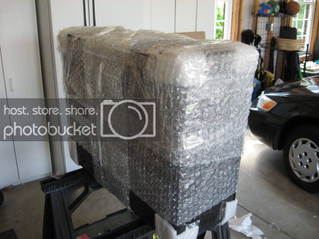

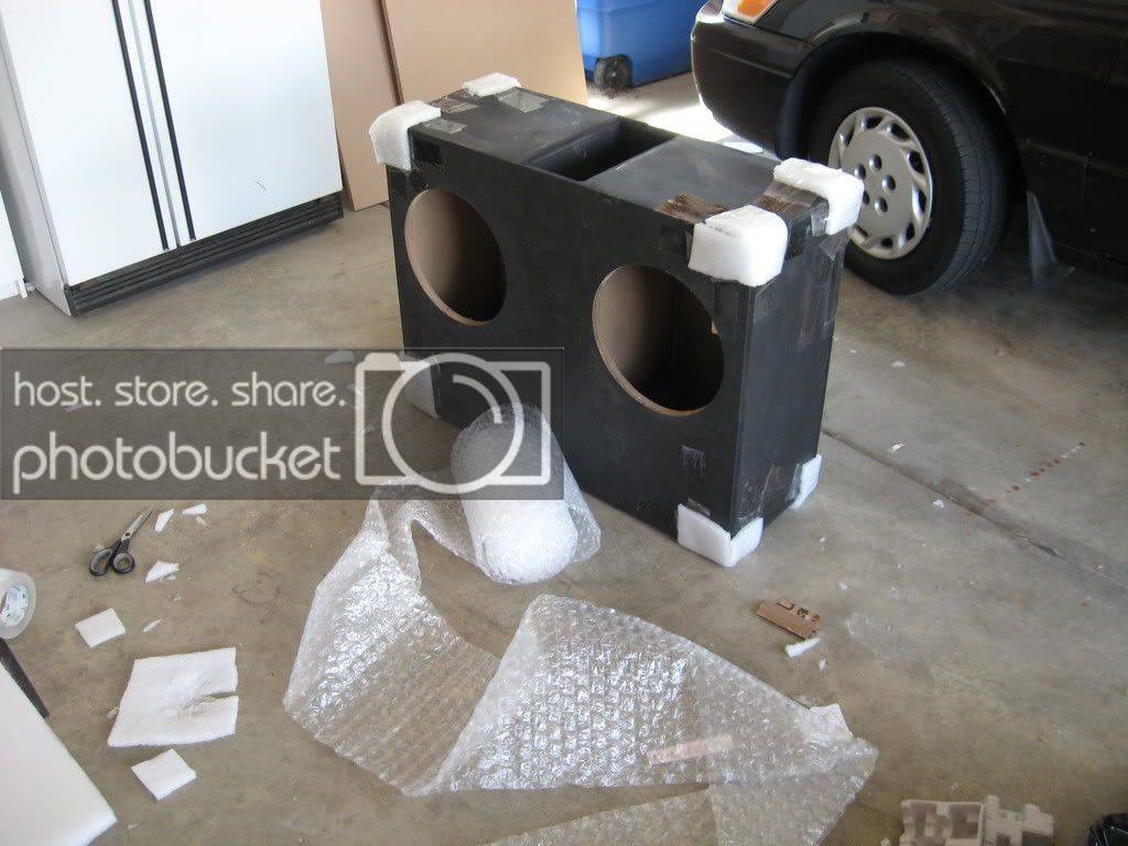

Getting ready for shipping to texas (from ohio..haha)...
^there was plenty more ontop of that, just no pic..
And the hand is healing up a bit, ya //content.invisioncic.com/y282845/emoticons/biggrin.gif.d71a5d36fcbab170f2364c9f2e3946cb.gif
And that's that
yea..when it comes to painting ive got work to do...I should have atleast grabbed my body filler and slathered that on there and sanded smooth...wouldve turned out better....but I shipped it to texas for next to nothing...i barely made any money off of this, haha
