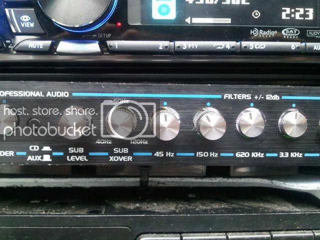

as you guys can see on my EQ - the sub level, sub x over, and the 45 hz knobs are the ones that control the sub stage mainly frequenzy wise. I have the sub level and the sub x over knobs set already, but for some reason i wasnt paying attention to the 45 hz knob and all of a suddent i deside to turn it up, little did i know the subs starting moving like crazy with minimum gains on the amp no bass boost. I was like wtf?? it cant be that? I had it halflway on the dot as u see it on the pic all the time... Just want to know wat frequenzys that knob mainly controls, cuz i dont trust it being almost all the way up. But yeah for the most part having that knob almost all the way up is moving the subs fine and everything seems to be working normal.
