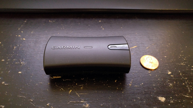

I have the Kenwood eXcelon DMX706S and it can be used with Android Auto when and only when wired to my phone (no wireless AA on this unit). I use it all day long as I am a delivery driver. Here are the issues and the questions. I have a Garmin stand alone GPS (Connects to satellites every time even on cloudy days but does not find all roads or addresses about 20% of the time - annoying) The I use my LG G5 mounted on the dash securely and connected to my 706S via USB (Finds every road 99% of the time but take a while to connect to satellites and loses satellites easily) but when it is connected it is PERFECT.
My questions are, if I get something like the Garmin GLO satellite receiver and connect it to my phone via bluetooth and then my phone to my head unit via the usb... will this solve my satellite reception issue? Will it even work this way? I know the phone connects to the head unit via blutooth so I can use Google Assistant while driving... which I do as well and LG says up to two devices can be connected to the phone at the same time via bluetooth. Any thoughts or experience?
I ordered the Garmin Glo after doing some research. Things needed, The Garmin Glo, My Cell Phone, An app for the phone. From my research I will download the Bluetooth GPS app. Then in developer options in the phone, enable Mock Location - Bluetooth GPS App. Connect the Garmin via BT to the Cell Phone, Open the BT app in the phone, adjust a few settings and the phone will now use the Garmin for its GPS signal. Now plug the phone into the Kenwood via the USB cable and Android Auto will turn on and I should now have a reliable GPS signal. 🤞
Will update after the Garmin gets here.
I spent the last 2 hours using the Garmin GLO satellite receiver. I started by opening the app on my phone that shows how many satellites I am connected to. I did this at my desk, in my room. It showed I was connected to NO satellites with my phone, in my room, at my desk. I paired the Garmin GLO to the phone via BT, did the necessary settings and enabled the Garmin in my phone. In less than two seconds I got 4 satellites and in 5 seconds total, 11 satellites in the green, in my room, at my desk.
Off to Walmart. Got some outdoor peal and stick hook and loop fastener from Velcro. Trimmed it and stuck it to the dash then mounted the GLO. Hooked everything up as needed and selected an address on my Android Auto head unit. Off I went. Almost instantaneously the round position marker on the screen turned to an arrow as I began to drive. This is a good thing. I canceled the navigation then said "Ok Google" and the head unit responded appropriately. I said "Navigate to Publix" it confirmed and began the navigation.
I tried several different addresses and not one address had any issues with GPS navigation, no pauses, no reacquiring, nothing negative period. The real test comes tomorrow at work which is where I use my GPS. Not bad results for something smaller than the palm of my hand.

I have been using the Garmin Glo for several days now. There have been no issues connecting to satellites. Turn by turn is right on and happens when it is supposed to happen. Android Auto on the other hand is not the most stable app out there. Many times when I start the car, Android Auto will not start up. I will get an error saying "Device Not Supported" Annoying. When it works it works great.
I also did some research, though limited, on the Galileo EU Satellites and being able to access them legally in the U.S. There is apparently a lot of red tape involved with that between Europe and the United States. So just because some of our phones in the U.S. may be able to use the Galileo Sat's doesn't mean they are. Also, my "old phone" uses GPS and a-GPS and still can't touch my stand alone receiver.
